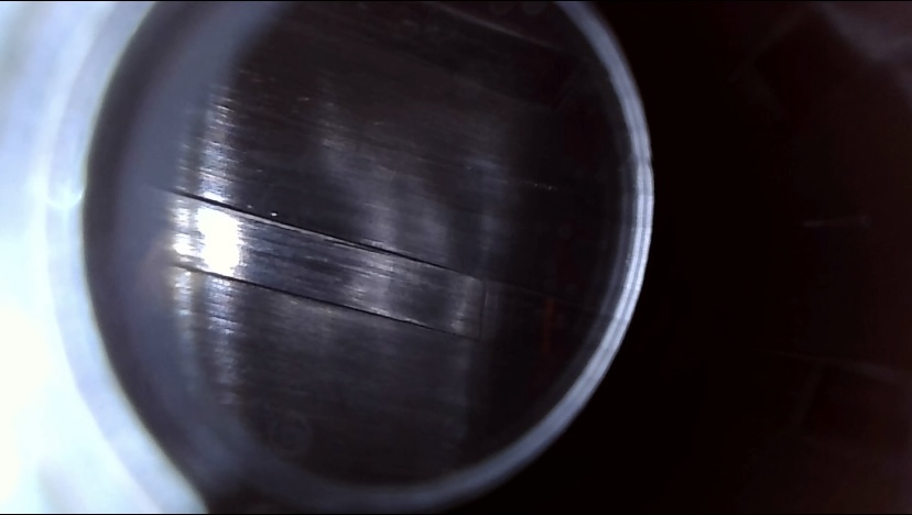

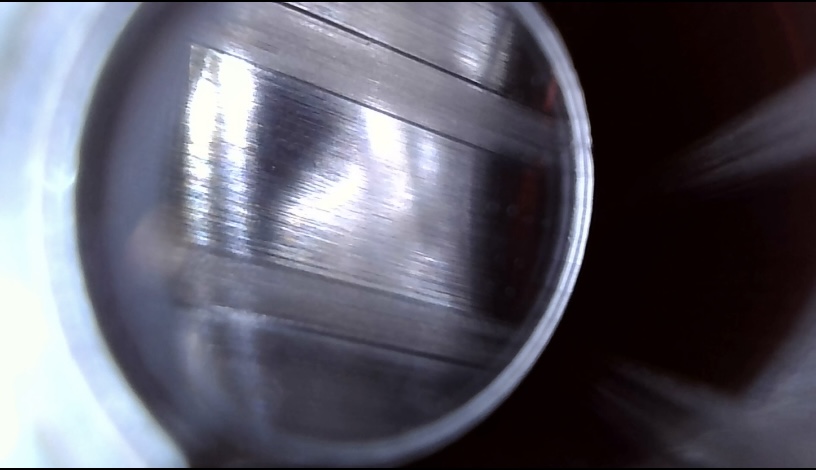

Barrel came lapped from the manufacturer. They test fired 4 shots for a .35moa group. Photos below show cleaning after those 4 shots. Method was 2 rounds of soak and clean with wipe-out.
2/3 down the barrel (8 inches from the muzzle) Shiny clean - no copper
1/3 down (8 inches from the chamber) no copper, but a thin layer of carbon.
If I want the whole barrel shiny, I’ll need iosso, which I’d normally use every 50-100 rounds, not 8 times for 20 rounds. Seems like a lot.
Very nice lapping. Very important to completely remove the copper during break in, but not barrel carbon/burn discoloration. You will not damage the barrel with Iosso.
That barrel is plenty clean. The point is to just not have a bunch of buildup or deposits so the bullets can fire lap it.

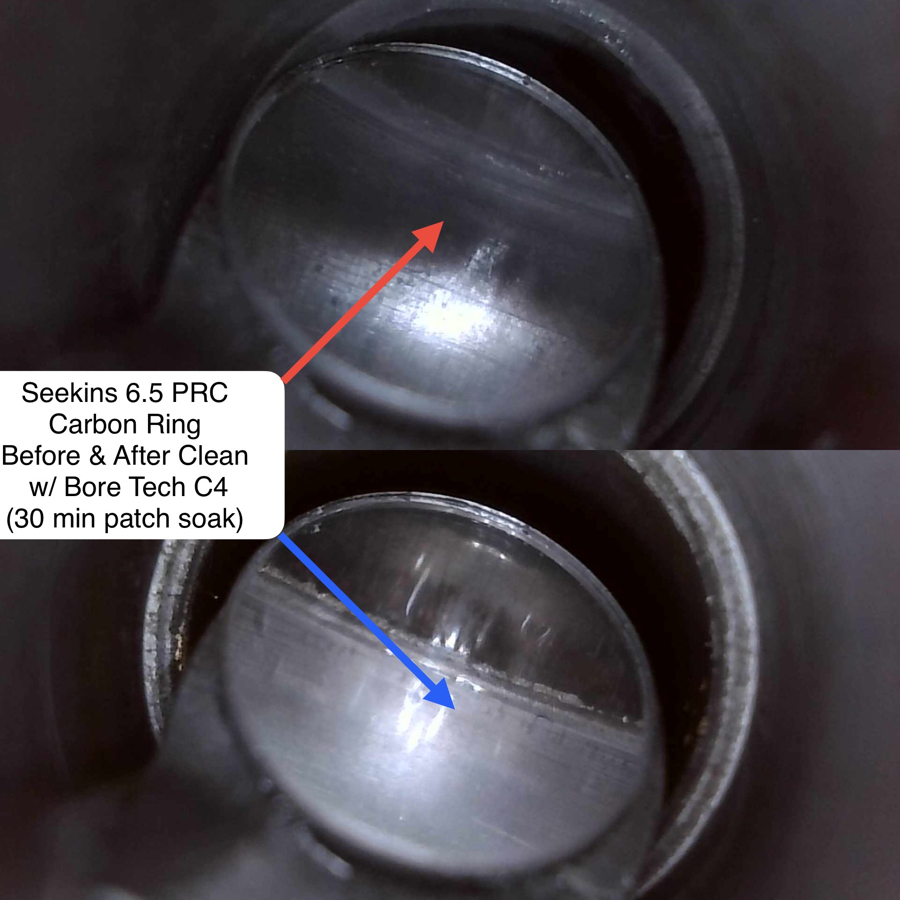

The problem that has me cleaning a lot more than I used to, is the damn carbon ring.
