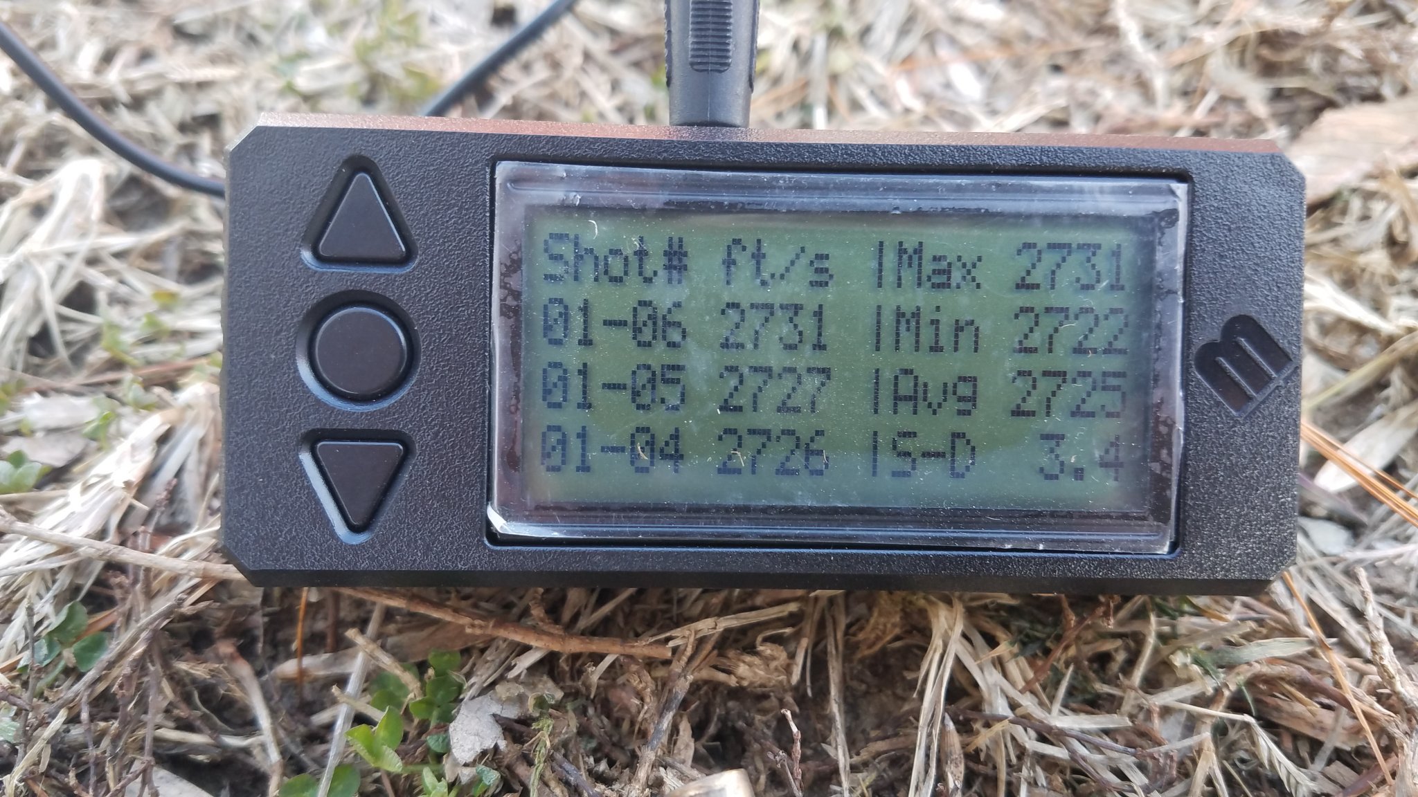

20" proof aiat. I thought id need the lighter bullets, but then I said "hold my beer". 147eldm (.697) at 2725 work pretty dang good, 8.1 drop and 1.6 drift in 10mph fv at 1k.
