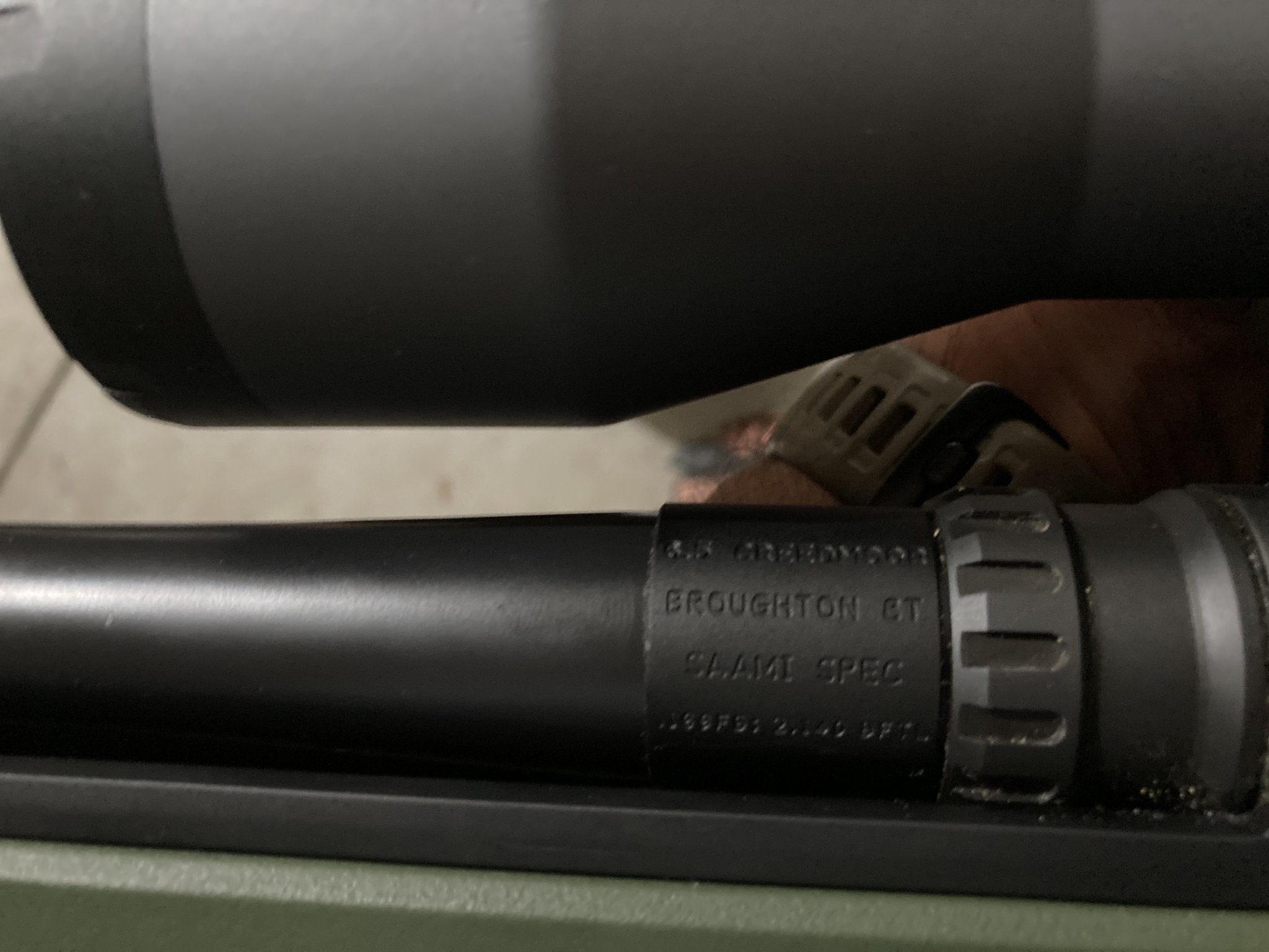

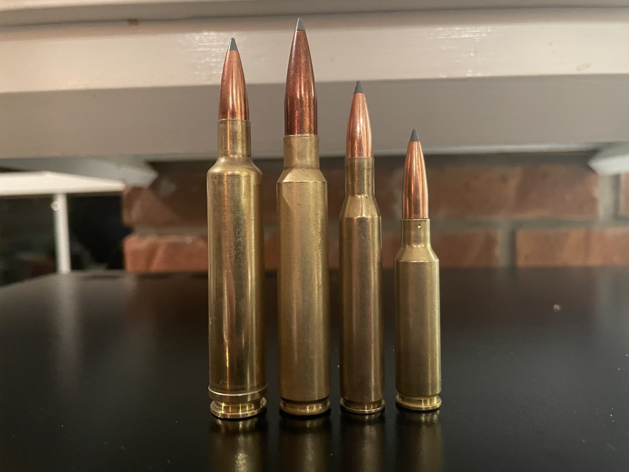

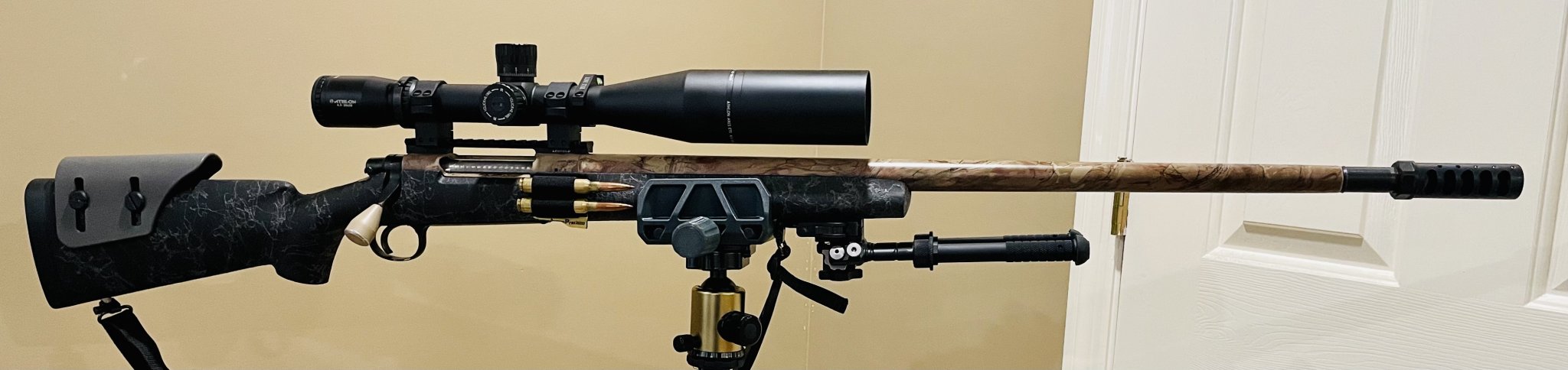

25 to 30 years ago I would have said Douglas or Shilen as I had a couple of customs built in the 90s with them that shot lights out. They are still great barrels IMHO.
Today I think Krieger is probably the top of the tier 1s with Bartlein right there as well. I have a bartlein on a 338 that shoots half moa or less consistently. I shot the tightest group of my life with it this past winter, a .029 5 shot group at a hundred running 265ABLRs over IMR4350. Inside 1250 yards it is literally a point dial and shoot gun. It goes ding on one to half moa targets every time with boring regularity. I have had several Krieger barrels as well and they have all been good, no complaints. I have only owned the one Bartlein that is why I would give the nod to Krieger as they have a more storied history at this point.
