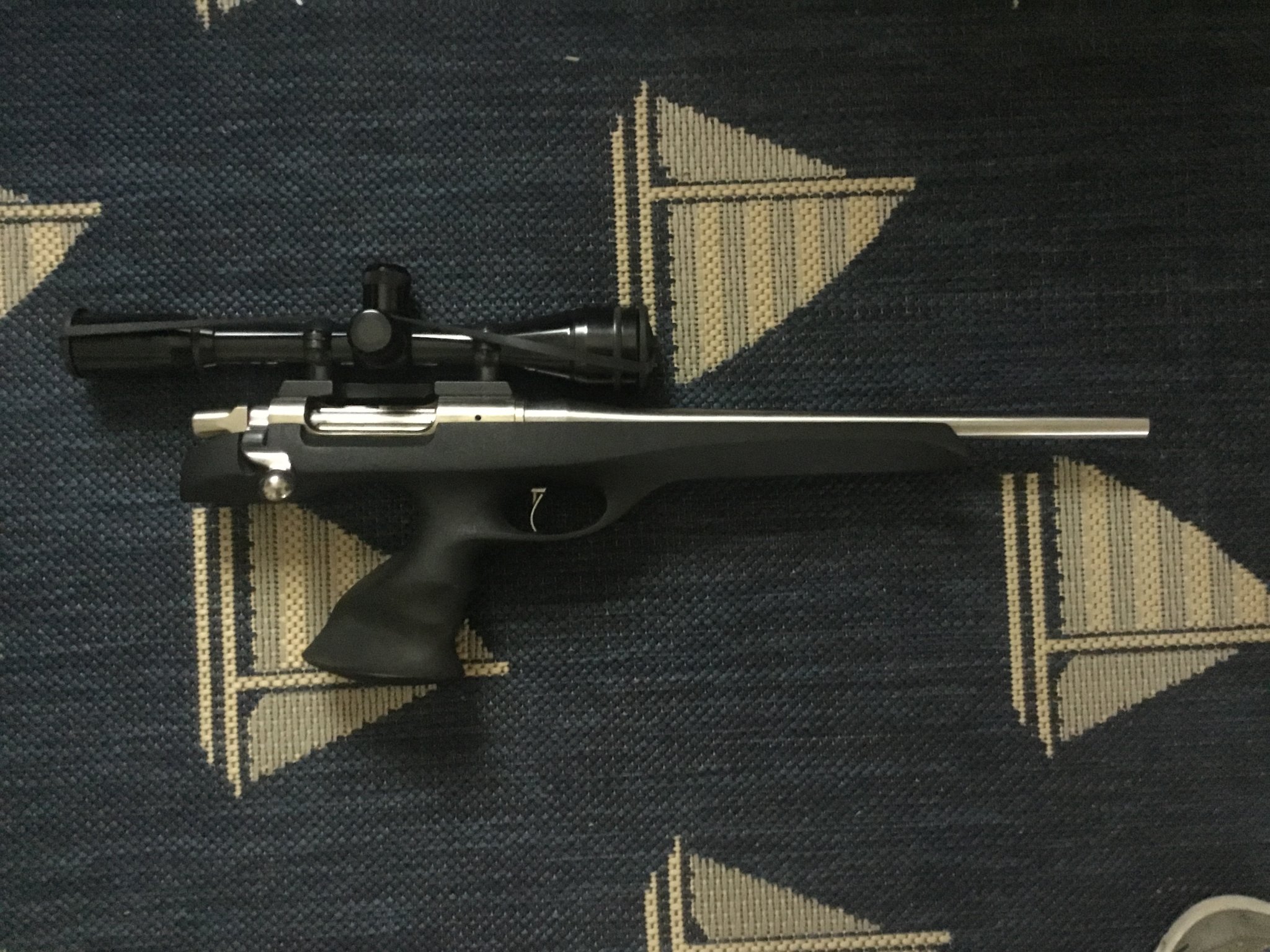

This little gun sports a Shilen. I cant even guess how many rounds have been though it. But since in my day, I shot over 5000 rounds per year, a good many of those practicing with this handgun, I would hazard a guess that this handgun has at least 10,000 rounds through it.
Since i broke my hand in 2018 and my back in 2017 and turned 74 a couple months ago, I simply can’t shoot IHMSA competitively anymore, so it does not get shot often anymore. Still, in 2021, it put three shots into an inch at 200 meters shooting Creedmoor style

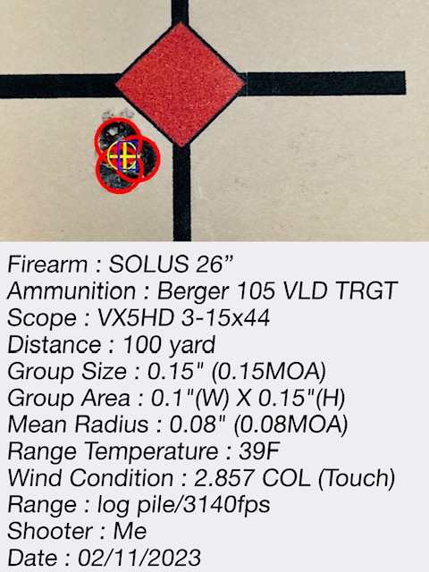

My Criterion is insane precision so far. Only 50rnds on it, but good lawrt its a sweet shooter. Never had a Savage not shoot great. Just found two new factory take offs for $200! Got some Benchmarks enroute too.

My Criterion is picking up a little more copper than I'd like to see from a double hand lapped premium, but I am not gonna whine too much with it shooting 1/8" MOA! LOL I also have a few more enroute! :D😻

Oh now you gong get it! Here is load development so far: My bad 1/8th is .125" I was thinking 1/4 at .250" I do believe there is an eighth in there though.
Why do you not measure all of the groups with the software app?
The improvement in accurately measuring groups compared to manual/edge to edge/ calibers is substantial.
