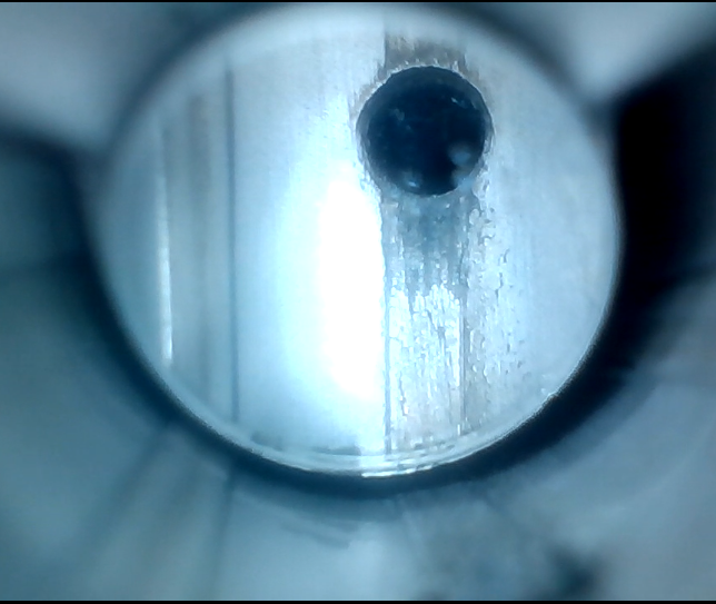

    Barrel before cleaning;

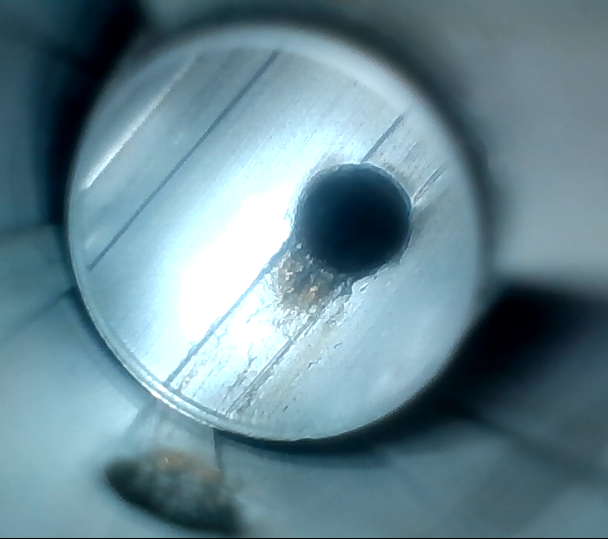

    Barrel after cleaning it briefly with CRC carbon cleaner.
    Gonna be the odd man out here , to me that looks like chrome flaking off to , not copper . If that is the case there is nothing that can be done to reverse it .
    Yes, where the chrome is flaking the copper replaces it. Not sure how long the chrome should last in there but I am not surprised it is coming off by small amounts.
    I've seen chrome lined barrels with 10k plus rounds down them that don't look that bad .
    Could be a few things either there are way more rounds down it than the guy told you , crappy barrel , or possibly corrosive ammo since there are pits in the chamber also .
    Anyway you look at it the barrel is toast and the accuracy will go away as the chrome flakes and damages the bullet jackets .

    To update this saga to anyone interested, I checked the barrel and there are clearly chrome pieces missing from the barrel.

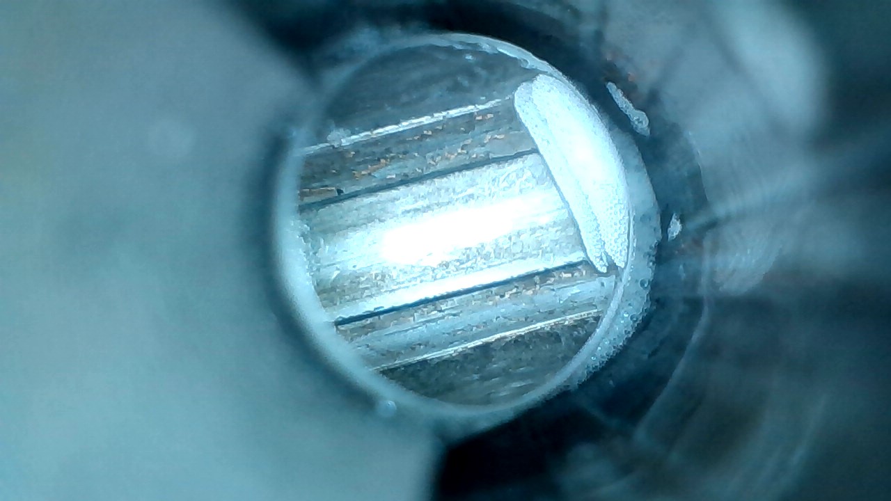

    To make a proper end to this, here is the barrel after 1k rounds pretty much uncleaned. Not specifically 1000 rounds, but slightly under or over.
    It seems the extra copper finds its way out on its own, as I find it sometimes in the muzzlebreak as blue goo.
    I have not recently shot any match loads through it, so cannot say very much for its accuracy, but it seems to do 5 shot targets with S&B made Topshot bulk from 1moa to almost 3 moa, mostly 1.5moa. I also have problem with sometimes letting a shot 'loose' as in not really focusing to the end, which make up most of the 3 moa groups. This is because I try to also focus on the reticle to spot how it moves.. To learn where I lack support for the rifle.
    My cleaning for the barrel has not included any copper removal. I have used CRC carbon cleaning agent not made for guns for maybe 4 times overall, it is very lousy stuff when tested on the muzzlebreak versus even Boretech Eliminator, but I have not really spotted carbon at all in the barrel either. I have not seen any black on the patches while cleaning the barrel with the solvent, just greyish. So not much carbon at all.
    It seems the barrel firecracking has gone forward a little, I am not certain yet and will have to check it by comparing to the previous vid.
    0:33 Begin of lands - 1:50 Gas Port - 2:40 Crown (one land has a nick and another land is missing the crown part completely)
    I decided to compare gas ports as it is easily identified and found.
    1.5K total ammo through:

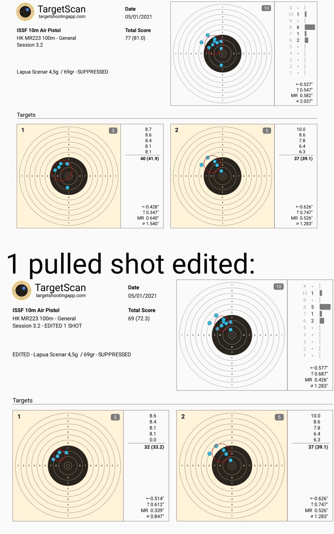

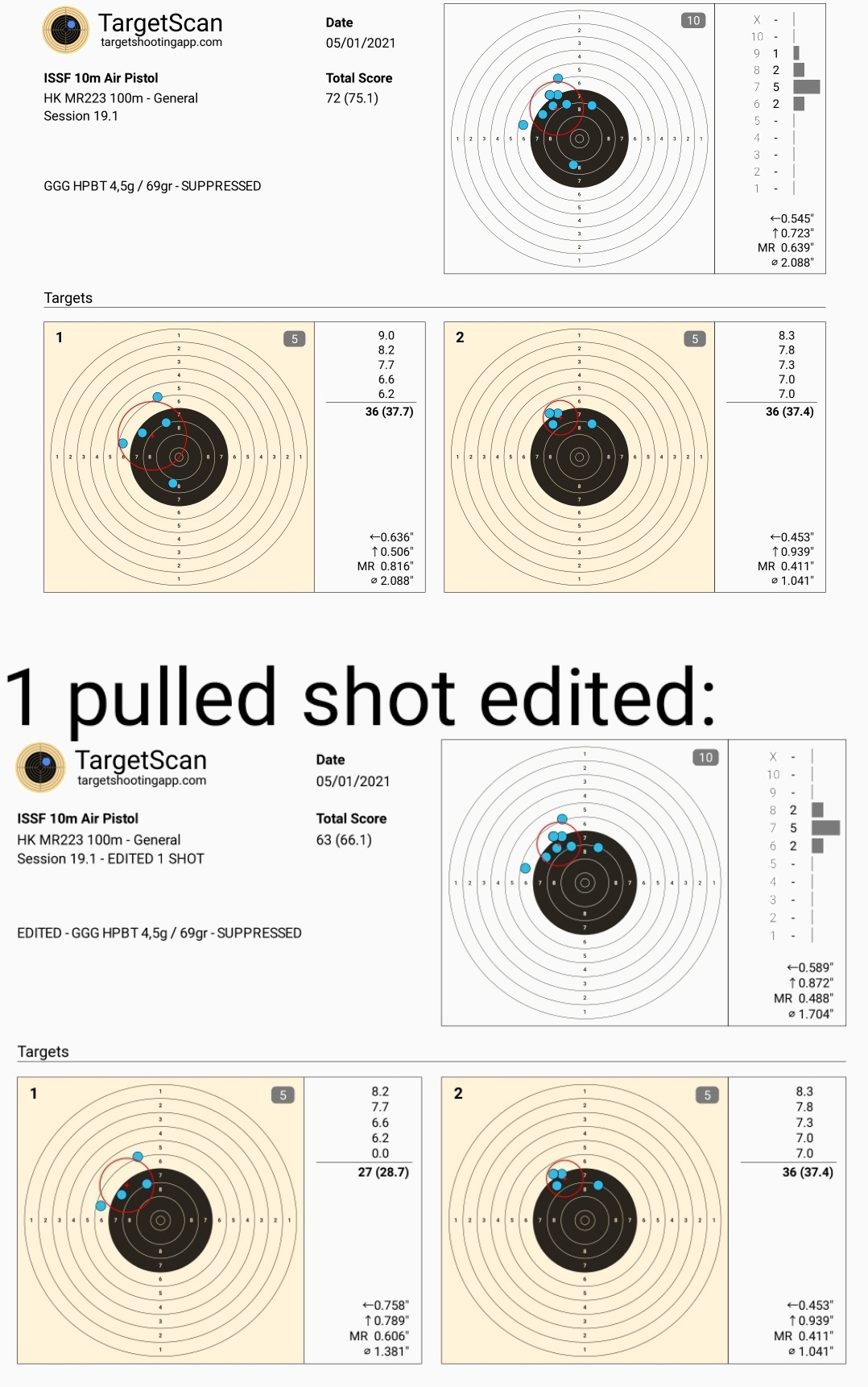

    With all of above going on with the barrel, and me shooting, barrel was still delivering almost 1moa 10 round group (1moa=1.18" at 100m) with Lapua Scenar with cold bore shot included and OK with GGG SMK factory loads, I felt too confident after Scenars and started blasting GGG SMK which got me the horizontal hits.
    I cannot help myself with the pulled shots. I hope to get rid of them and I'm attending training soon.
    LAPUA:
    GGG:
