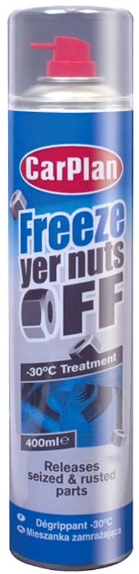

    For anyone with a stuck barrel reading this in the future:
    Liberal application of heat gun to followed by a shot of this (or similar) up inside the chamber and your barrel should just about unscrew by hand.
    haha that's a new one to me. I'm a big fan of PB blaster. Gonna have to try freezing my nuts sometime soon!
    The general principal is to expand the action and shrink the barrel.
    The freeze your nuts off sounds like the best solution. Heating the action will swell it slightly and the freezing of the inner area of the barrel will slightly shrink it. The only good I ever got out of my physics class was putting in bearing on my tractor by freezing them. The damn things wouldn’t go in place until I froze them and then they slipped right in. I’m gonna give your method a try next time. Thanks
    USA availability?
