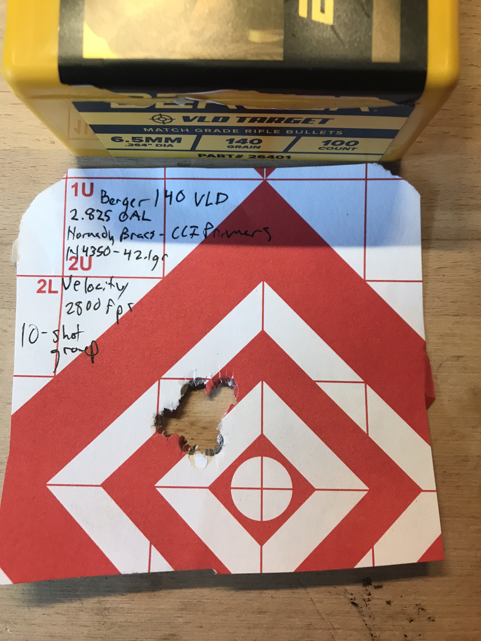

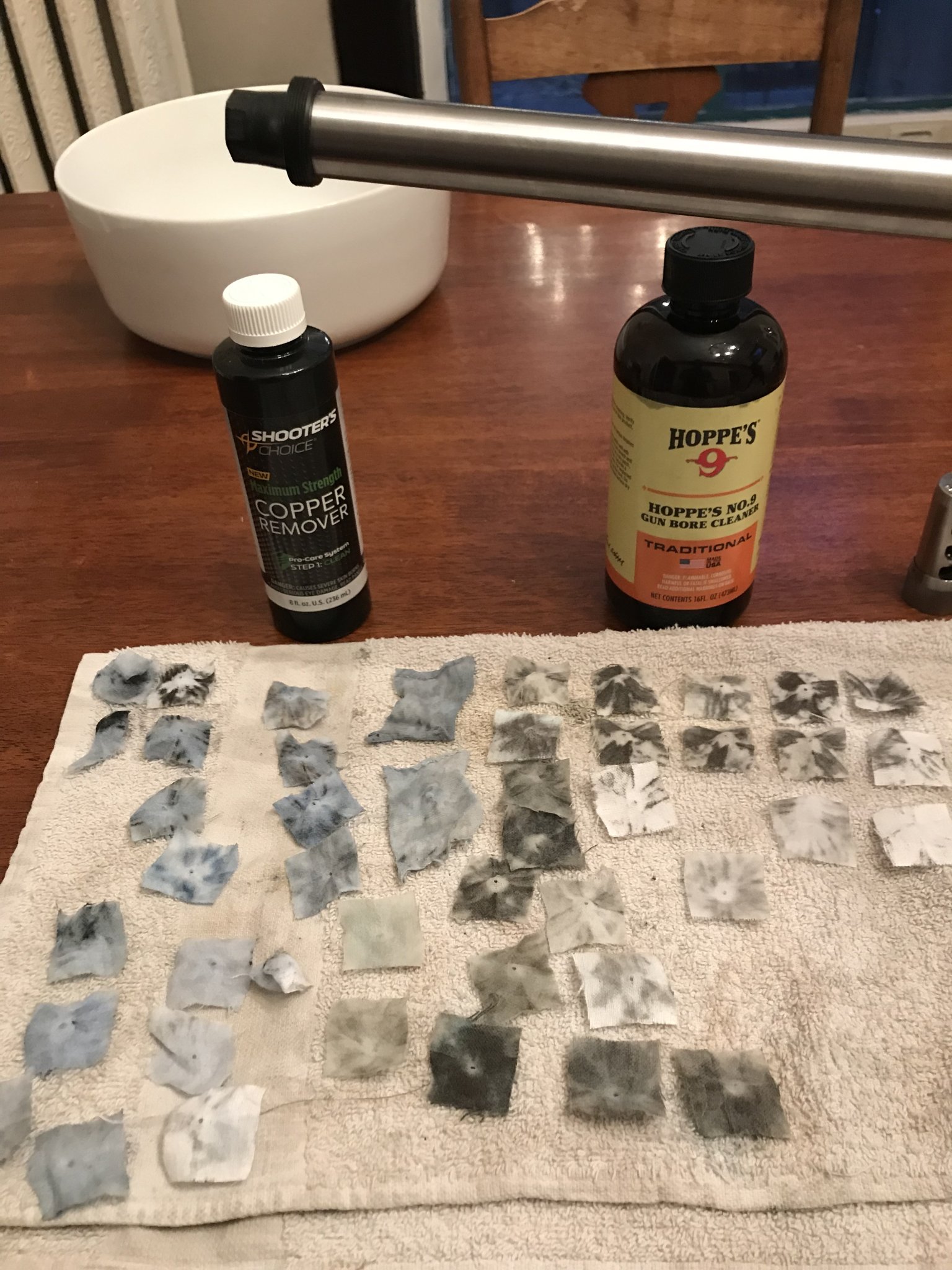

    I have about 12-1300rds through my 6.5 criterion barrel. I just cleaned it thoroughly, pic of what came out, and I’m usually at 2815-2825fps but 80rds post deep clean, I ran my barrel over the labradar and I’m getting consistent 2850-2860fps. I haven’t changed anything. And it still groups 1/2minute

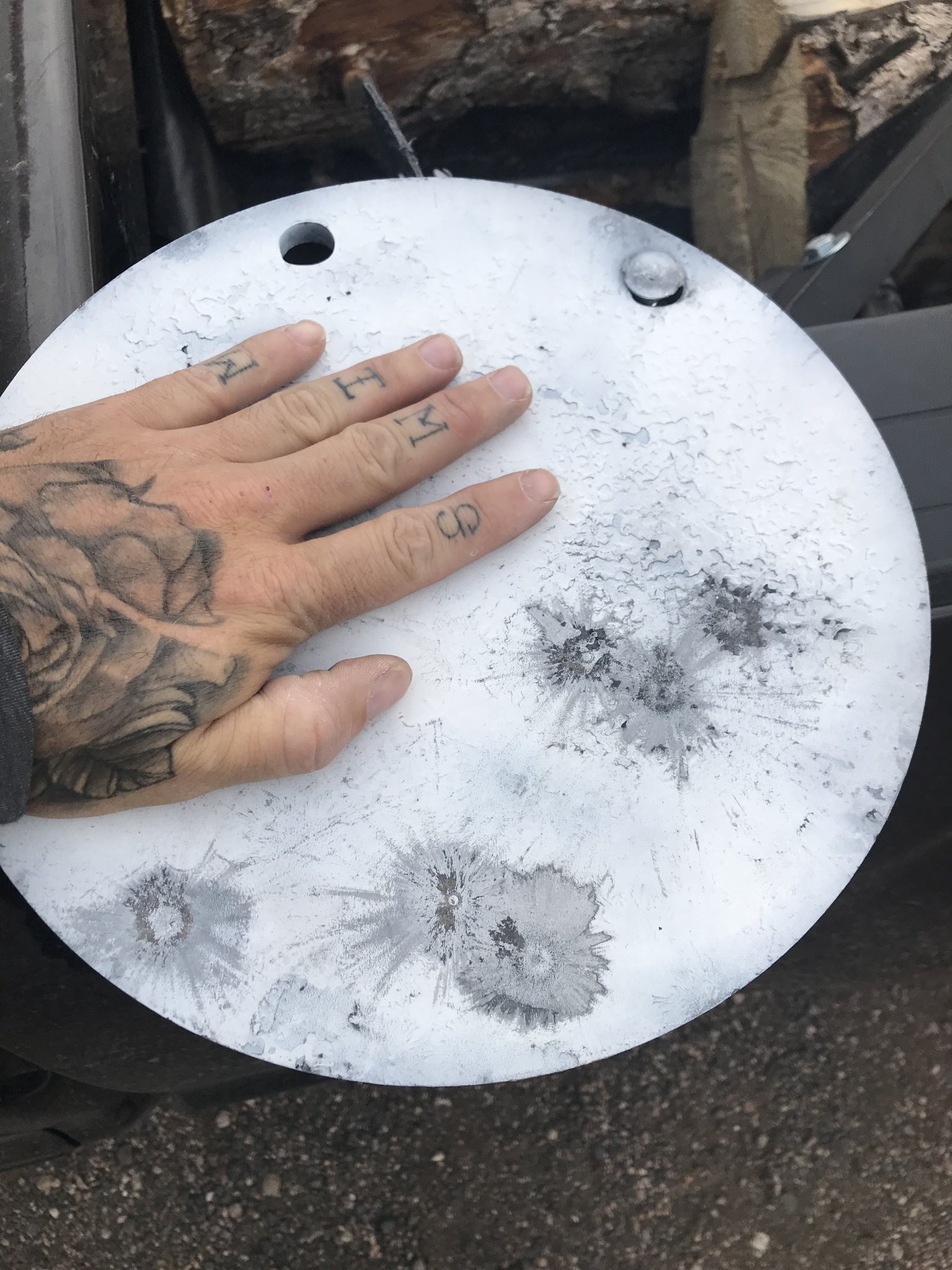

    Verified at 800yds and my buddy’s group is bottom, and mine is to the right. We had some considerable winds last night

    Pretty common for a barrel to speed up but that’s usually between 200-500 rounds depending on type of barrel and quality.
    Velocity will be higher for several rounds on a clean/smooth bore so I suggest running another 10-20 rounds through it to foul it up fairly good and then re-chrono. If it’s still giving those speeds then it just took longer for yours to speed up.
    Reactions: Sam19kilo
    You might have missed a carbon ring. They’re subtle & insidious, but an unexplained velocity spike is the first visible sign. The next is a blown primer.
