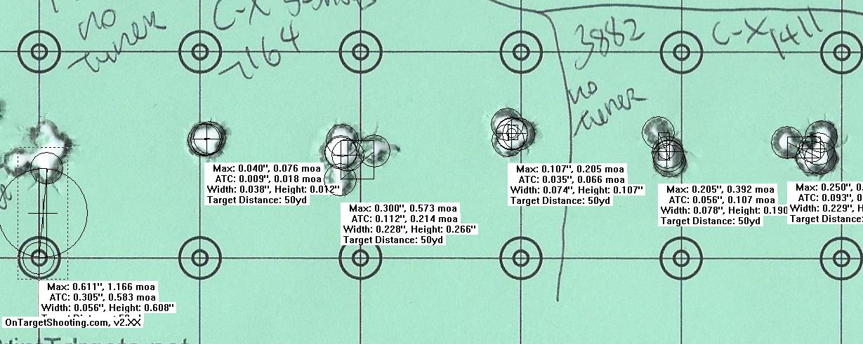

I suggest before investing in a tuner try a higher tier of ammo such as CX or even Midas+ though you are getting fairly decent results with SKRM it is not consistent enough to determine if the barrel would benefit from a tuner. if the barrel is capable, you will see it with the better ammo.
for example, this barrel shot with no tuner even with the center group being 0.300 ctc for the 3 5-shot groups it still averages 0.149 and if I count the other 2 groups shot with a different lot of CX it still averaged 0.180 ctc across 5 5 shot groups. I can tell you this barrel does benefit with a tuner on it.
