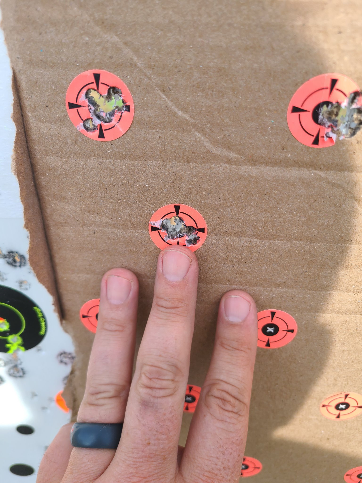

Probably know the answer to this, but hate junking a good barrel.
Have been shooting a lot the last few weeks and have really noticed my Bartlein M24 6BR barrel stringing vertically. Gun zeros perfect at 100yds and dope has been trued out to 1000 yds, hitting 600yd waterline for MV then 700, 800, 991yd waterlines for BC. Lapua brass, 29.8gr of Varget, berger 109s. Barrel has about 1500 rounds on it, but more in cooler months.
Shooting the last couple matches, several of which where smoking hot (Oklahoma last weekend was 100F+ with little shade). I am finding my barrel stringing vertically through a 10rd stage. For instance, 500 and 545yd stage with 10ea 10" circles from modified prone. Dead center on first, but shots 2-5 string perfectluly vertical and hit target hanger for final 5 shots.
Confirmed similar results out at 900 yds, approximately 0.4mil elevation change at 900yds. This was exaggerated but can be partly explained by mirage.
Plans this week are to heat test by:
1) confirm 0 at 100yds
2) rip off 10 rds at one paster, reload, 10 more at a second paster, and probably a 3rd mag at a 3rd.
Goal is to see if i get repeatable results and max vertical with a smoking hot barrel. Yes, i know this may be a bit hard on thr barrel but my barrels are consumables.
Im thinking I just got 'one of those barrels' because I have not seen this with any of my other Bartleins (not blaming by any means...sometimes you just get them). Any thoughts?

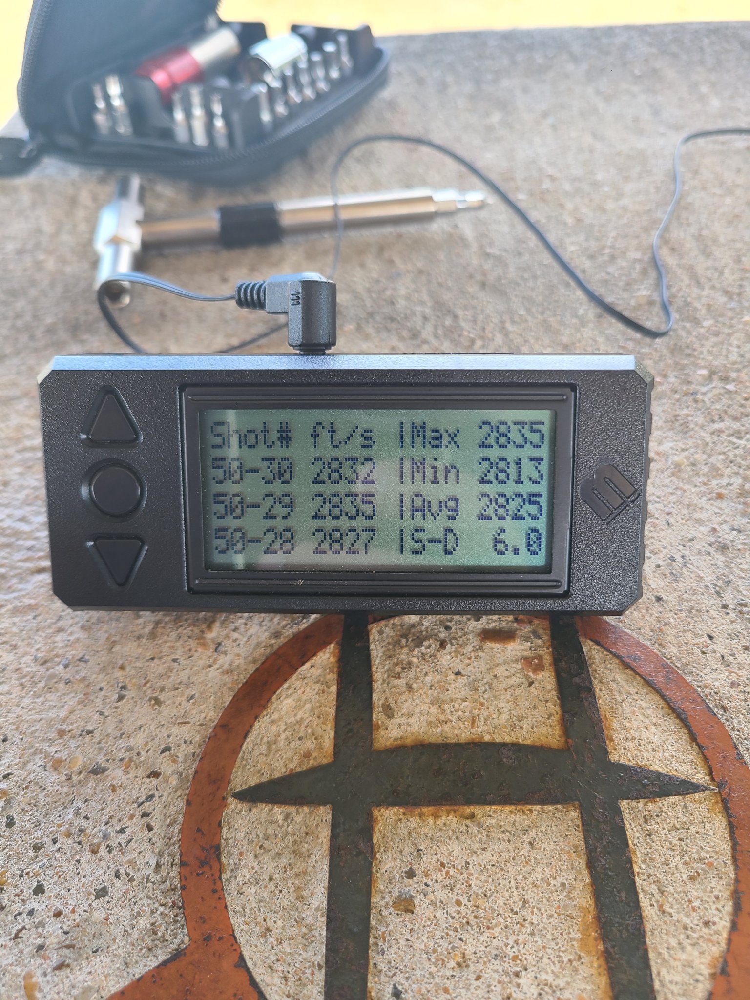

Guy at the range this past weekend was having a similar issue with his bartlein 6.5cm barrel. But he was using imr4350. He would shoot and chamber a round and let it sit chambered for a few minutes before firing and was experiencing a vertical stringing effect. He told me about the issue while I was waiting on my rifle to cool down and I suggested his ammo was getting heat soaked and to not chamber the round until he was ready to fire and it seemed to "fix" his stringing issue.
That being said, if you’re letting that ammo sit any more than a few seconds in the chamber after round 5, it's possible it's getting heat soaked causing the powder to heat up and velocity to increase. I would run the entire test over a chrono if you have one and see if the ammo is speeding up as the chamber gets hotter.
Spends very little time in chamber since I only close bolt once on target.
Between stages, i was using a wet towel and a chamber chiller to get barrel back cool. It would go back to the initial POI and repeat process.
Good point on chrono though.

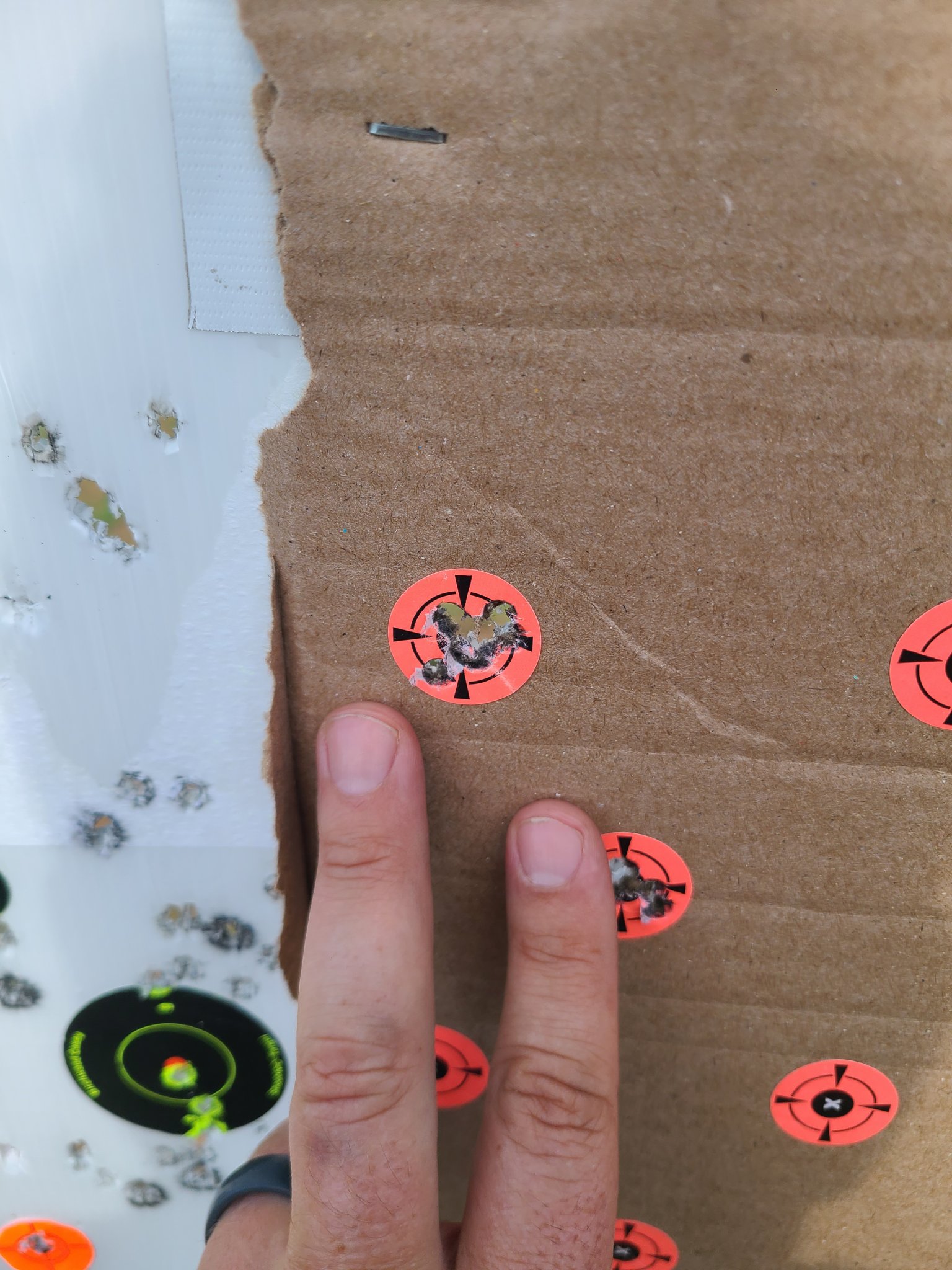

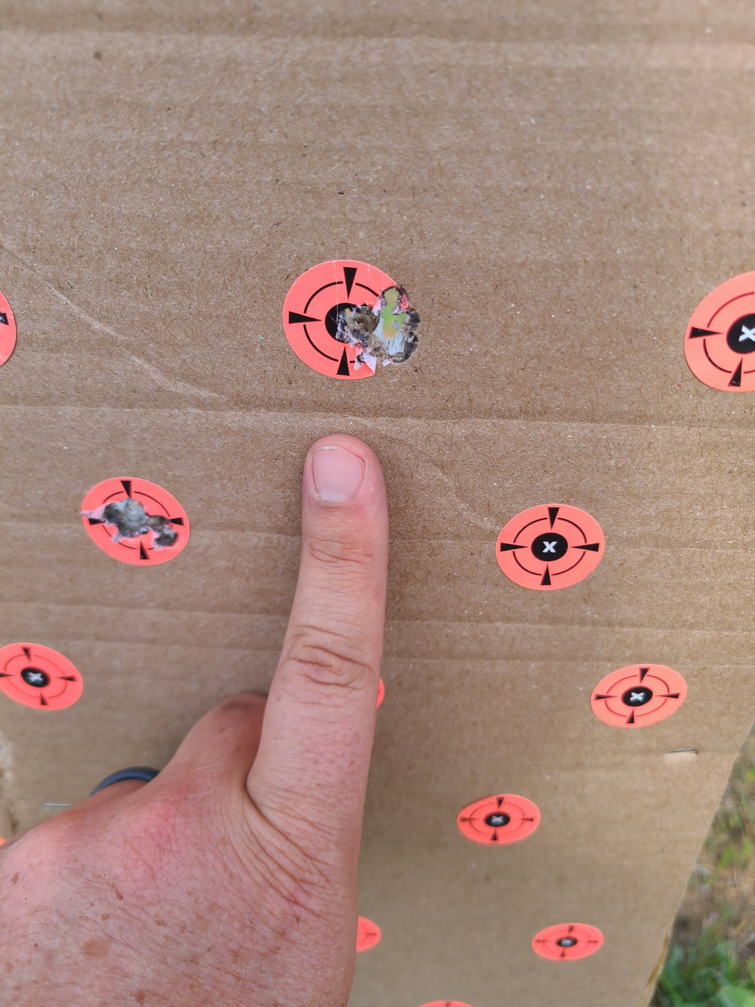

Impact. Not that i have noticed and even with this barrel I dont remember it doing this in the cooler weather. Even down here at Navasota, it hammered in June and July. I shot 97 and 98%.
I shot last Sunday at Navasota and shot at a square at 500yds and it drew a perfect vertical line across 10rds. The first time I noticed it was in New Mexico and King of Coal which was also hot...
And maybe it isnt the barrel, but i find it strange that if it was the load/seating depth that it would walk perfectly vertical. A load issue would be more likely a flier, not repeatable vertical stringing.
My guess is that this is happening because my barrel is timed to TDC by my smith (correctly so!) so the barrel is following its natual curvature. If it wasnt timed it would be going all over the place. This is what leads me to think its a barrel stress issue.
And for the record, I am not blaming anyone here regardless of the cause...unless its me. 🤣 I have multiple other similar barrels from the smith that all hammer without this quirk. I know sometimes these things happen.
I just want to know what is causing it and if it can be solved because I hate tossing a barrel that has probably another 1500 rounds to go (though I may never regain confidence in it again 😒)

3ea 10 shot groups shot back to back (30 straight shots) with no cooling at 100 yds. Repeated with same results. Think i have my answer
Reactions: Tnc and kthomas
What's the answer?
The simplest one...the guy behind the barrel. Mechanics must have not been on point and got in my head.
1) definitely not ammo heating up. 1st 30rd group had an SD of 6 and the second had an SD of 5.
2) Wouldnt say in any of those groups that there was an upward trend with heat. Barrel was so hot after 30rds that i couldnt touch it.
