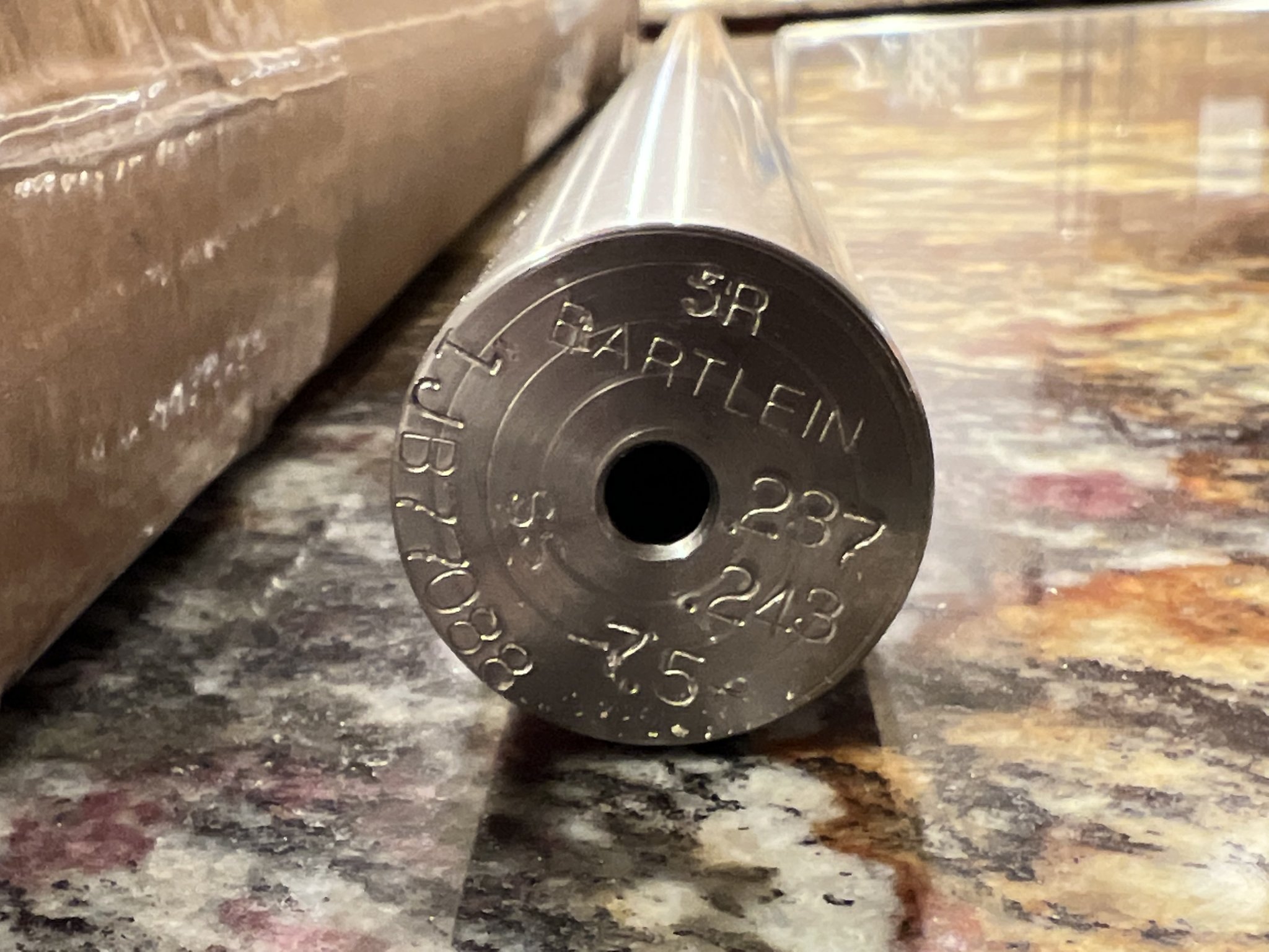

Just got my tracking info today. Order was placed first thing in the new year:
  • 400 MODBB steel
  • 6.5mm blank
  • 1:8.5-7.5 LHGT
  • 28” finish length
Plan is to kick it to LRI for chambering in 6.5 Creedmoor to replace my burned-out Proof barrel (~1800rd with frequent strings of 10+ rounds). I’ll need to decide whether to go for Murder Hornet or Pattern X…
