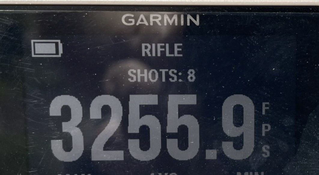

Well my 257 Roy is finally done. Should be a decent test. 127 hunter hammers running 3157 out of 22” barrel. But being it’s my wolf/coyote/deer gun I’ll probably never shoot it out no matter what lol.
