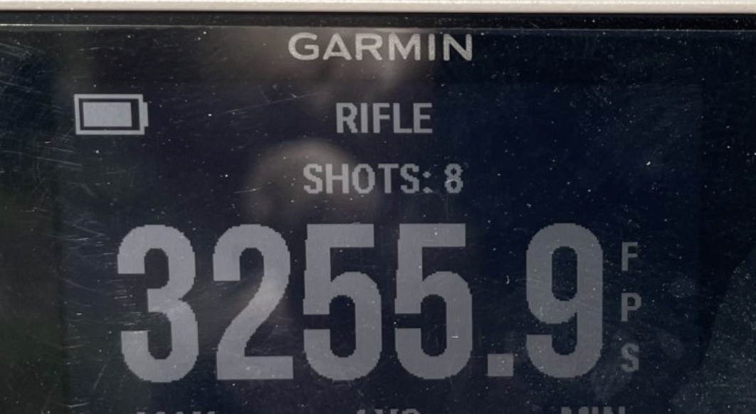

running in 28" barrels, 3150 gave me about 1k, but 2950 gives me 1500 before I have any problems.
this barrel I'm going to see if I can get a solid 2k rounds if I slow down to dasher speeds of like 2850ish if there's a node around there.
