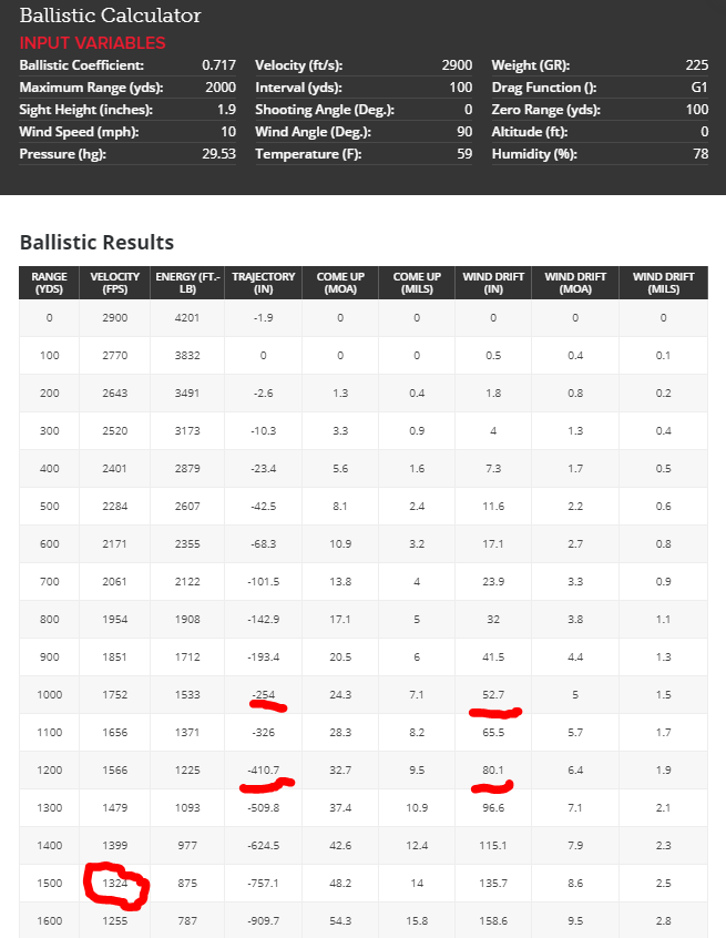

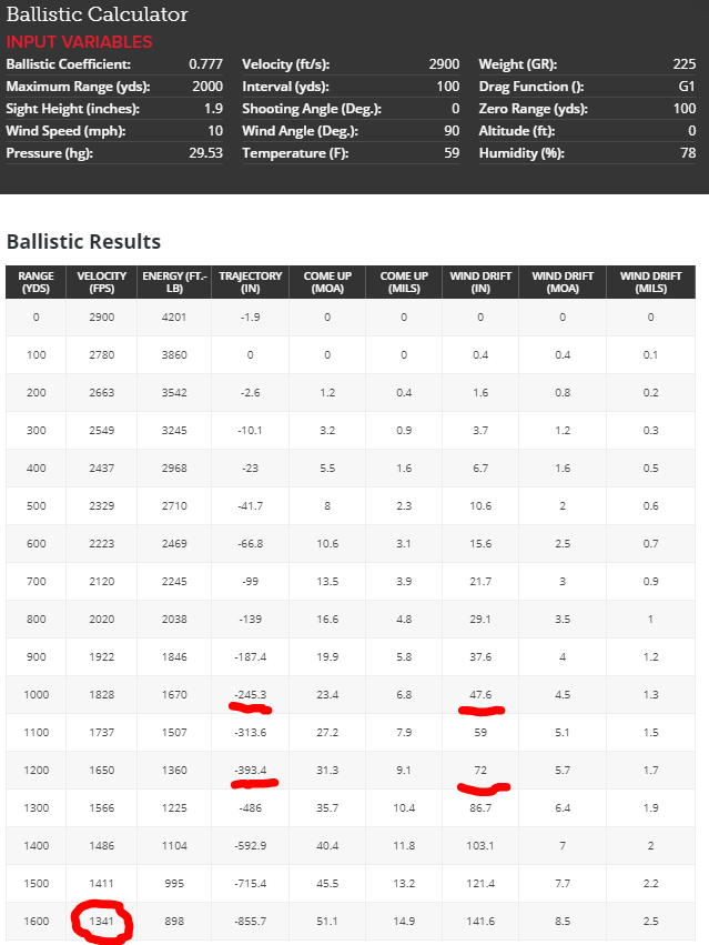

Let the numbers show you the way to go. Below are 2 charts from the online Hornady ballistic program.
MV = 2900 with 10MPH wind at 90 degrees
The first chart is G1 = .777
Turns tran-sonic around 1600yds.
1000 Yd - Drop 245" - Wind 47"
1200 Yd - Drop 393" - Wind 72"
The 2nd Chart is G1 = .717
Turns tran-sonic around 1500yds.
1000 Yd - Drop 254" - Wind 53"
1200 Yd - Drop 410" - Wind 80"
Remembering these are all Theoretical values.
You are only giving up 10" drop at 1000yds and 14" drop at 1200 yards to get a better shooting group. Drop is constant and predictable. I would not worry about this value. Dialing any extra 1 MOA or .2Mil on your scope is not a big deal.
Wind is 6" different at 1000 and 8" different at 1200 yards. This is 3/4 MOA or .2 Mil wind. This is equivalent to calling the wind speed to within 1 mph which is very difficult to do.
If your your groups sized at 100yards are 3/4 or 1/2 minute does not mean your groups at 1000yds will also be 3/4 or 1/2 minute. Groups are more likely to be 1 or 1.5 moa. This is 10.47" or 15" at 1000yds. When comparing this to the 6" of wind variance shows that group size is more important.
Group size is also about confidence. If you pick the better BC bullet with bigger groups and miss at 1000 yards your going to blame it on the gun when it was likely you or your wind call that made the mistake. Having a tight group and knowing you can make the shot if you do your part makes a lot of difference.
You will likely get several different responses for this questions but if your are shooting mostly supersonic go with the group size. If you are regularly getting into the subsonic range go with BC. Be realistic here, not many people shoot past 1000 on a regular basis. We all dream of it, but few do it.
