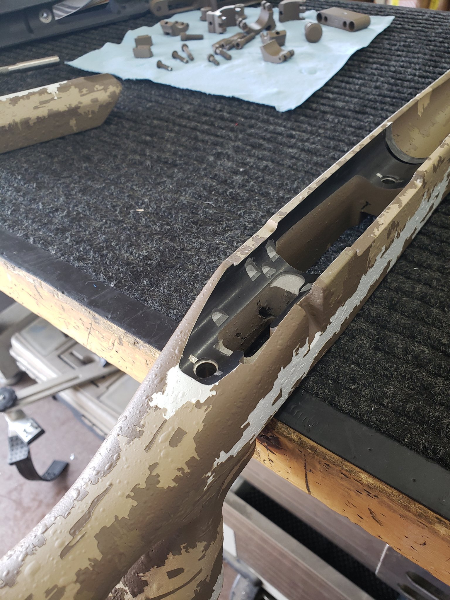

    Would you guys do this in a Manners T4A with a 18" 308 barrel that has already been pillar bedded? I'm in between doing it myself, getting a local smith to do it, or sending to the manufacturer of the barreled action.
    Some of my rifles have it and some don't. I personally have never witnessed any issues with it either way. I really don't see how it could affect anything.
    See how it shoots before you do anything. I bedded a GRS stock to a Howa 204 that shot .75ish. Dropped my Wby Vangaurd 243 in and its .4-.5. No reason for my shooting abilities to chase tighter than that.
    Reason I ask is because some videos I was watching showed distinct wear marks and didn’t want to potentially mess something up with the force of the recoil with the action not fully supported. I’ll give it a shot. Thanks
