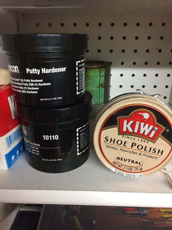

I've done about 10 guns
With Devcon 10110
All but one turned out really good!
The one that didn't I Forgot to put the kiwi release agent on the action bolts and found out the next morning what a bitch it was to get apart!
Ended up having to mill the bolts out on the stock
But All turned out ok!
Once it dries it's some tough stuff.
