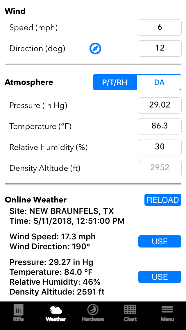

Ok, thanks for verifying. Do you know which ballistic calculators allow you to do that (record/save your zero atmosphere and update current atmospherics)? Unless I’m missing something, I don’t think Ballistics ARC allows that which I think is weird - don’t know why they wouldn’t allow saved atmospheric zero data.
BallisticsARC allows you to do it. Using your location and then the weatherflow meter will input all the environmentals you need.

Something else is going on if he is off 2" going from Phoenix to Flagstaff. That is more than DA coming into play.
I have taken my rifle to Canada, Washington State, Colorado, Oklahoma, Texas, etc. and zero is rarely ever off by more than one or two tenths of a mil.
If you are traveling with your rifle, you will want to check the zero when you get to your destination to ensure that something mechanical didn't happen to your rifle and scope while in transit.
Even if you did have the ability to enter this data in a ballistics program, I'm not sure yet why you would need or want this feature. From my experience, DA hardly effects zero. And you are going to want to re-zero your rifle anyways to make sure mechanical it is good.
Perhaps I am completely missing something, and there is value in having this feature, but I just don't see it.
You are on the right track on focusing on putting the correct details into your ballistics program - this is a shortfall of many shooters (more than the majority). The more precise you are on the details you enter in the program, the better the outputs will be.
