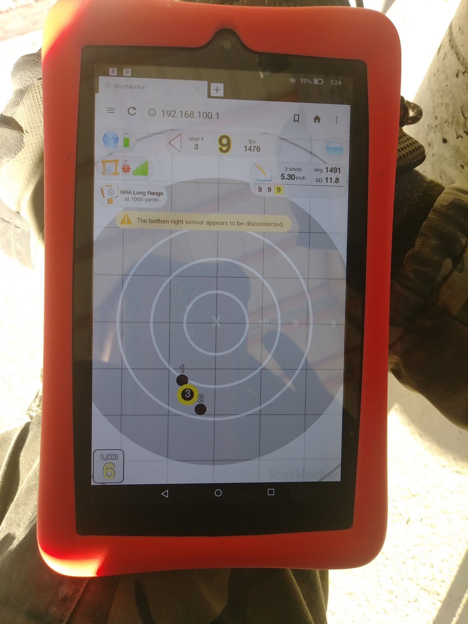

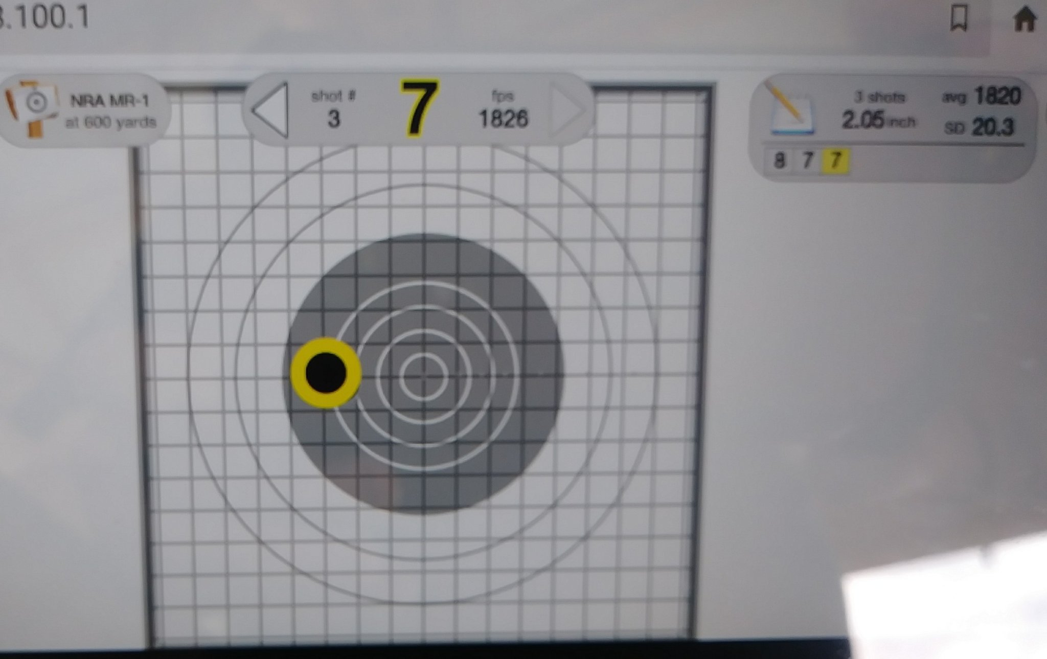

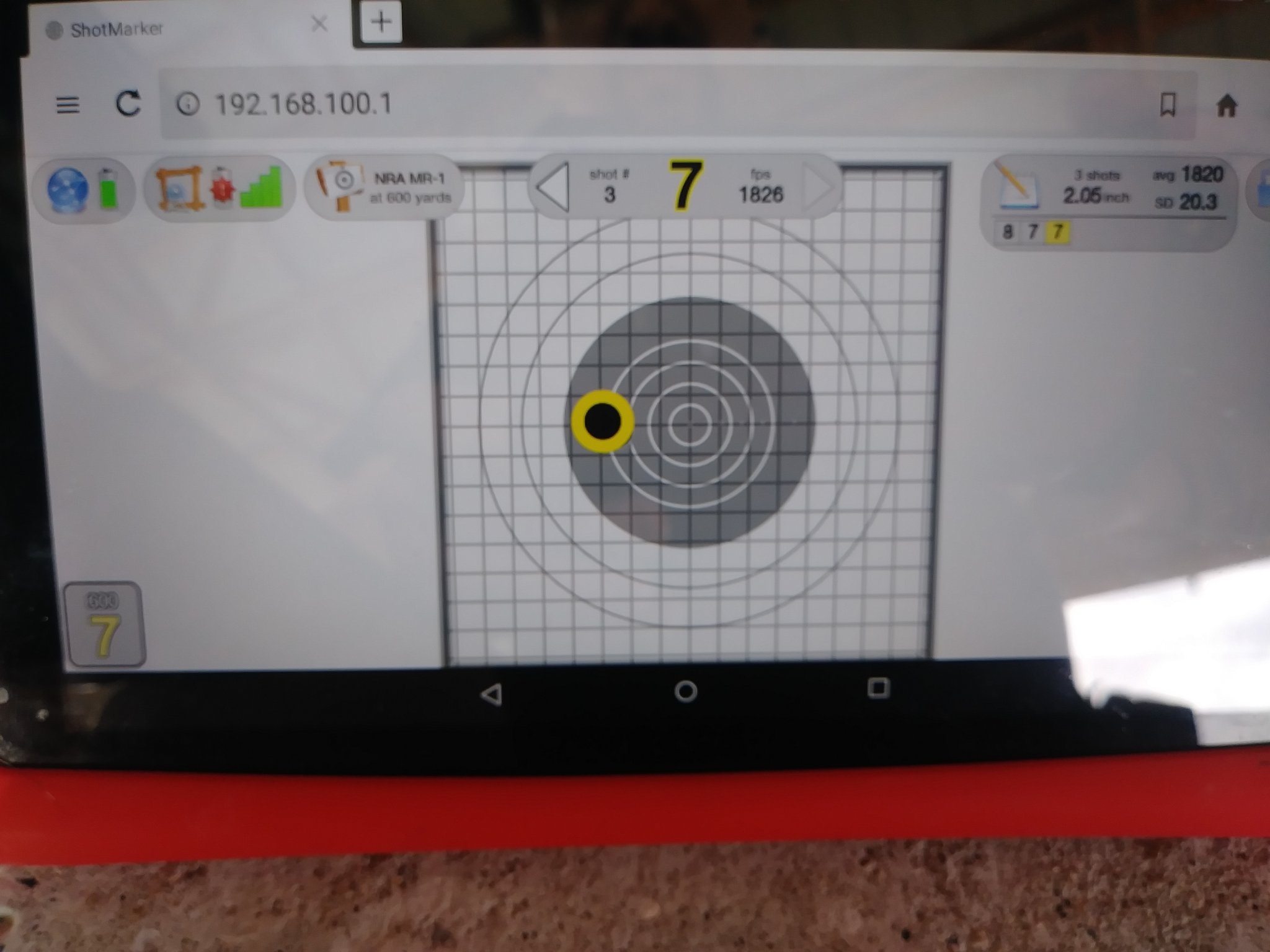

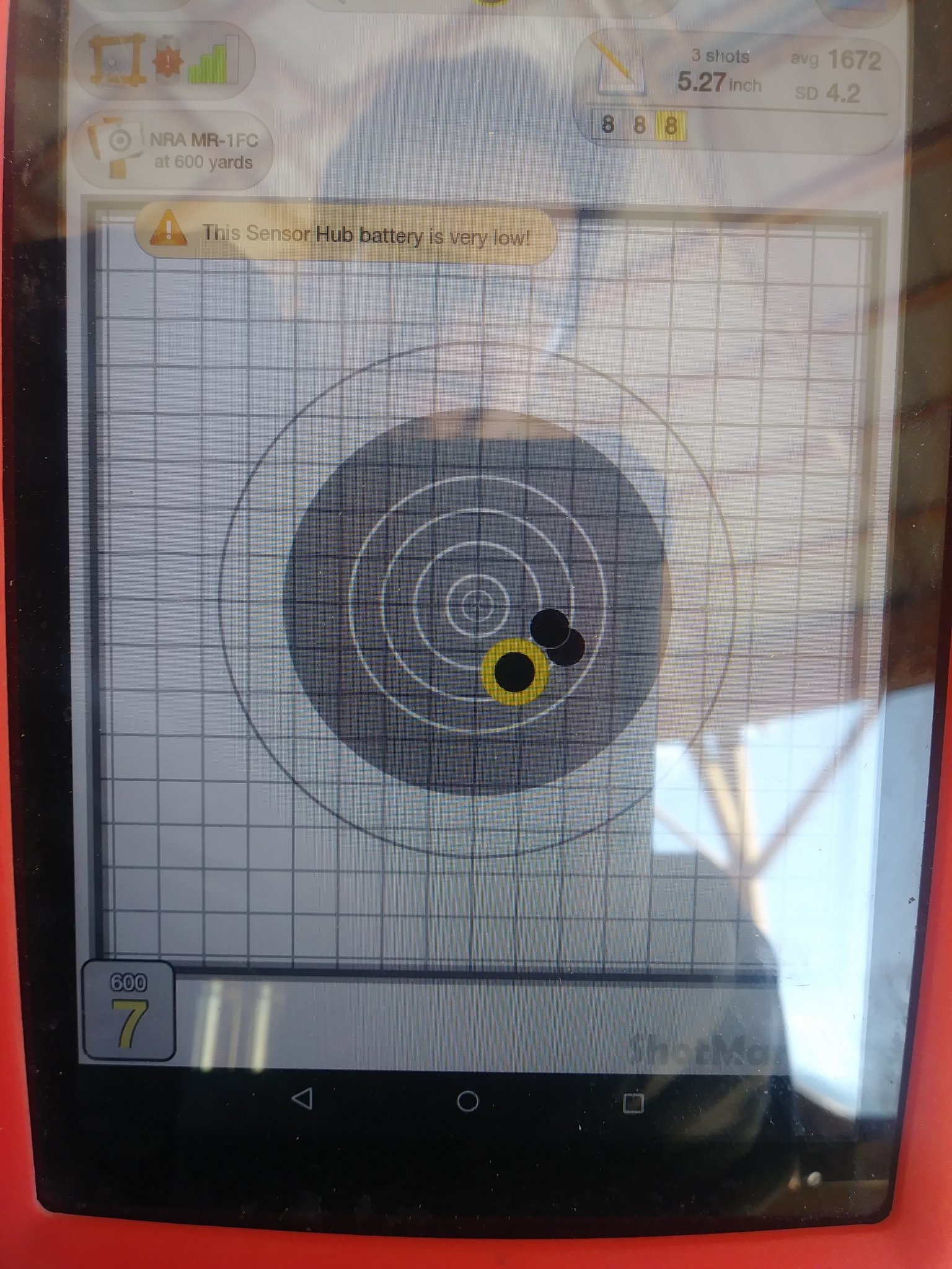

I'm actually doing range tests today between CCI200 & CCI-BR-2 primers. Here are pics of a 600 yard group and a 1000 yard group using a Thompson Center Compass 6.5 Creedmoor using the BR2 primers. The first is a 5.30 inch group @ 1000 yards yesterday. The second is a 2.19 inch 3 shot group @ 600 yards and the last is 2.04 inch 3 shot group shot at 600 yards 3 days ago. The second pic was shot with a .308 RPR
