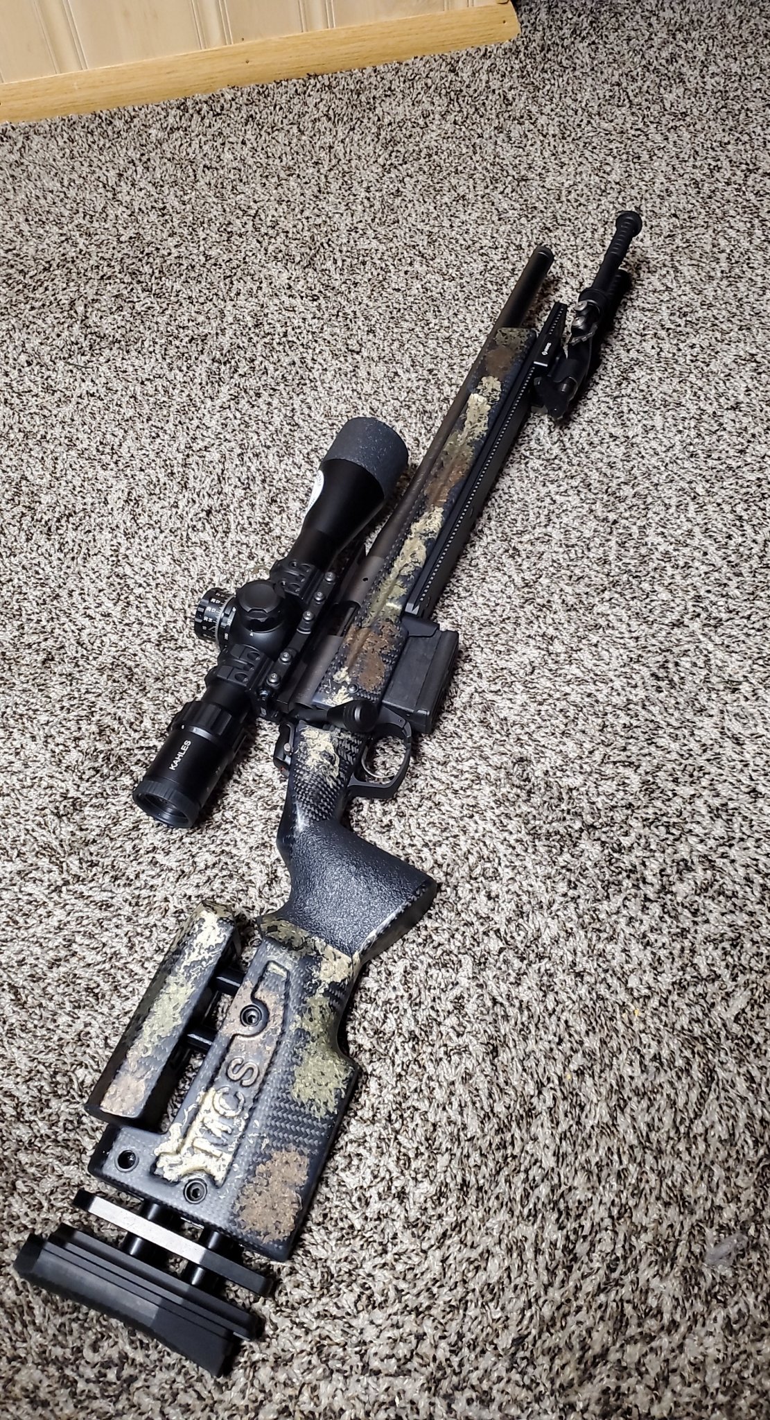

Has anyone tried to put their b14r into a MPA comp ba chassis? Just tried installing mine and the magazine wont seat correctly. It isn't locking into place and just drops free. First time I have ever used any kind of chassis system so might be doing something dumb, just followed the youtube tutorial that they had. Anyone had success or trouble with this chassis?
Sounds like the mag catch is too high. If I'm not mistaken, MPAs come with an adjustable mag catch so play with that screw until it works

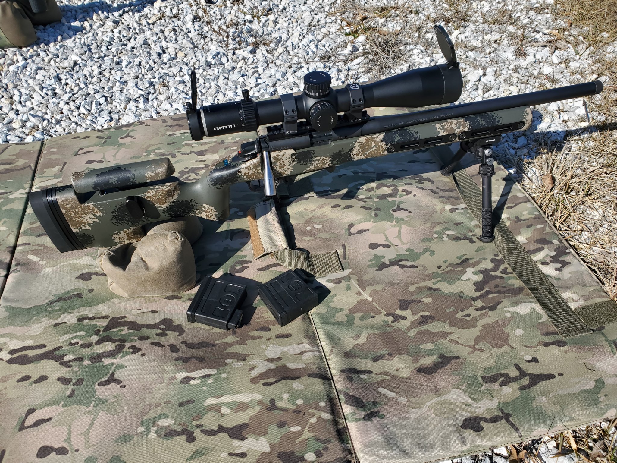

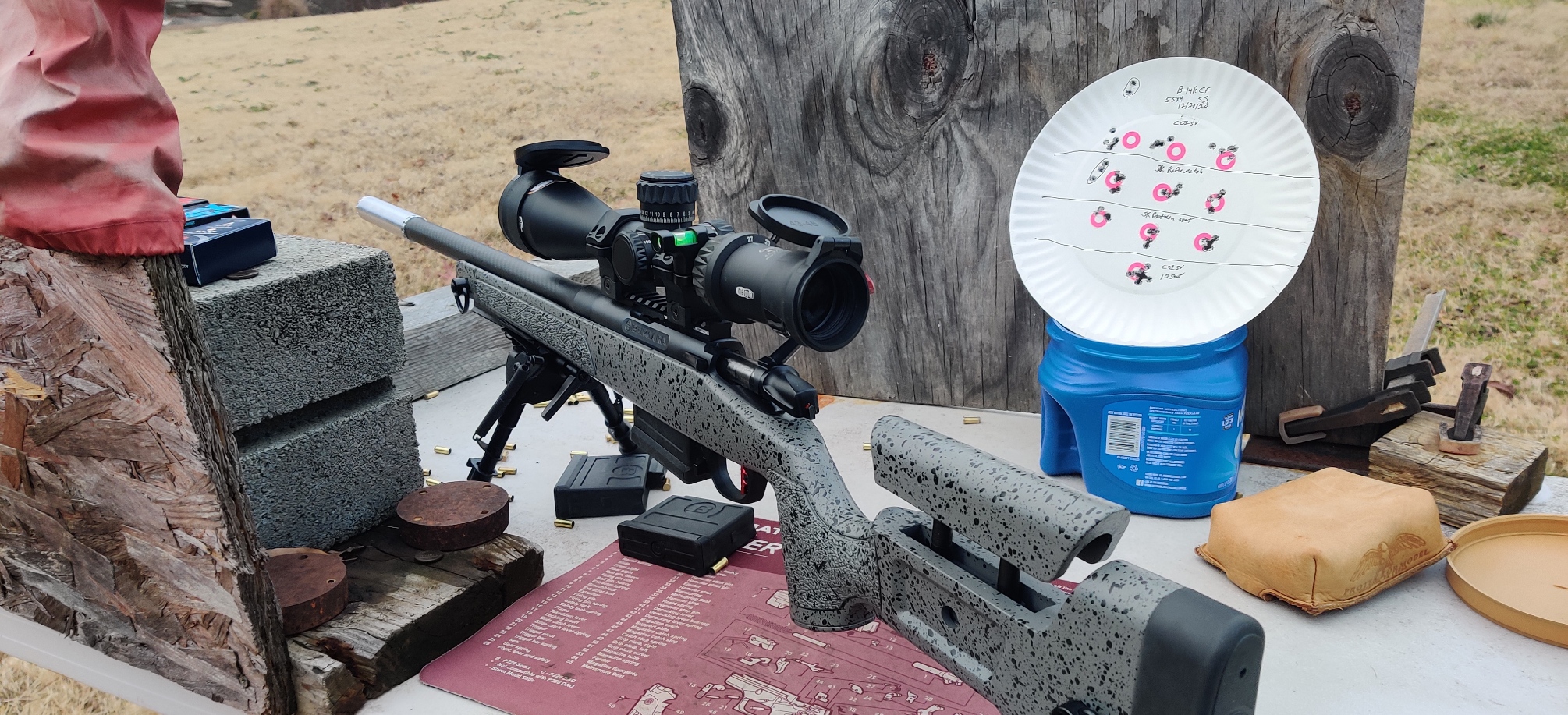

Here's my experience thus far:
Bought a steel barrelled action and am using it as a trainer for PRS type matches. I'm using one manners TCS and Kahles K525i between the b14r and my competition rig because I'm too poor to go buy dedicated parts for the b14r lol.
TLDR
Performance is there, price is right, action needs breaking in, may require specific tweaks if you don't order a complete rifle or you switch stocks.
The Good:
I've run about 300 rounds of SK standard plus through it and so far 5-10 shot groups are at a little over a half inch at 50 yards plus or minus an eighth inch. For shits I ran some crap blazer 22 through it and was surprised to see groups only slightly larger than SK but still under 3/4 except one flier that went like 3 inches low left (definitely not me, not that bad anyway)
I took it out to 300 yards and once my dope was confirmed on a 12" plate, I was smacking a 6" circle and a 5" square with a hit rate of roughly 75% with misses being due to slight wind shifts (its roughly .3 mils per mph at that range). Wind was hard to judge since nothing downrange moves till about 4 moh and I'm shooting through intersecting valleys, but wind was anywhere from 2-7mph that day so fairly calm. I was able to spot pretty much everything myself. The rifle does disappoint in the performance sector.
The Bad:
Now we come to the feel. In a word, meh. Its no custom action. The bolt feels as heavy as a stock Remington 700 and the bolt close is heavy. If the bolt is run fast (normal PRS speed) all that goes away. When I first got it the bolt close was nearly unbearable, but after running it a few hundred times it does smooth out. Lots of dry fire is needed to break this thing in.
I'm not a fan at all of the magazines. No latch to pull the follower is probably a way to avoid vudoo patents, but its a notable missing feature I'd really like to have. The plastic mags themselves feel like magpul AICS mags and unfortunately that means they drop like crap in my TCS. The mag catch likes to hang up on the magazine lip for some reason making dropping the mag a pain with one finger. I suspect a little filing or sanding in the right spot will take care of it, but still. I've heard mixed reports about vudoo mags in the b14r so I may try that route.
The Ugly:
*Please take into consideration that the following is happening IN MY SPECIFIC SETUP. This is in no way a condemnation as a whole, and I haven't contacted Bergara about it yet, or tried fixing it myself.
I've got some ejection issues, seemingly at random. I've had plenty of 10 round strings with no issues, and I've had some as bad as 6 out of 10 fail to properly eject, leaving brass in the action, causing a very annoying malfunction. As it stands, it is not yet reliable enough to compete with solely because of this. I'm aware it has a mechanical ejector and ejection is based on the bolt operation, and I'm very confident that I'm not short stroking the bolt causing my issues and it happens regardless of who shoots it. It seems most common in the last round of the magazine. I've had zero problems whatsoever with extraction, only with ejection.
My only ideas here are that the magazine height needs to be tuned a little bit, or the tensioner (opposite side of the main extractor) needs a heavier spring.
All in all, its a great package for the price, especially if you can score just the barrelled action for $600. I don't regret buying it at all. I've got some tweaking to do to get it to run perfectly, but I'm OK with that considering I didn't buy a complete rifle. Eventually I'll invest in a Vudoo or other custom action just for smoothness sake and maybe a slight increase in accuracy, but the b14r should do very well in the meantime.

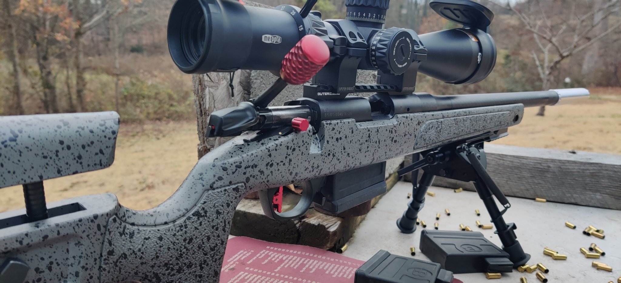

Still enjoying mine, but I may have to change up the scope for group shooting. I think I’d prefer a floating dot over the open center that’s in my PST II.

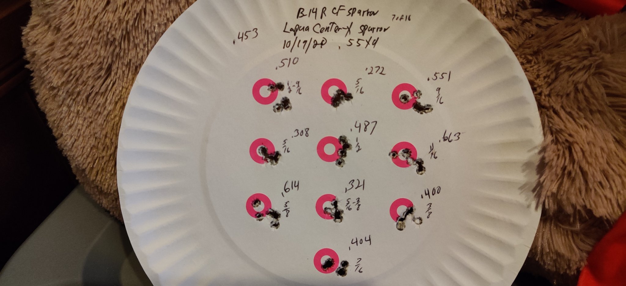

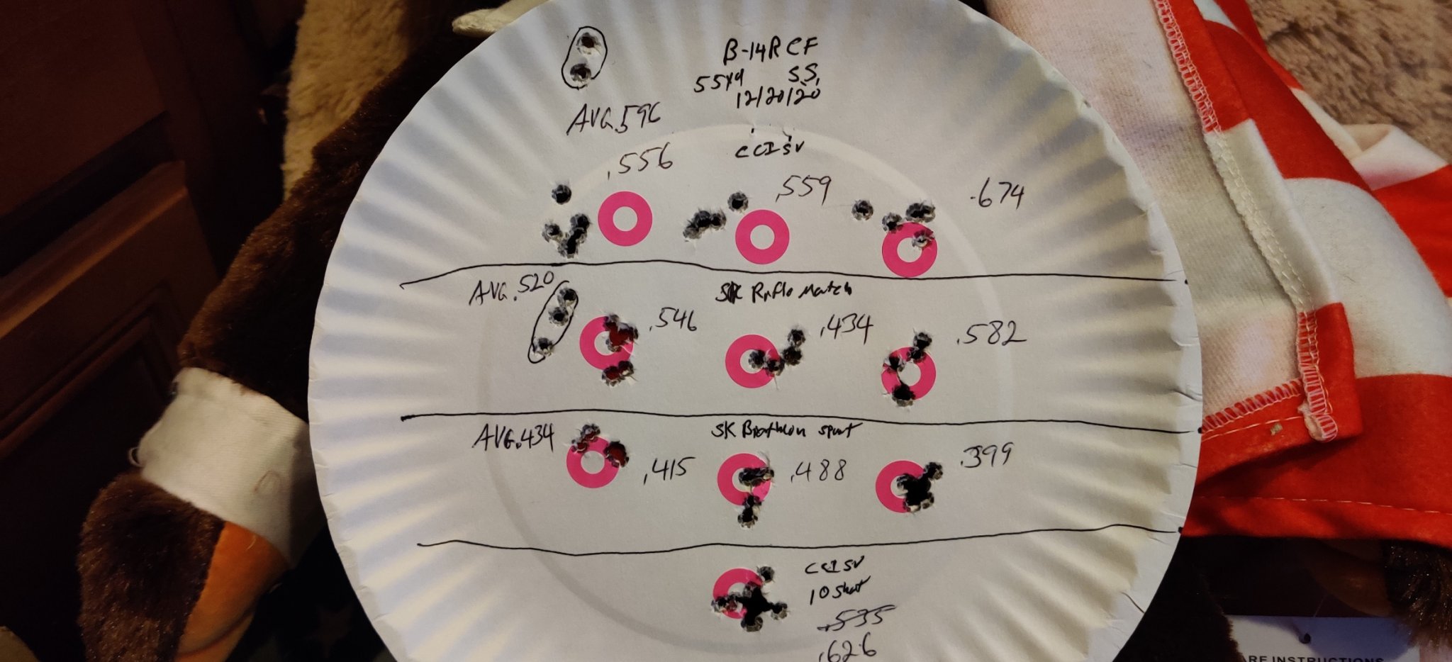

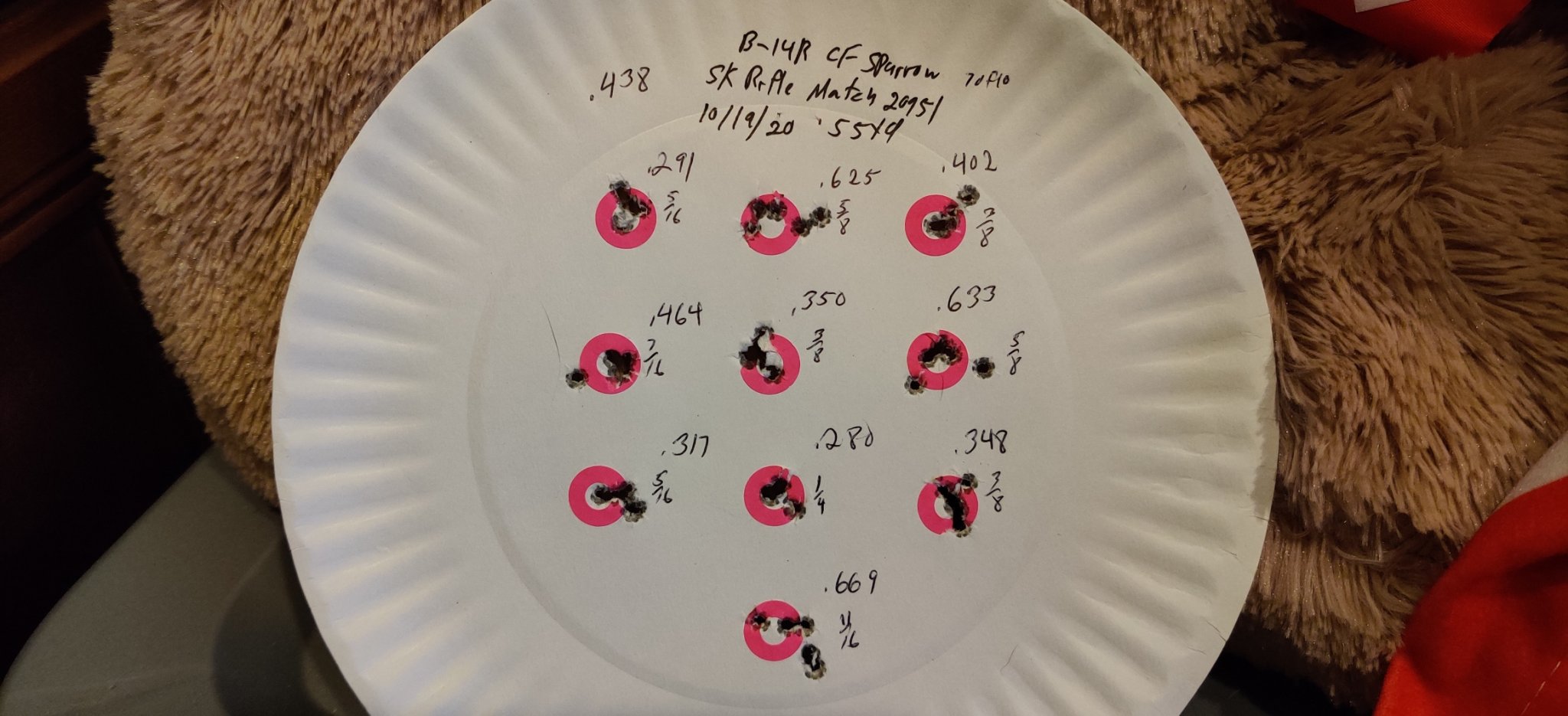

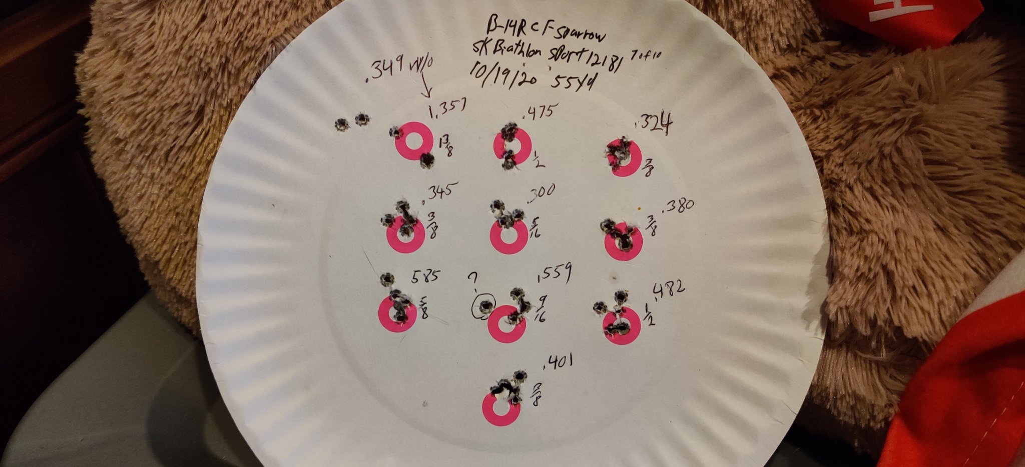

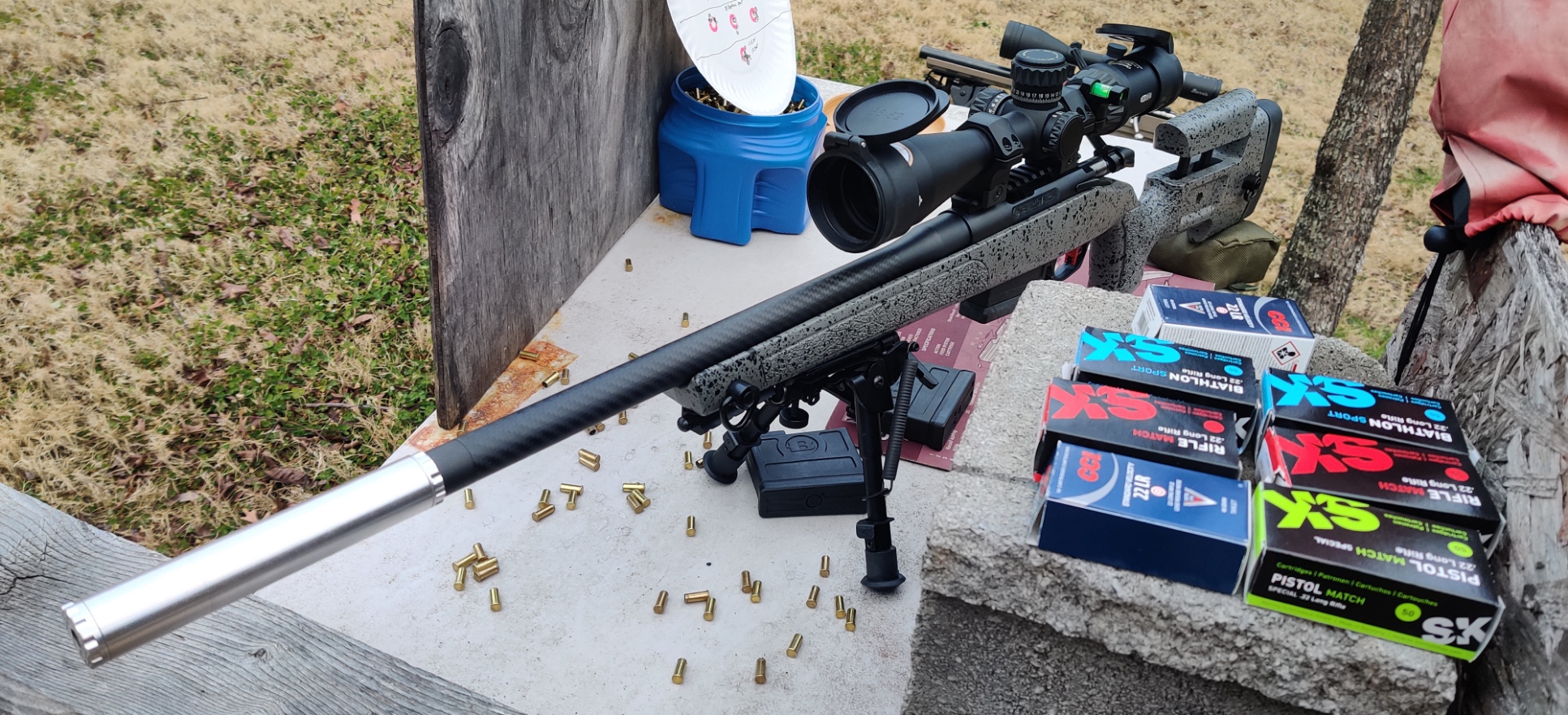

Been awhile since posting anything. Shooting but not posting much. Still working on the new house in VA. Anyway, here are my last groups from the B-14R CF version. All were shot with the Sparrow suppressor. Most of my shooting at the moment is me grabbing a rifle or pistol, walking out and shooting off hand at my 3" swinger. I'll shoot 5-8 guns, 10 rounds each. Sometimes I'll do it twice a day. It's like a "fix" for me. Haven't been on the bench in a few weeks. Also look for an update on the Penrod B-14R.

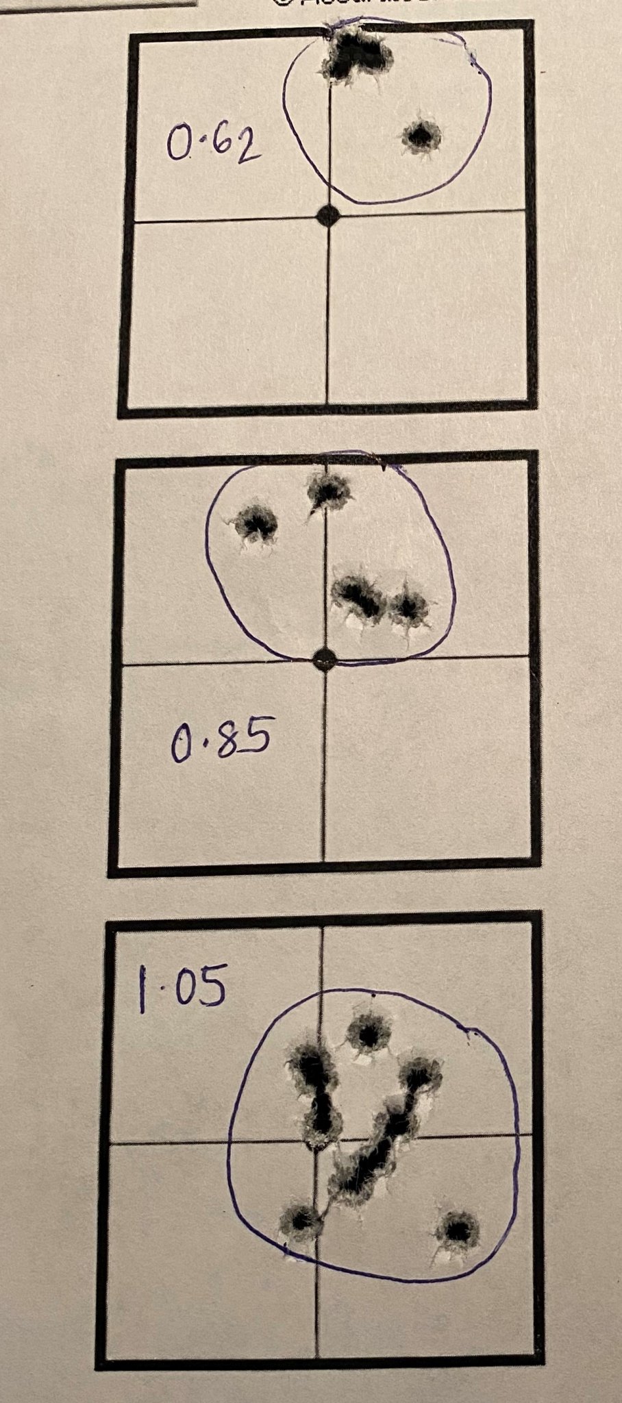

Went to the range again today and I feel like I figured out what has been causing my large groups.
First photo is the group from one of my last range sessions. This was with eley contact @ 50 yards and while it wasn't terrible I felt the rifle could do better. First two were 5 round groups, last one was a ten round group.
This was after I removed the rifle from the stock and tried different torque settings. I immediately saw my groups tighten up. This is with 20 inch pounds on my front and rear screw. I shot the bottom two left groups first (two 5 round groups) and then the 10 round group on the top left but felt myself pull a shot. The top right was a re-do on my ten round group cause I felt I could do better. I'm definitely happy with these kind of results using cheap eley contact.

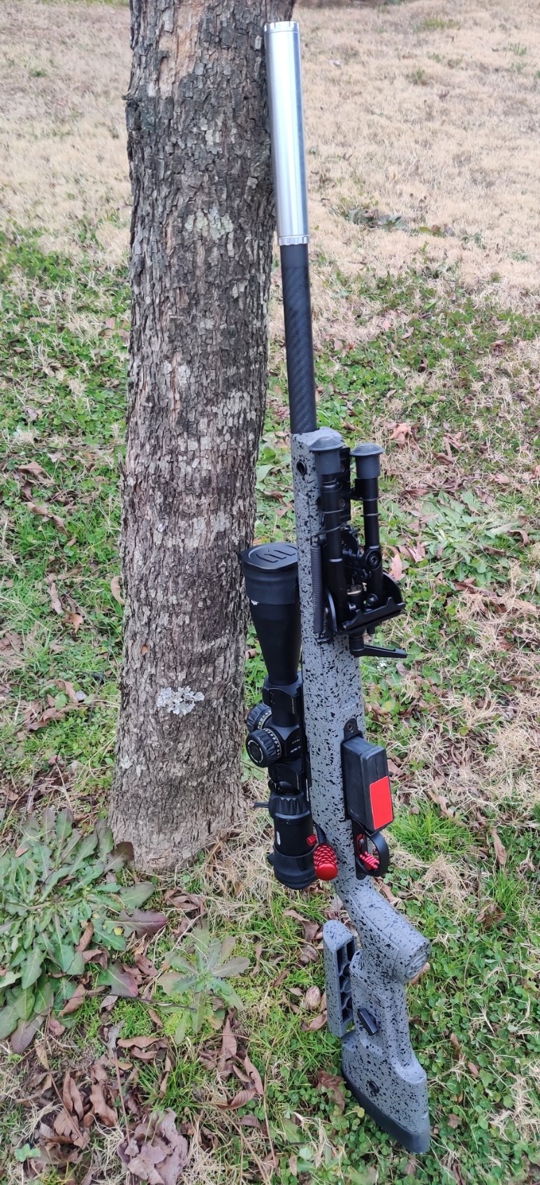

Thanks for this. Will you post a pic of your training setup?

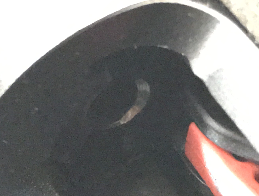

I had to actually cut a small feed ramp with a dremel to get mine to feed reliably. It sits in a Mcmillan A4 and now it can utilize its own magazine or the vudoo mags with no problems. Obviously this voids the warranty so take it for what it is. I was so frustrated with the poor feeding I didn't care. Did'nt have any impact on accuracy and does not mar the tip of the bullet. Your results may vary :)

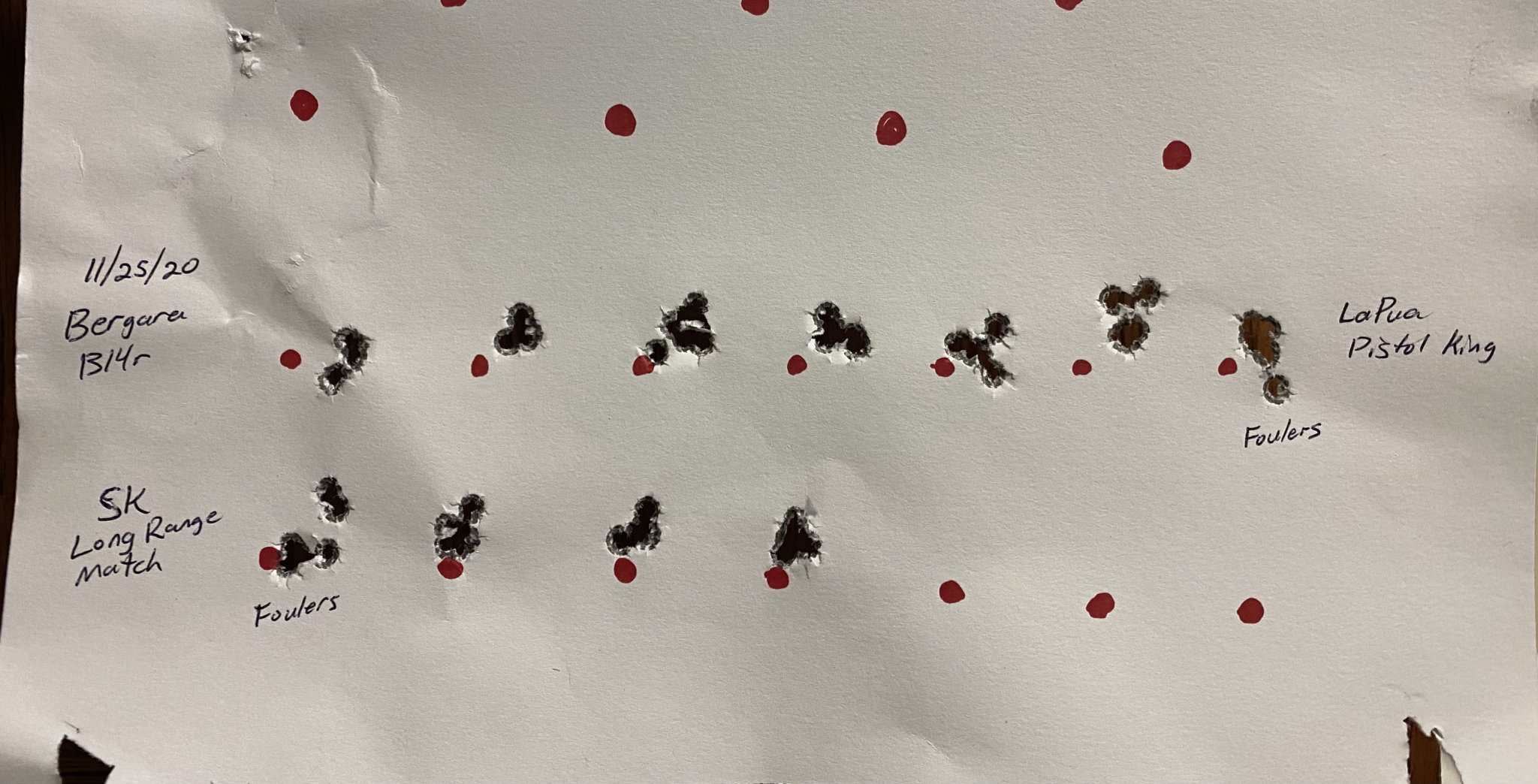

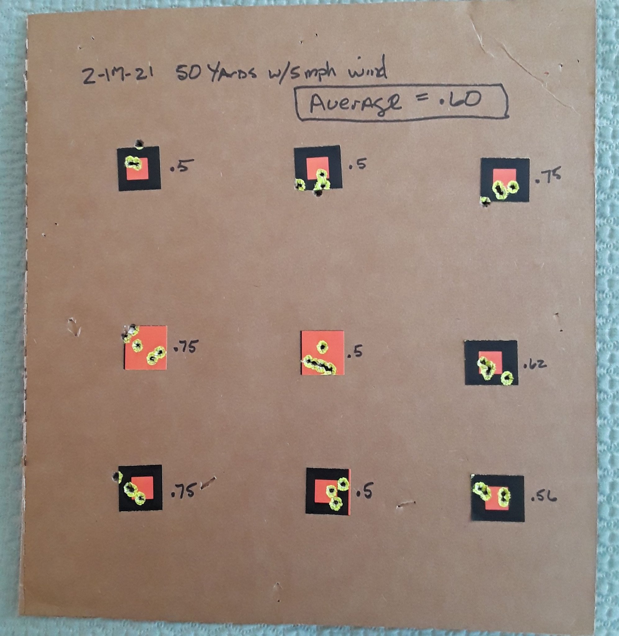

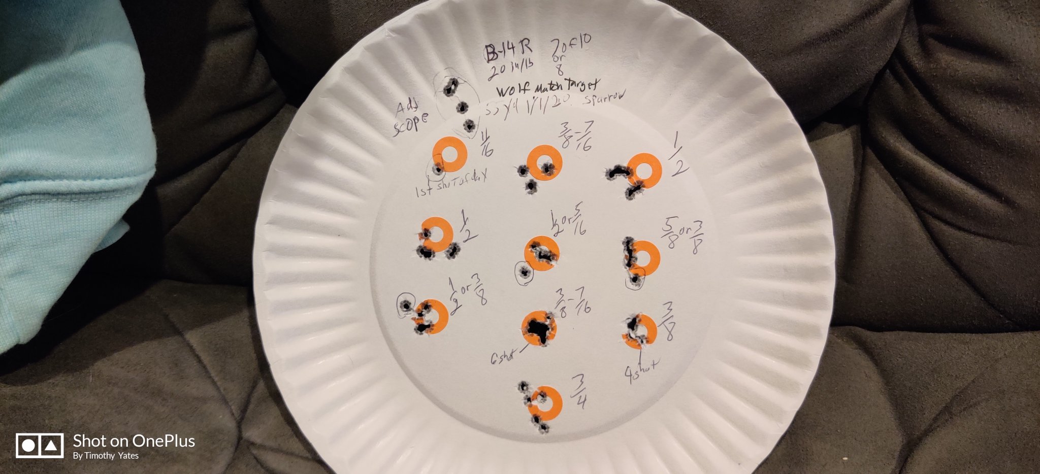

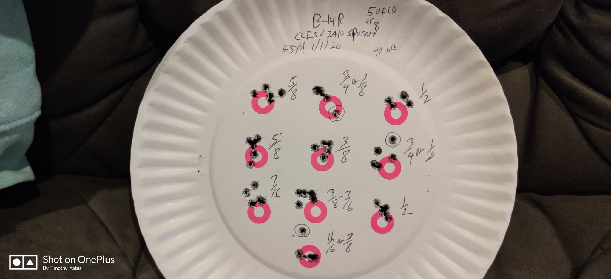

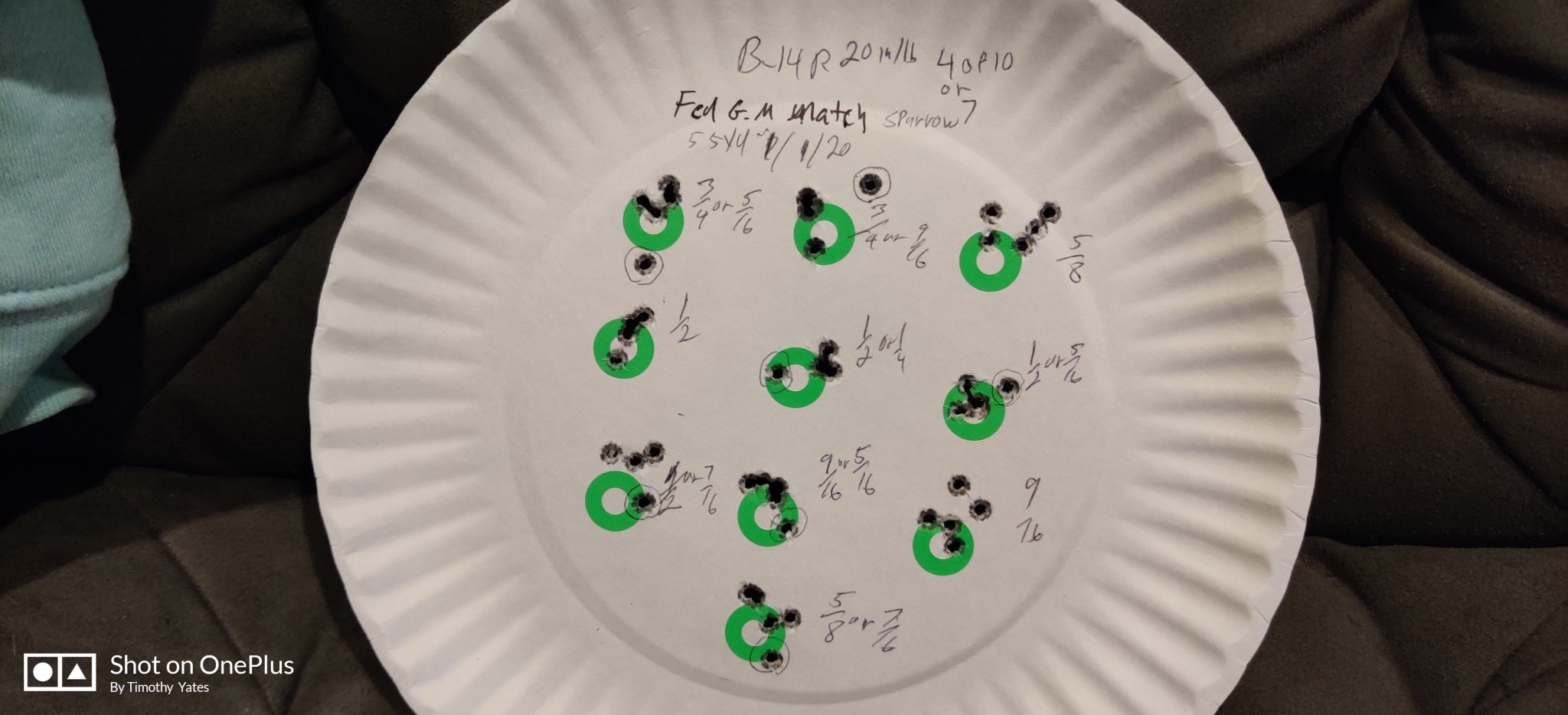

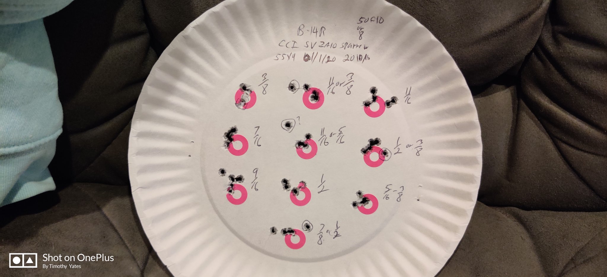

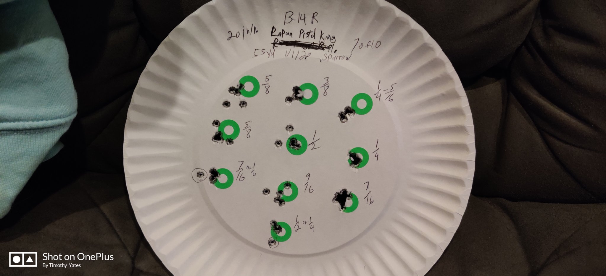

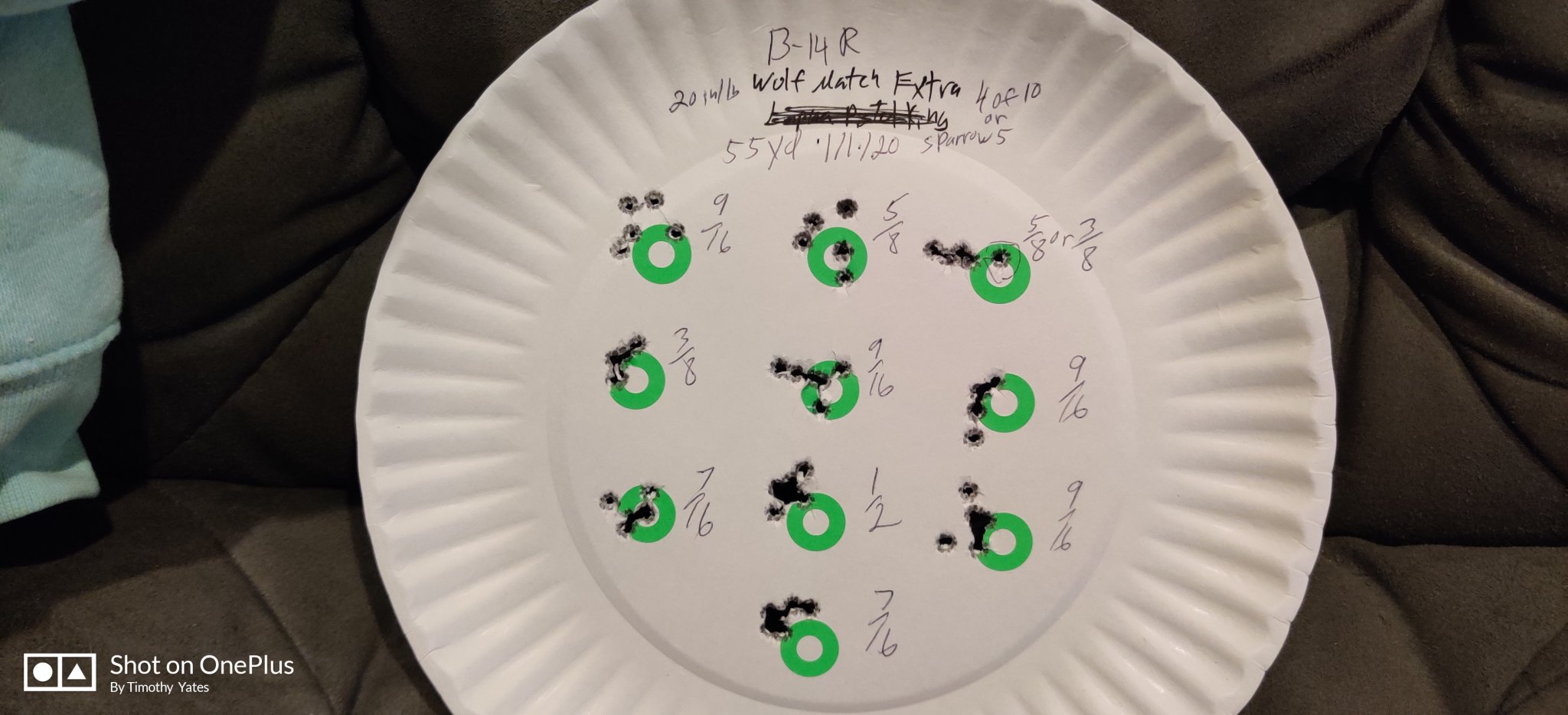

I'm going to post these from best to worst. Details are on the targets.
:LOL:
As promised, there you have it. I'd like to stress the importance of giving an accurate review, summary, assessment or whatever else you want to call it.
Even though I didn't get exactly what I had hoped for in the accuracy department I'm still happy I bought the Bergara and would do it over again. The feeding is phenomenal and I do believe the accuracy will get there. Worst part about the rifle is the trigger and it's not all that bad because of the crispness it has. No need to replace anything really. As said, IMO the best way to make this rifle better is change the trigger. I wouldn't know why anyone would want to replace the stock. Nothing left to do except a barrel change but if that was the case I'd just buy a 457 Scout with the intentions of replacing the barrel and the stock from the get go,....oh wait, I did that. :LOL: I know people may bring up the Vudoo for comparison and that's ok. I don't have one so I can't compare. If Mr. Bush brings out a low bolt throw this year I will have one of those too. ;) You may ask, well why did you buy the B-14R knowing it has a high bolt throw? Well the answer is, it didn't cost me $2,500.
