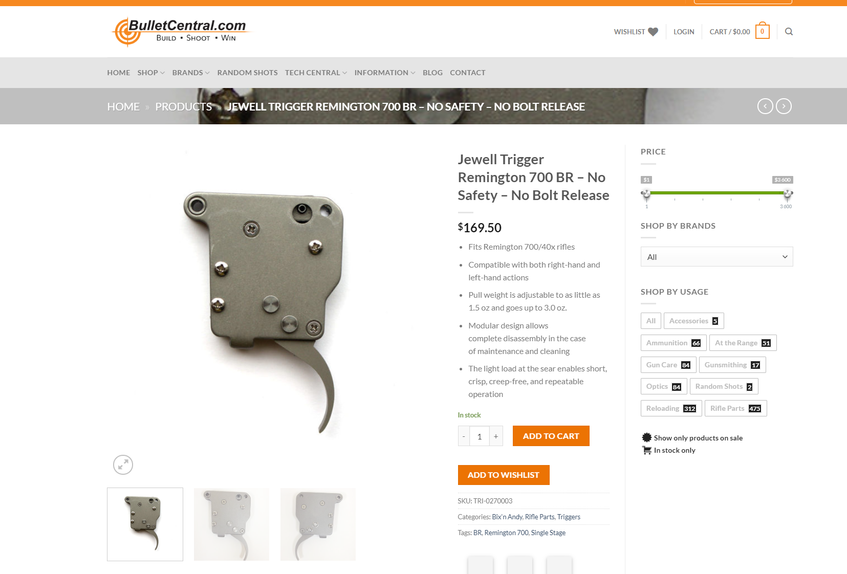

Jewel makes two really cheap triggers that should work. One is set at 1 lb and then there's this one. There's no safety if that matters. Thanks for reading my thread, I won't say anything more that isn't already said about my trigger experiences.
