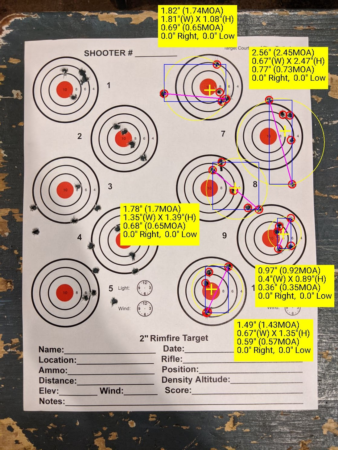

I went out to the range today and mounted a brand new Athlon Midas TAC 6-24×50 scope with APRS3 (Xmas tree) reticle using Burris XTR Signature rings on the Bergara BXR002 (10/22 clone) rifle with the carbon fiber barrel. I spent the first half of my time futzing around with the inserts of the Burris rings in order to bottom out the scope. Once I got the scope where I wanted, I started trying to zero scope and was having a difficult time because the groups were horrible using the inexpensive Aguila Super Extra SV 22LR ammo. Yeah, this is not the best ammo for shooting tight groups but it usually groups well with an occasional flier. Not so today with the BXR002. The groups were so variable that I could even decide where the center of the group should be. At 50 yards I had a spread of over 4 inches in one 10-round group. Admittedly I’m not a master marksman, but I can shoot fairly well from a bench or prone with a bipod and a rear bag. I have a brand new cheap Ruger 10/22 that outshoots the BXR002 from the get-go with the same Aguila ammo.

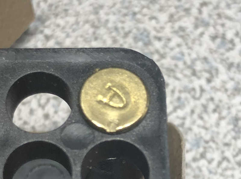

Now before I continue with the accuracy info, let me mention I am still having problems with the mag not dropping free at times and intermittently have to fiddle a bit to get the mag inserted. Before carrying the BXR002 to the range, I did not tear it down and clean it. I did however use OneShot and work the bolt for a few minutes multiple times beforehand. During shooting I had failures to feed, dented bullets, failures to extract, and failures to fire caused by light strikes. A little testing and I found it required a lot more lubricant in the action in order to be semi reliable. The rifle may need more break-in. I’ll follow up as I get more information over time.

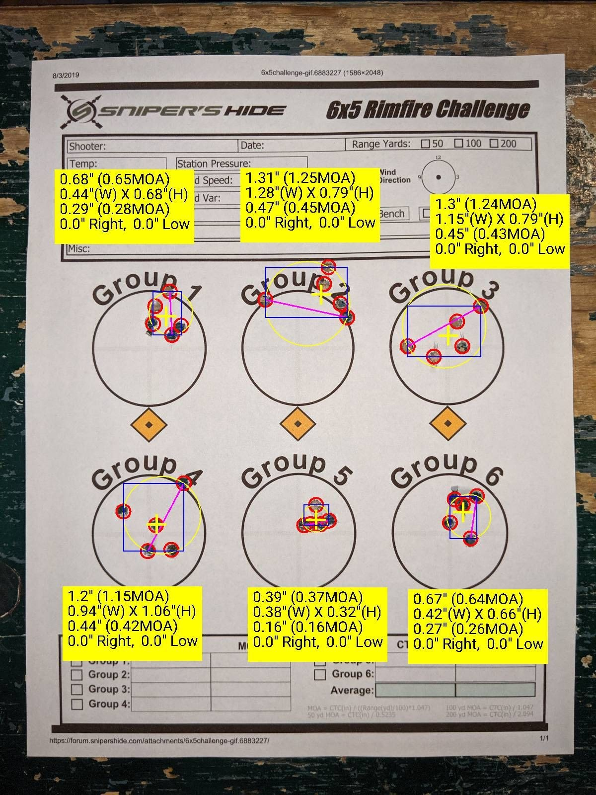

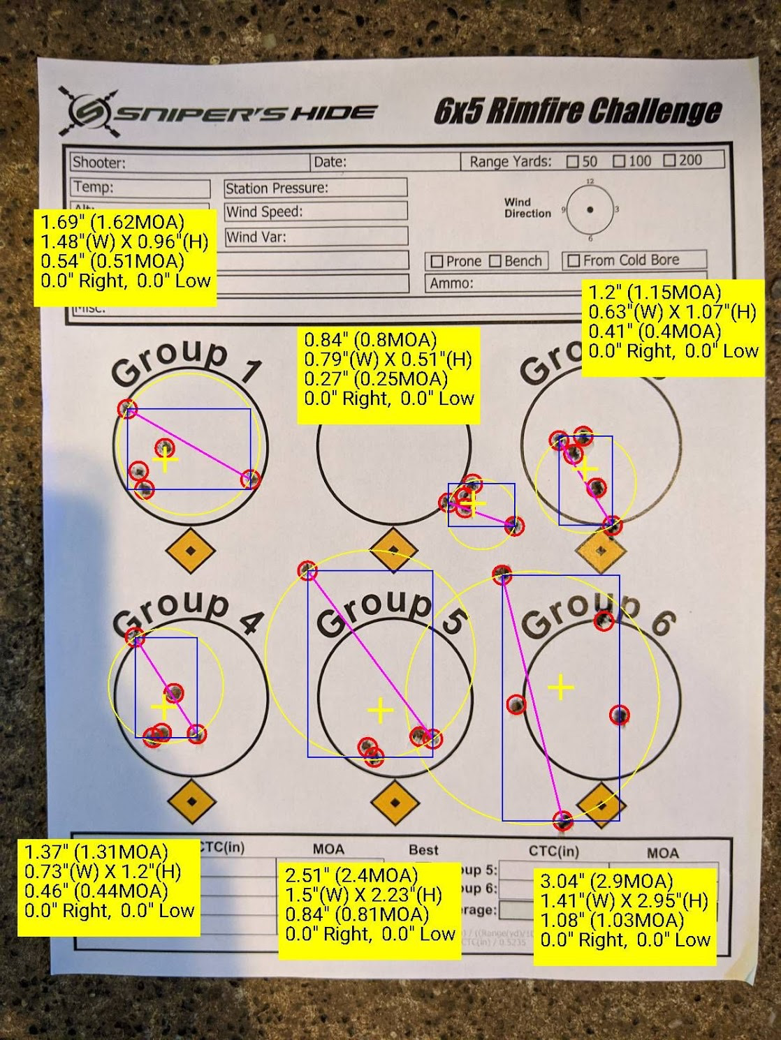

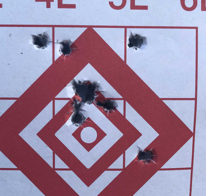

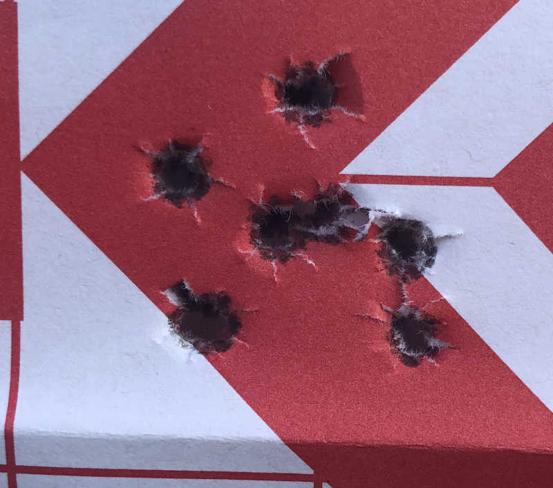

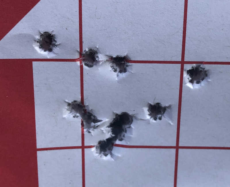

Given the accuracy I was seeing with the Agulia ammo, I decided not to immediately swap to better ammo to continue testing. I went ahead and fired another 200 rounds of the Aguila SV through the BXR002 to see if the barrel would break-in a bit. While I did see some accuracy gains, it still wasn’t grouping well. The best (cherry picked) group I had with the Aguila SV was around 1.5 inchs at 50 yards (photo provided). At this point I decided to swap over to better ammo and give it a try using the 3rd best lot of Wolf Match Extra (made by Eley) that I’ve ever owned. Note – the best lot of Wolf ME is gone and 2nd best is reserved for matches. The first 30 rounds of the Wolf ME through the BXR wasn’t great. I wouldn’t call it good or even close to acceptable. Whenever I swap ammo in a barrel, I always allow for changing the lubrication. So I fired a total of 80 rounds of the Wolf ME and in the 3 photos below are the best results with no wind. In the picture ‘Bergara_BXR0002_WolfME_BEST1’ the round to the bottom left was the first round of the 10. While it is possible that it was me, I don’t think it was. As I was running low on time and had some bad groups early on, I had decided to just shoot for groups and not worrying about zeroing. This provided the advantage of always having a precise point in which to aim. One thing I did take time to do throughout the day was to insure that I wasn’t firing mags back-to-back providing time for the barrel to stay relatively cool throughout the shooting session. I also had our NRL22 Match Director shoot the last 10 rounds of the WolfME to insure that it wasn’t just me having a bad day. His results were just as abysmal and much worse than the photos provided.
As you can see from the provided targets (all shots from 50 yards), while there was some improvement, the BXR002 is nowhere near accurate enough for using in NRL22. The light weight of the BXR002 might make it a good plinking or squirrel gun out to 25 yards. But dropping over $500 for just a plinking 10/22 is not something that I would normally do. As I have time, I’ll likely run a few other ammo brands (i.e. CCI SV, various SK, Center-X, etc.) though the BRX002 just to see if it’s an ammo specific issue… but I doubt it.
Bottom line is that from what I’ve seen so far, I would not recommend buying the Bergara BXR002 on the results of my testing. Please note that this is a review based on a single sample of the rifle that I bought. It could be that I just received a sub-standard rifle or they may improve production. I was tempted to order one of the BXR001 with the steel barrels down the road. But based on the sample I received of the Bergara 10/22, I’d rather invest that money elsewhere.
