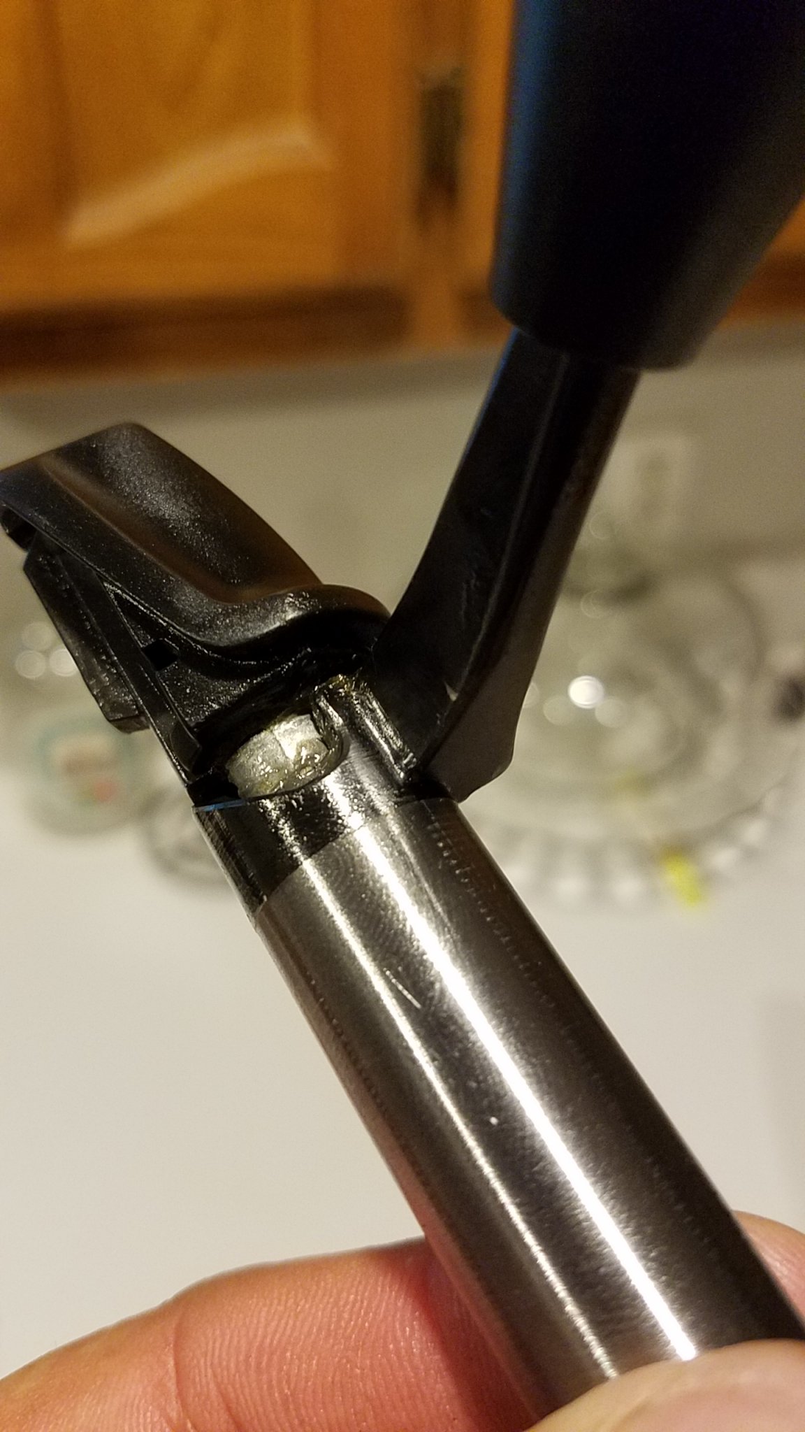

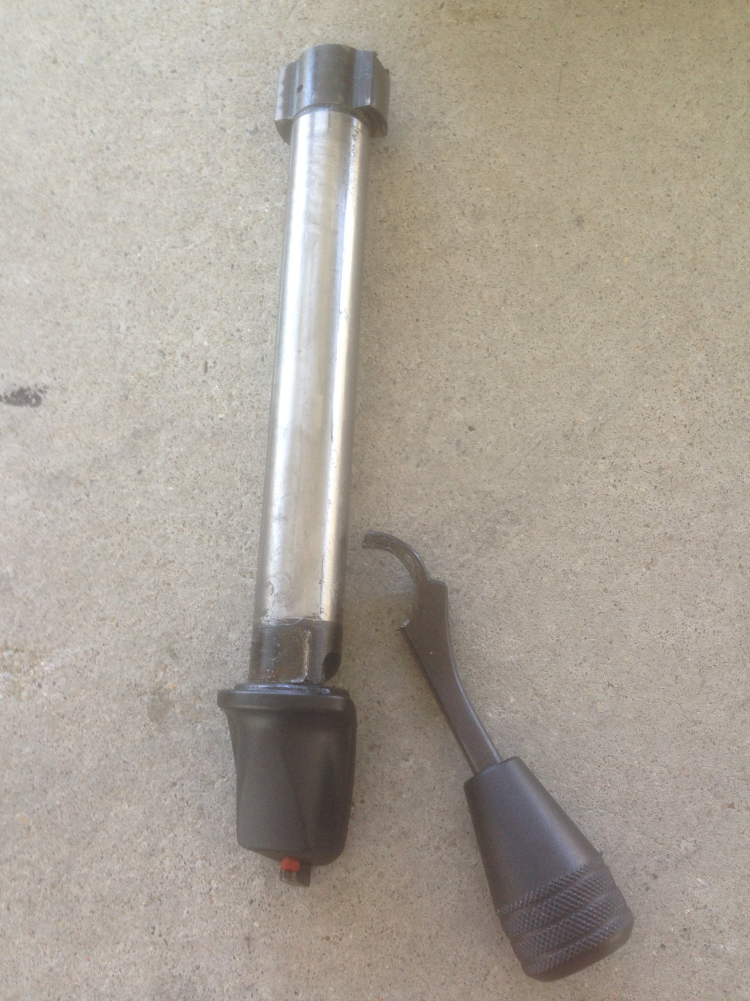

Hey guys, the bolt handle on my Bergara HMR .308 broke off two times and is currently at Bergara! 1st time at around 450rds and the 2nd at around 500rds, both times happened as I took my shot and proceeded to lift the bolt handle to extract the spent casing, no resistance, it just snapped right off at the brazing. I LOVED this rifle but after having the handle break off twice makes it an automatic disqualification in my book, if I'm going to own one good precision rifle, I need it to be reliable. Was just wondering if this has happened to any of you guys that own the HMR?

Just have it repaired by someone who knows how to attach a bolt handle properly. No reason the joint should be failing. Depending on the materials involved, you may be able to have it welded. Call LRI and get their opinion.

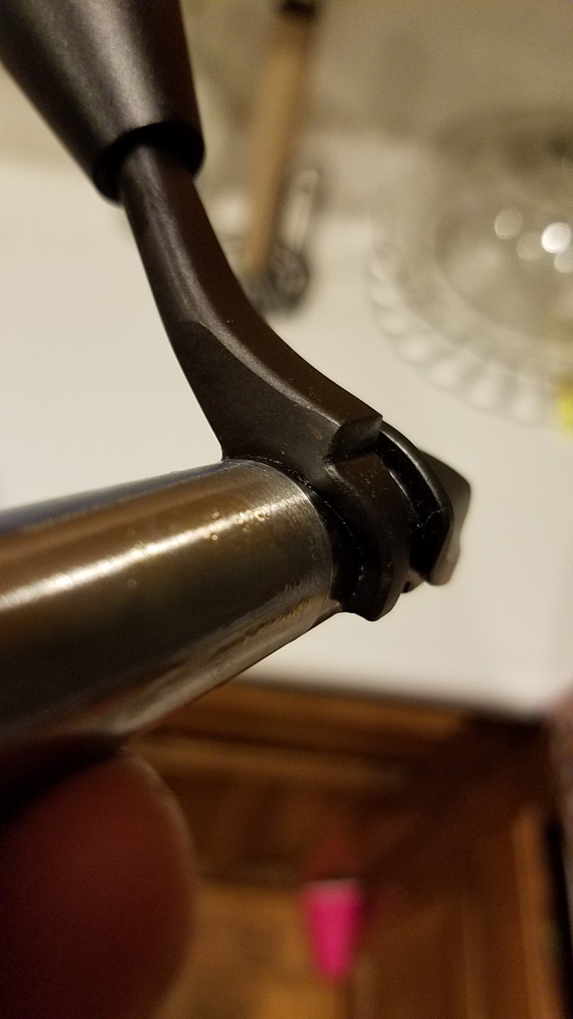

Pictures attached, anyone with a Bergara B-14 have any issues, seems like I'm the first to experience this with the HMR, User error? or is this a manufacturing defect? Still waiting to here from Bergara about this.
OK I contacted the Bergara factory in Spain a while ago as I thought the bolt handle was a weak joint and I could slide a piece of paper between the bolt handle and bolt body.
The bolt handle is welded only on the rear of the bolt , front is not welded.
Here is the response.
This is Bergara Europe, probably our dealer in USA (BPI) could you offer better after sales service. I will add a copy of this email.
Your query is totally compressible, and fortunately is has a technical answer:
The bolt handle is laser welded, forming an “L” shape that surrounds it at the rear, it’s not brazed. Our abusive tests (250 kg force applied on the knob) concluded that most of the times the bolt itself will break prior the welding fails.
The inclined front wall is functional. It prevents the cocking piece kicking the sear HARD when pushing the bolt assembly forward, and also it acts like the primary extraction CAM (pulling the fired case rearward slightly, in case it’s stuck to the chamber). This surface is critical for rifle perfect performance, those dimensions must be under strict tolerances, so welding this angle isn´t best idea.
After ensuring that the “L” shape was strong enough to fix the handle, we decided not to weld the inclined functional wall.

The first time the bolt broke at around 450rds, I contacted Bergara and they sent me a bolt within a couple days, Excellent customer service so I thought i'd give it another try as the HMR was still a new rifle at the time i purchased it, The second bolt lasted around the 500 round mark and thats when the handle broke exactly the same way it did the first time.

^ It is laser welded on three sides the front is not welded.
I see what you mean now,I meant front and rear of the handle. where it attaches at the bolt. I tried to put a piece of paper under it , I couldn't get it under,may have just been a bad handle and wasn't true to the bolt who knows ,even the best company's have products slip through Quality control sometimes
