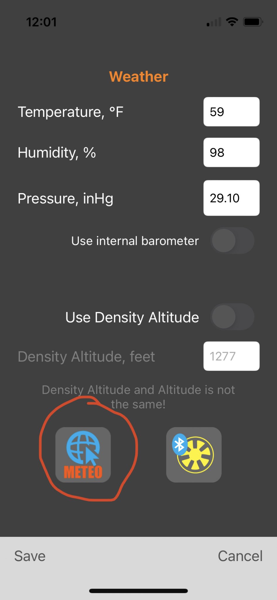

Most of the time, as long as you've got wi-fi or cell signal, just updating Strelok's weather off of what's online (nearby airports/weather stations/etc) will give you usable elevation (usually put you in the ballpark as far as wind/windage too):

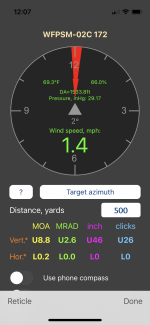

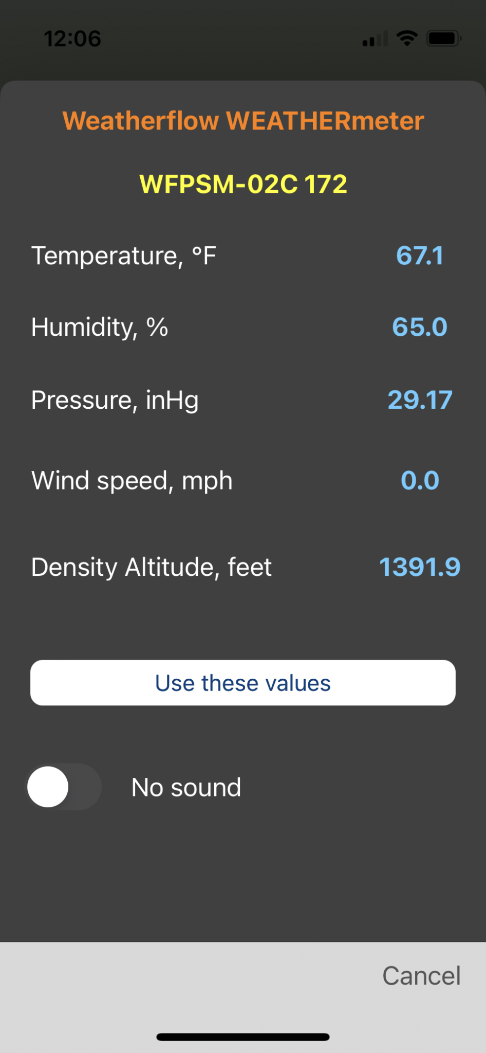

When you want to be more precise, and want the exact weather where you are (also and/or when you don't have wi-fi or cell signal), Strelok will communicate with the WINDmeter using Bluetooth and it'll look something like this (depending on what you're doing):

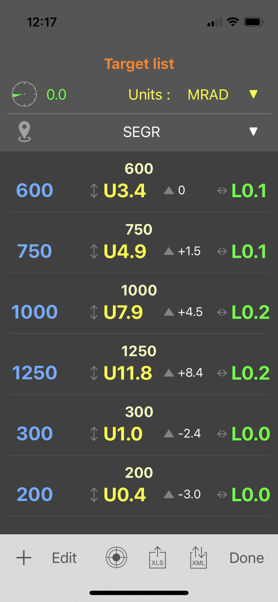

Plus, it'll make your target cards for you:

I have had this app for a couple years now. It is great. My wife got me the weatherflow meter that hooks to it. Take a reading and press a button, point toward your target and press another button, wind holds appear on the chart. The cool thing about the weatherflow is it gives you DA.
