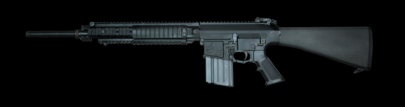

Not exactly correct on the KAC lower. The KAC uses the KAC/DPMS magazines but their uppers are not compatible with DPMS/Fulton/IRA uppers. Laure and LMT are the same as KAC's.
The DPMS style is rounder where the KAC/LMT/Larue is more angled like the AR10 - but they use the same magazines.
IRA DPMS lower
Larue OBR
KAC SR25 EM

Koz is right on about the KAC fitment issue...my mistake.
