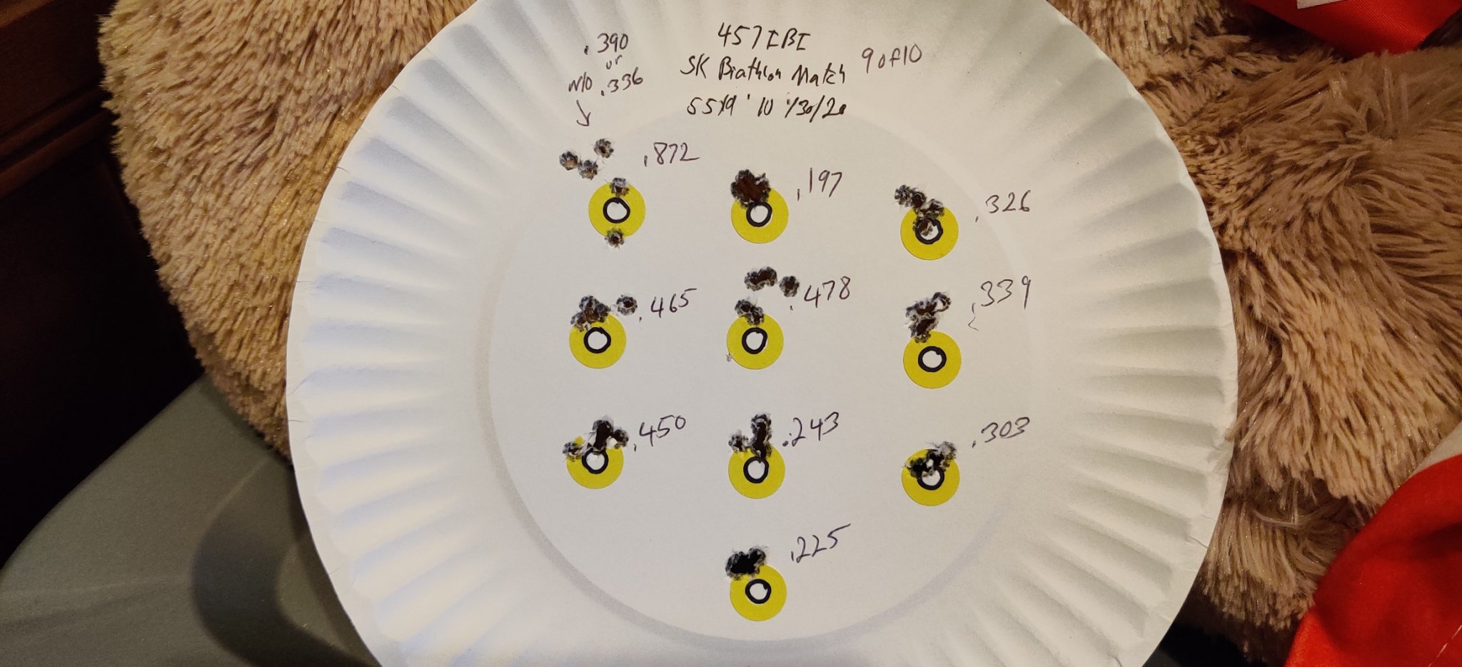

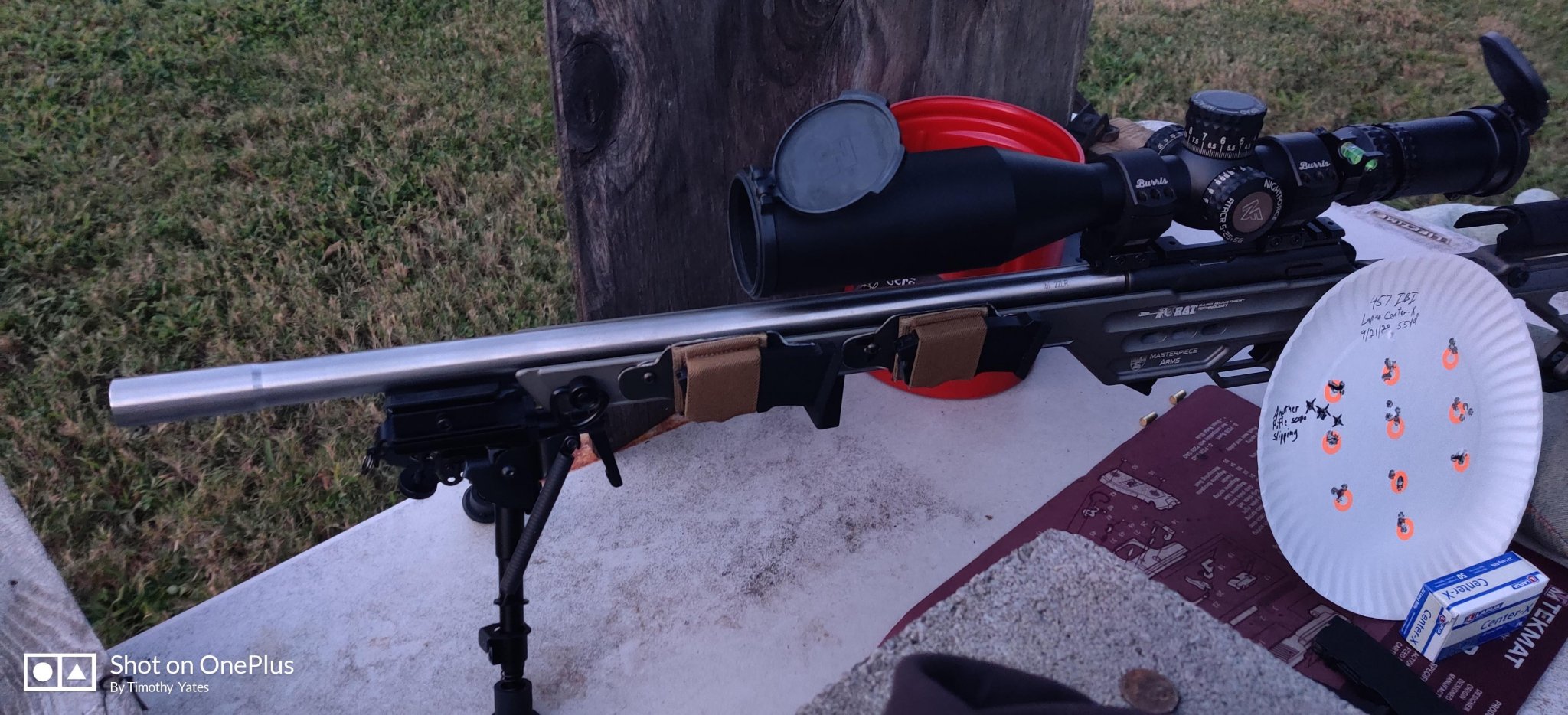

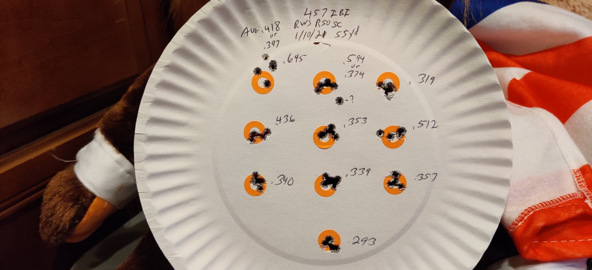

I would suggest looking a the IBI barrel offering. They come with the Calfee 4 chamber. I like mine.

I have spent a few hours attempting indexing with the Shilen cone breach.
Interpret my results as you will. Did group size and location change as the barrel was rotated?
Looks like it to me. Were the results repeatable at 50 and 100 yards? It was for me.
Will it work for every barrel? Can't say. Only ever tried it with the Shilen.
