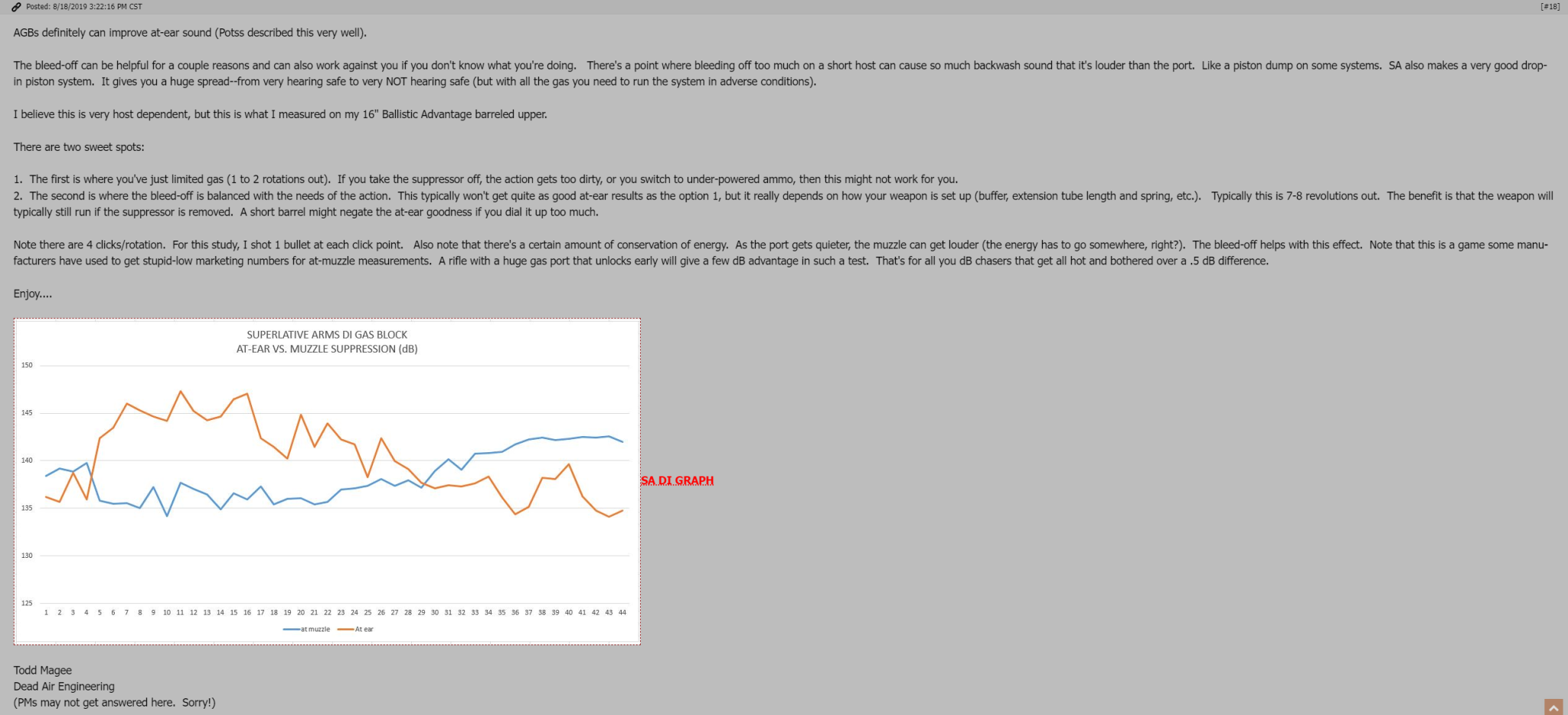

    Here's some info about restricted mode vs bleed off mode (from Todd Magee of Dead Air on another forum) -
