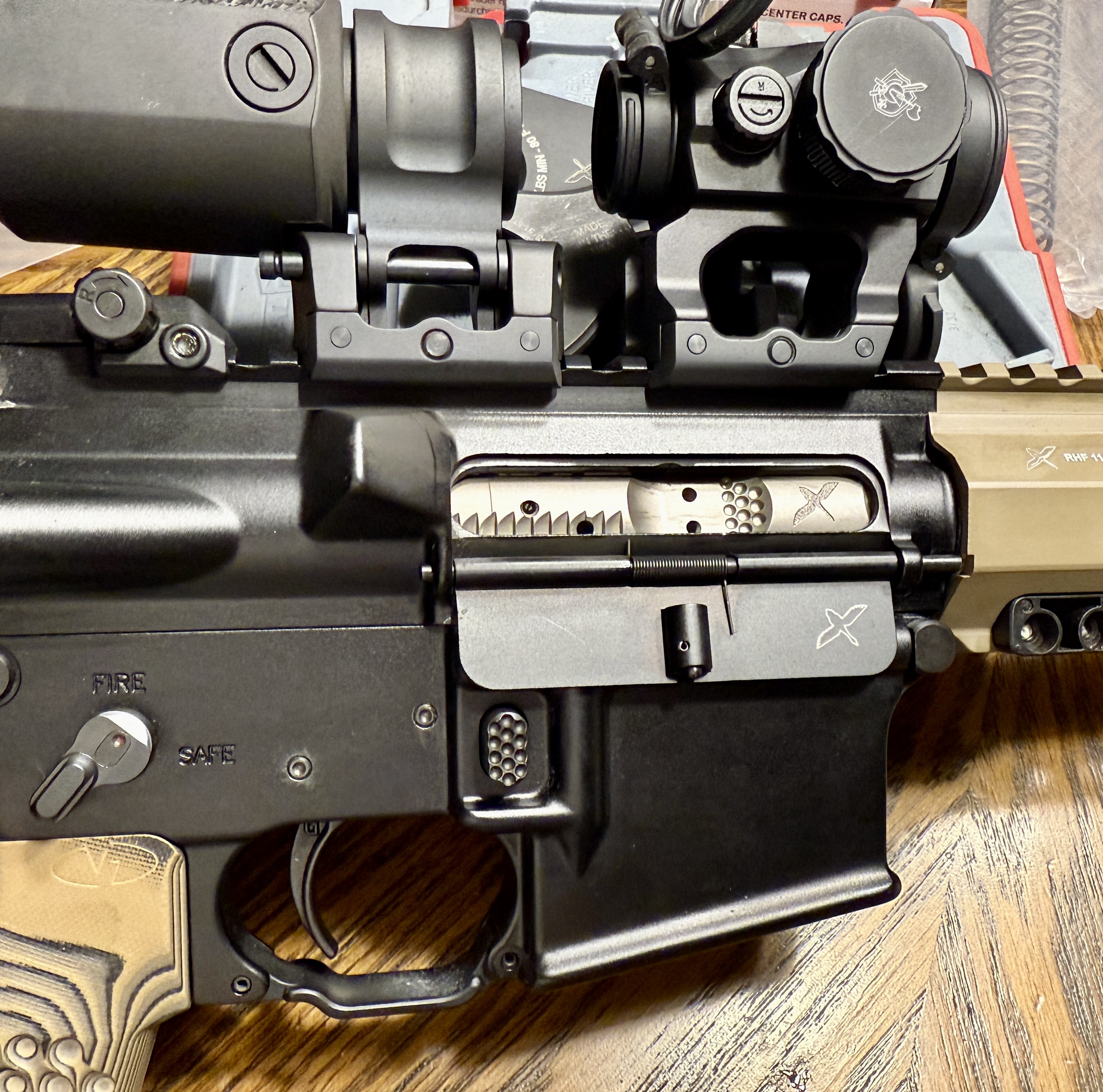

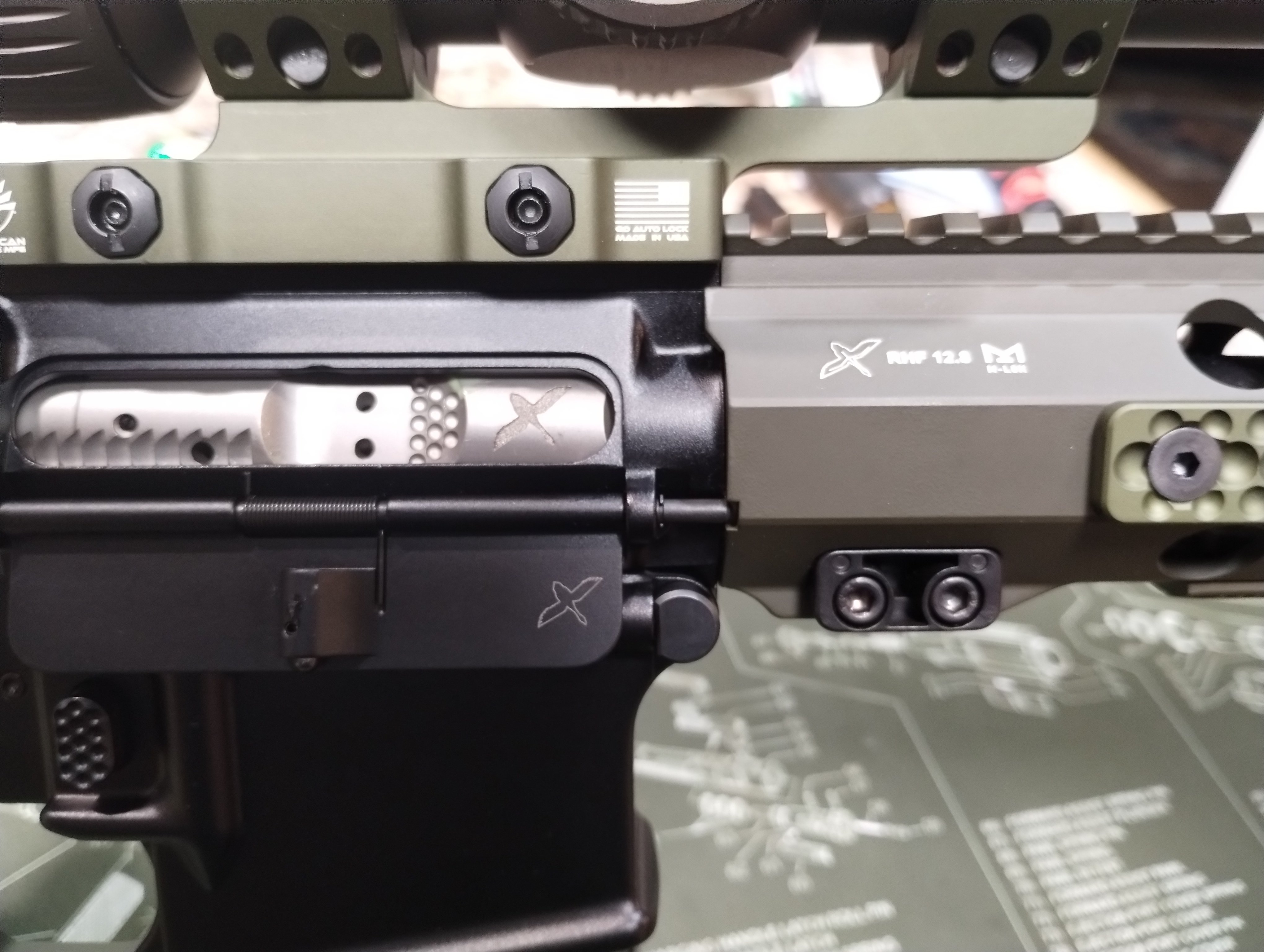

Nice! Is there noticeably less gas to the face with the down vent carrier?
Well it's hard for me to know for sure... Being that it is in Gibbz' left-handed non-repicrocating sidecharging upper... So with this rifle, my face is on the opposite side of the ejection port, plus the action is "sealed"... But the other day I saw a video, it was one of those super ultra slow motion videos, and there was significantly less smoke in the air... I have been a fan of them from the start... And since then there's been a lot of tests... Most of those tests are from KAK though... Not exactly non-bias ...
I will say this though if this matters to you, if you're thinking of getting one... The first one I got was a nitride one... It has a lot of tooling marks, mainly in places that don't matter... My second one was a chrome... And it is completely flawless...tooling marks wise... The nitrided one, I sent to wright armory for np3+ ... And I went ahead and upgraded the dual ejectors to JP ejectors, with a JP extractor... Springco extractor spring, springco ejector springs, springco gas rings... I don't know why I felt the need to do this.... but it's done... I like this BCG a lot.
Reactions: WeR0206
