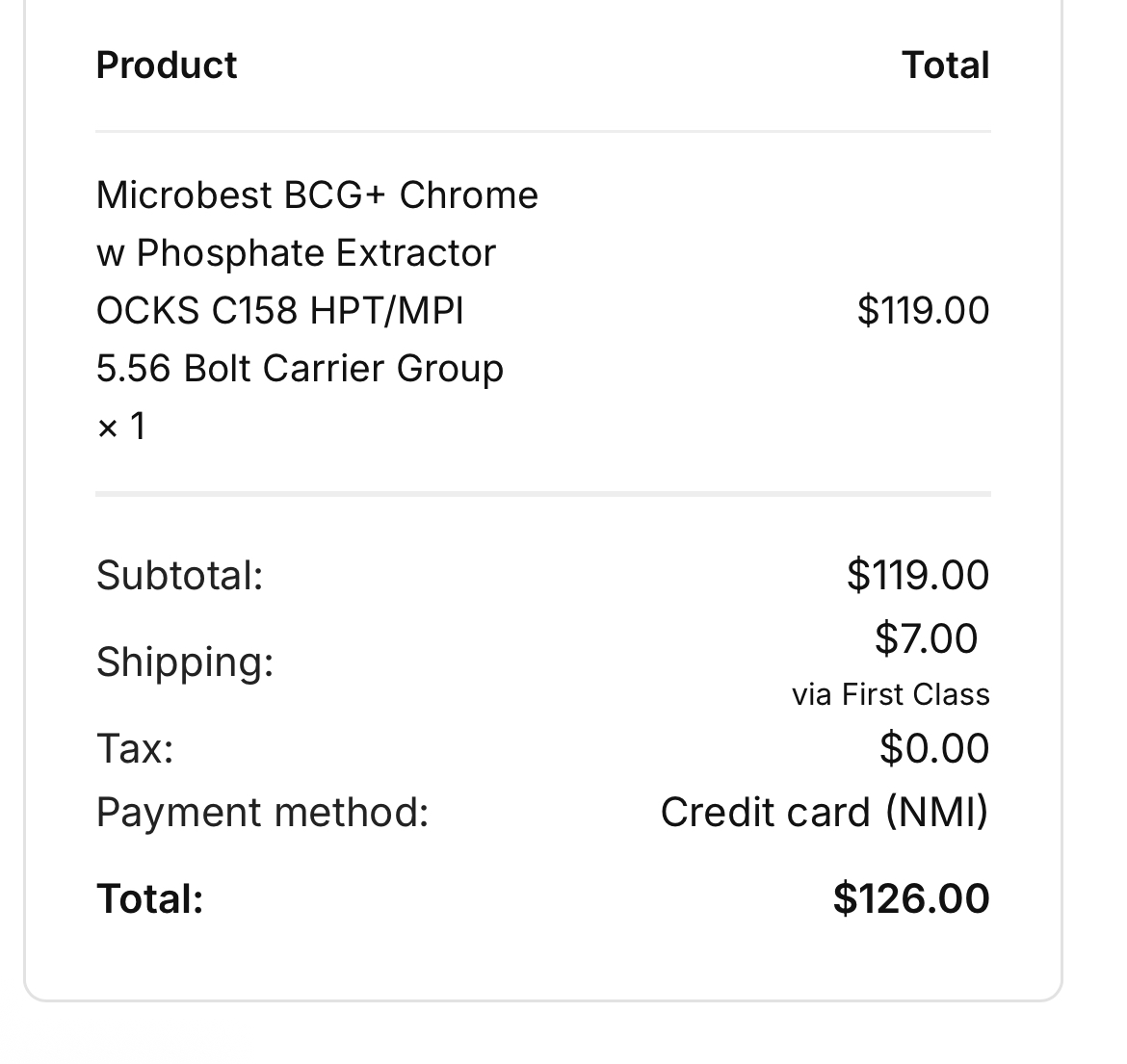

Just grabbed one of these for a build…holy smokes these are great value for the $$$.
$126 with shipping and tax!!
