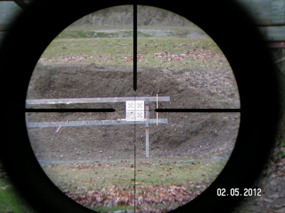

The SS 3-9x would be a winner too, with the 10 mils of holdover in the mil-quad reticle. I also think the 2.5-10x44 PST is better than people give it credit for, and is a pretty good value.
Call me nutty, but I really like the Falcon Menace 1.5-5x30 for being mil/mil and having a whopping 20 mils of holdover in the reticle, and its illuminated.... and pretty inexpensive.
Here is the mil-quad at 6x at 100 yards...because i can't seem to delete it for some reason...
