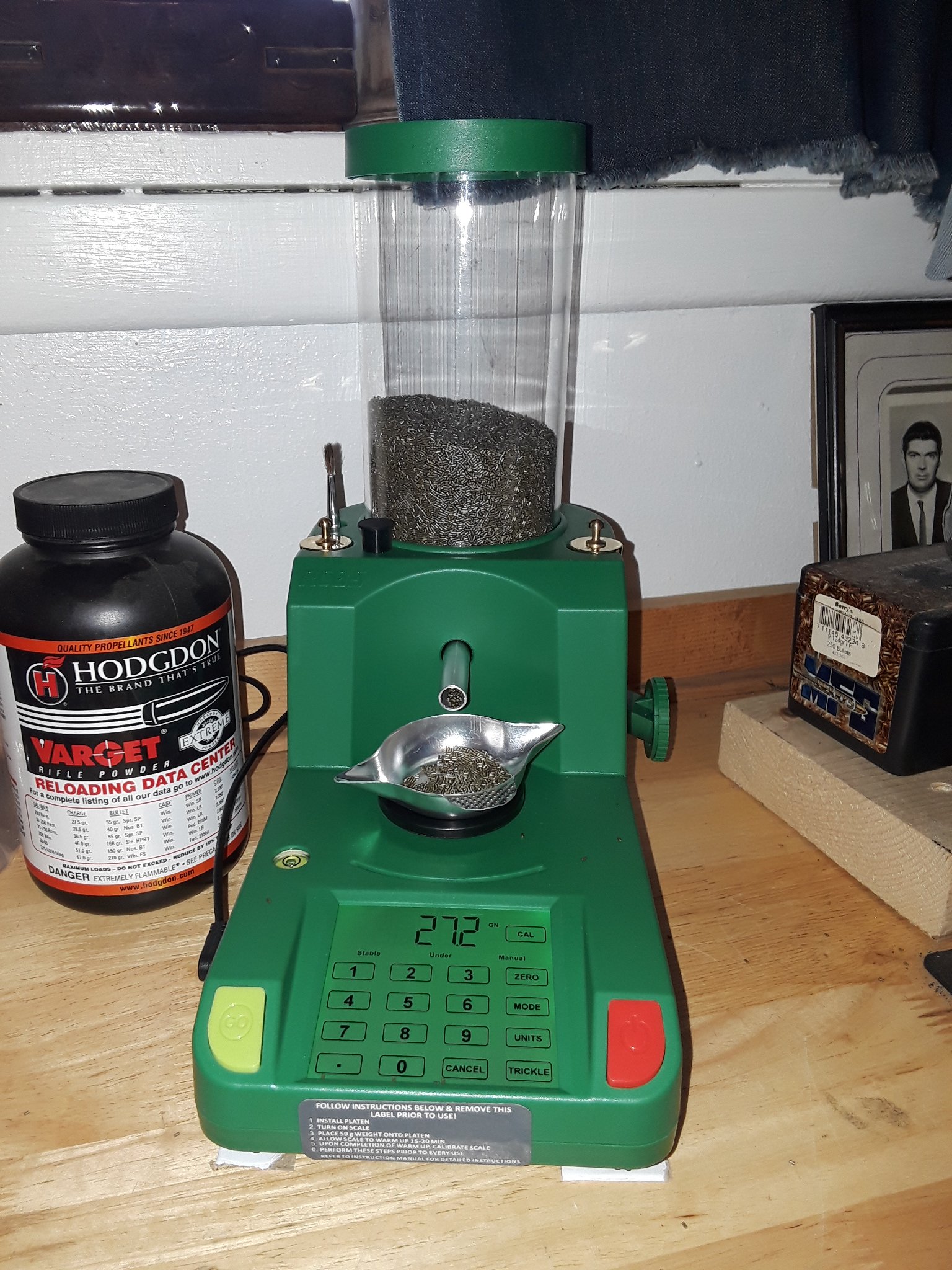

Order placed late nite Thursday could have been past midnite.
Natches had a sale.
Sunday before noon my my RCBS cm lite arrived. By 4PM I have setup calibrated and tested it against my existing Lyman scale only.
For the price paid this is great.
Exact match on every weight checked and load thrown.
My temperature in the house was dropping and it fluctuated by 0.1 on the throw and my other scale also fluctuated the same 0.1 in less than a minute.
Reset both and closed the damn back door. Niether have budged since.
Last time I buy a hornady, they are finicky and drift more often. They are also vibration sensitive and the Cml has not moved with repetitive bumping of the bench.
About 45 loads checked I'm satisfied.
At the moment next level want's succome to practical needs.
If 0.1 will suffice this is a nice unit.
