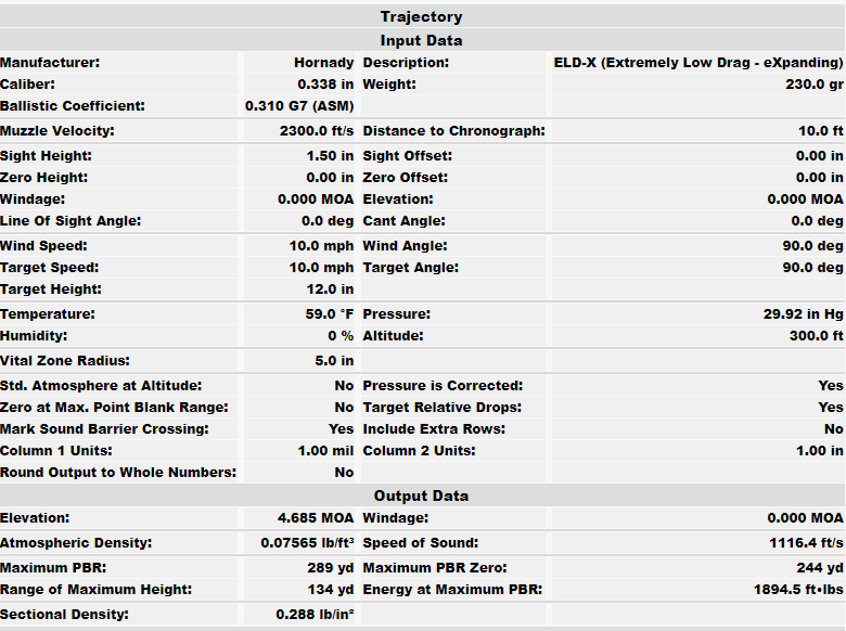

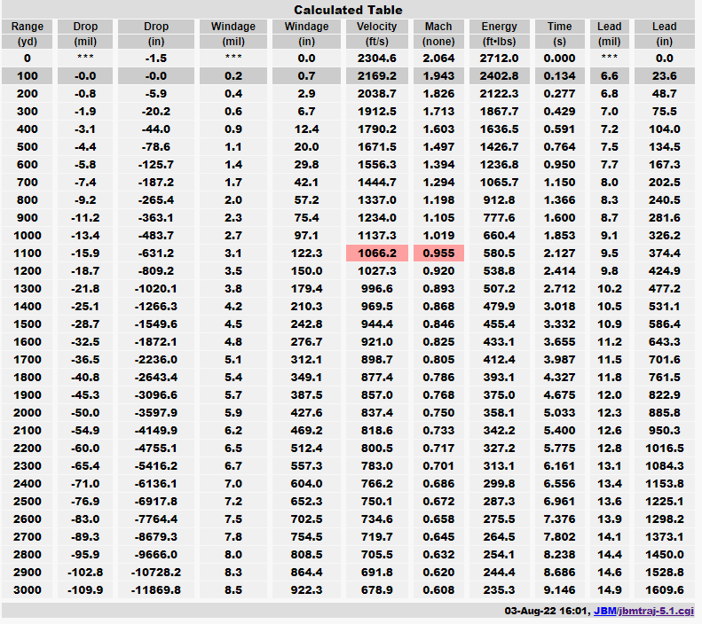

I ran the numbers for you because I'm twiddling my thumbs right now:
250s may be a bit too much. Here's a 230gr ELD-X going just under 2400fps out of a 26" barrel. Ballistics look like this:
Not great.
Reactions: wildcats

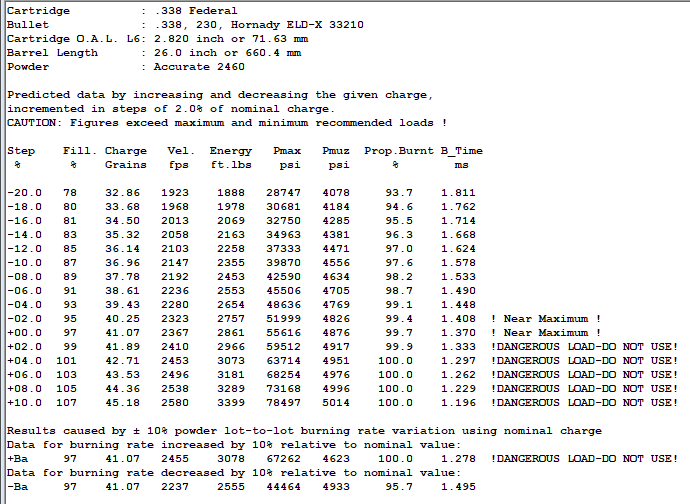

JBM... glossing over that, the loads are a bit conservative compared to published loads. With a drive band solid (assuming you could fit one to mag length) you would likely be able to go faster than most published loads.
In either case, look at the energy differential between 338 Federal and 260 or 308 at range.

Maybe someone who loads for 338 Federal can chime in just for the sake of verifying factory published data. The above numbers look light to me but I've never loaded for it so I don't know.

Hongdon data says that 225gr bullets at a bit over 2500 fps is doable in 338 Federal. With a ELR appropriate bullet, that may be hard to manage with mag length loads since the limits are going to be case capacity rather than pressure for most powders. Would be nice to hear someone with some experience in 338 Federal chime in. I'm aware of it but have never actually seen one and a paper solution is only so useful.
-Alex
After looking into some load development, 2350-2400 fps is prolly a lot more realistic for anything in a 250 range with 26" barrel, considering its a gas gun and longer bullets eating case capacity to work in a mag.
