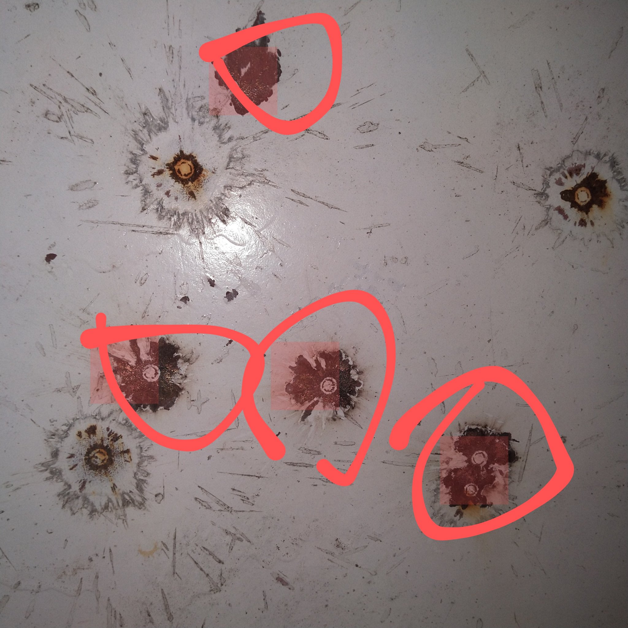

The strings are all still on the magnetospeed archived , I know the ES was 9 fps , whether or not the weight sorting of the primers had any effect or not they worked, and are still working well enough to put the rifle on the podium at King. Statistically it's cleaning targets and thats all that counts in the end, and the groups at 2000 yards don't lie. 2 five round groups at 1985 yards last weekend and the largest has 7" of vertical dispersion. The attached image was 5 rounds at 1751 yards 3 days before I left for King of 2 Miles..... Something is working.
