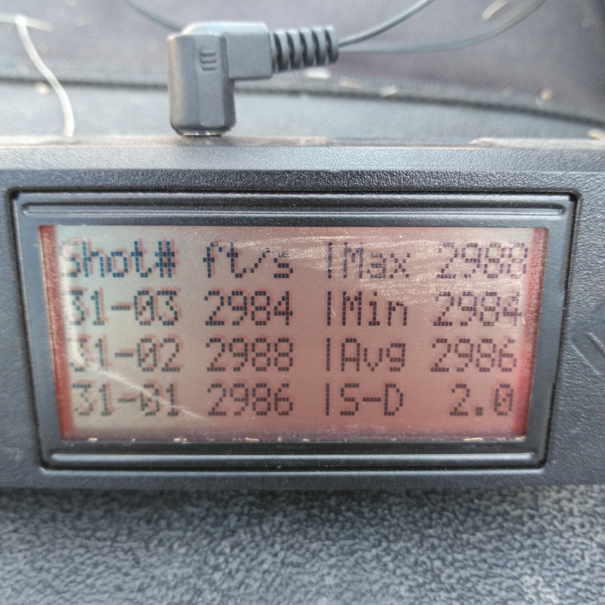

I know , I know , it's only three shots , but this is one of the only pictures I have of the magnetospeed with SD shown .

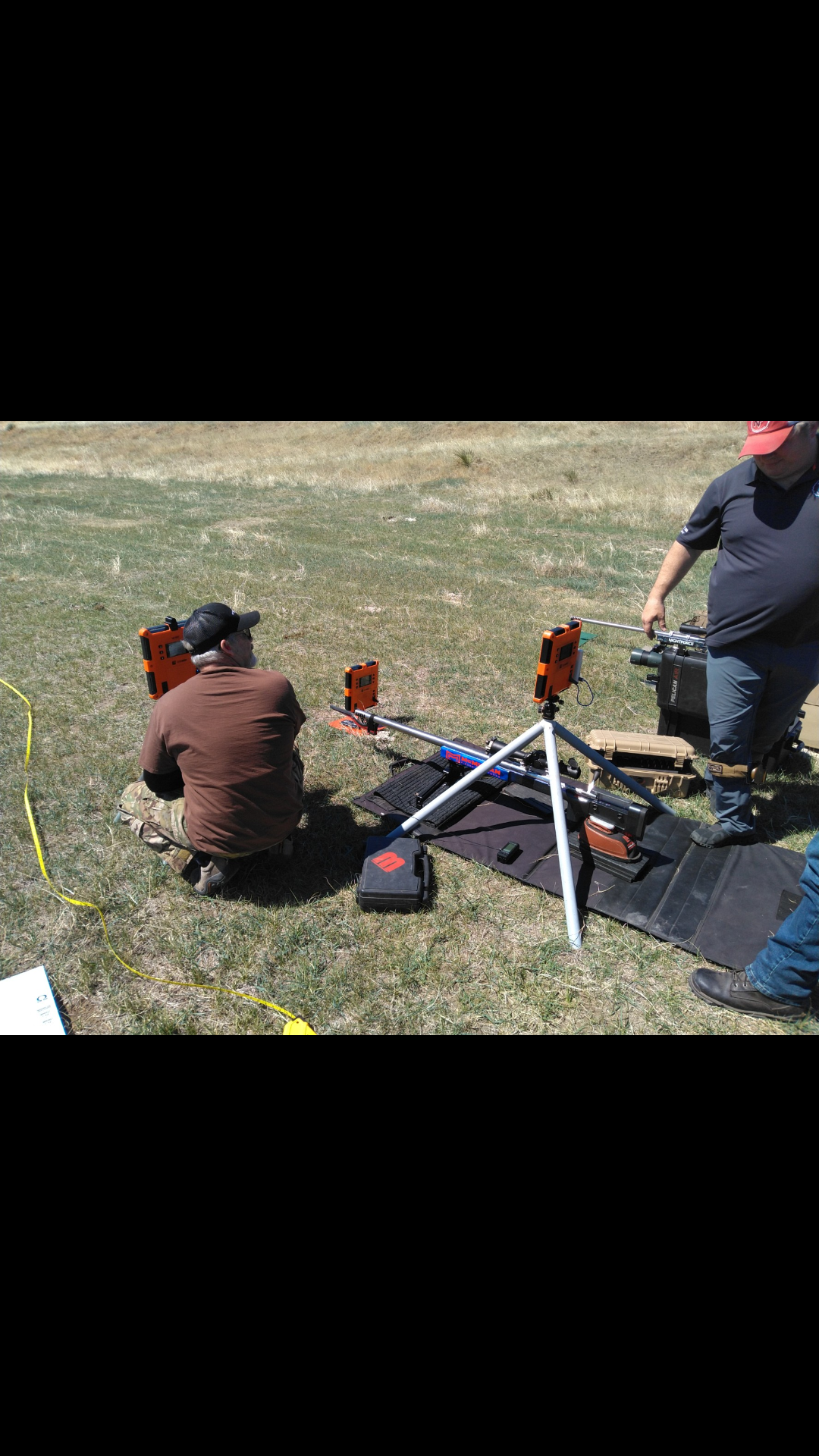

2021 with Paul and Brian prior to Clarks knob we tested 3 Labradars and a magnetospeed at the same time for comparison sake on my 375 Hellfire running 400 Lazers at 3280fps . Across 9 rounds 3, 3 shot strings all four chronos showed 2fps ES .

Chances are , lmao ,I might be. And as I mentioned that was about the only picture of an SD readout that I had. The amount of podiums and big match wins the last few years has brought me seems to say what I'm doing must be close to being right .

The strings are all still on the magnetospeed archived , I know the ES was 9 fps , whether or not the weight sorting of the primers had any effect or not they worked, and are still working well enough to put the rifle on the podium at King. Statistically it's cleaning targets and thats all that counts in the end, and the groups at 2000 yards don't lie. 2 five round groups at 1985 yards last weekend and the largest has 7" of vertical dispersion. The attached image was 5 rounds at 1751 yards 3 days before I left for King of 2 Miles..... Something is working.

To each their own, first rifle I went with was a Savage 110BA in 338LM with a Leupold Mark 4 8.5-25x50 with M5 turrets. Had alot of fun and was a solid rifle to learn on, ended up keeping it and upgraded the barrel after the original was shot out. We also did some minor stuff like changing to a timney trigger and glass bedding the rifle.
Next rifle I picked up was my dream 50bmg which is ok on accuracy (barely sub moa) but it wasn’t really intended for any kind of competitions and was just a fun gun id always wanted. Next real ELR I ended up buying was a Seekins havak in 300prc but it’s for hunting not competitions and was designed that way. Finally I settled on a custom 375CT built on a Lawton action that was a new rifle build, still working on getting set up for reloading but so far I only have one complaint but that’ll get fixed once I go to a faster twist to handle longer high bc bullets. For glass I ended up moving the Mark4 to the 50bmg and put NF atacr 5-25x56 on the 338LM and 375CT. My journey down the rabbit hole was aided by starting out shooting bench back in the mid 90s, what it takes to shoot 1k is so easy now and much cheaper.
