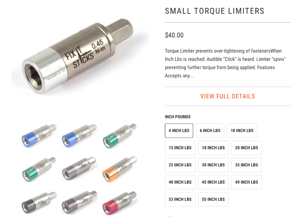

I have multiple custom kits I ordered from Fix-It-Sticks with the attachments and torque limiters I wanted. Been using it for years.
I would like to correct that Borka Tools is the only source for custom kits, if necessary...
I do have a question - did you purchase individual components from FIS to build your custom kit(s) by yourself, or FIS just took your order and then delivered a custom kit with everything you've specified?
I could not find any info on FIS website that they will ship a custom kit, specified by individual user. May be I was not looking in a right place, not sure...
At the moment, Borka Tools is the only source for custom precision torque limiter (PTL) kits both for individuals and OEMs. Fix It Sticks can certainly offer custom kits for OEMs, but they do not yet publicly offer custom kits for individuals, at least on their website. Borka prices for custom kits are the same as for the standard (off-the shelf) kits, lead time is no more than 3 business days.
I specified what parts I wanted in my kits and they sent me the kits with exactly what I ordered in a small, tough zipper case.
Reactions: kindabitey
Thank you very much for clarification.
Borka Tools offers custom (user specified) PTL kits since 2014.
Seems like it would be beneficial for FIS to publically offer such service on their website under "Categories" menu.
Reactions: padom
