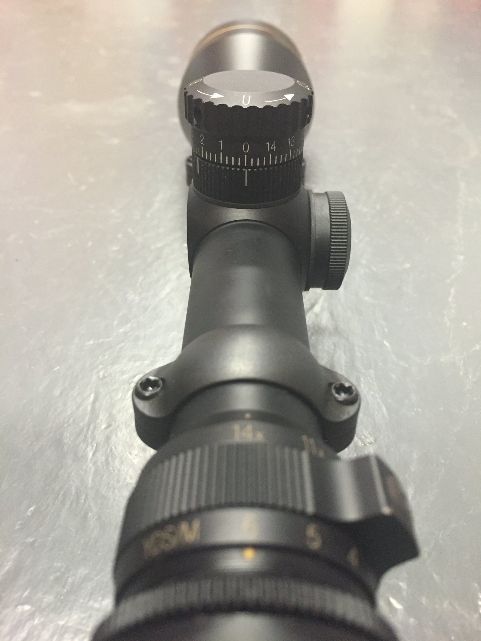

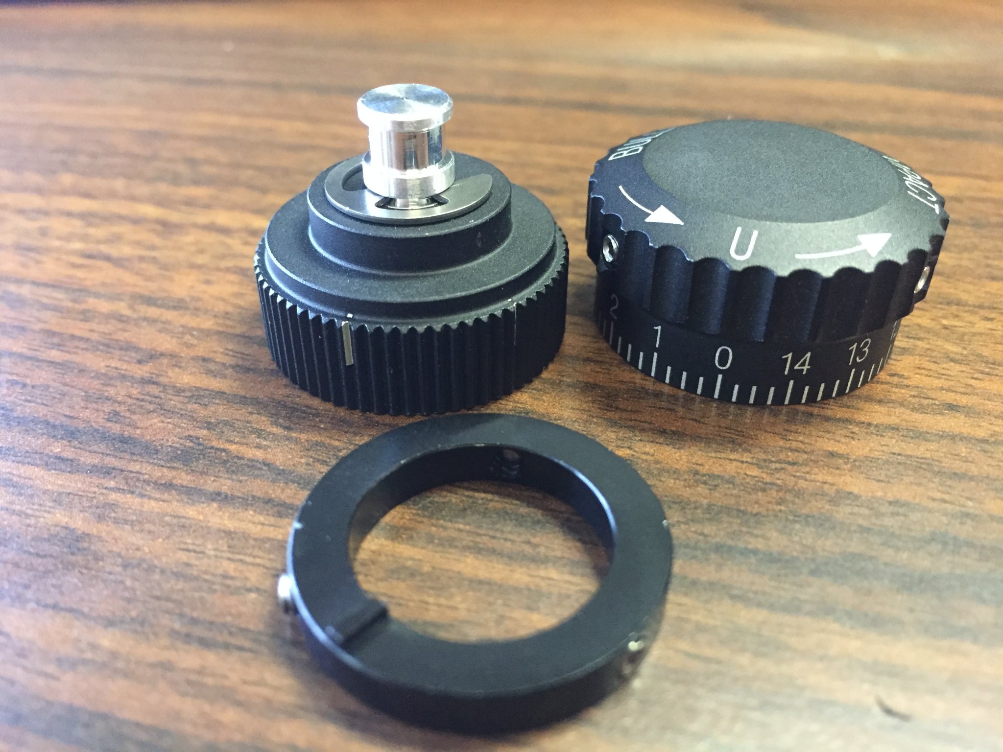

did you have to send your scope back to leupold? If not where did you buy the dial?
Nope, just call the custom shop and ask for them, they just replace the cap with the top left piece while the silver tower fits into the turret slot to allow for external adjustment via the top right numbered piece. The bottom part is the zero stop bump.
They come in single turn w/ zero stop or in multi turn w/out zero stop.
If you don’t put the top numbered cap allllll the way down on the single turn zero stop model but just up a smidge you can still feel the zero stop bump but you’re able to slide over the top to get more than one revolution.
They were like 70 bucks when I got them a few years ago, not sure what they are now.
that’s awesome, thanks a lot that’s definitely what I’m going to do with all my other scopes now!!
It’s not the most elegant thing but it’s an easy upgrade that helps me to keep using a scope that would otherwise have gotten regulated to the shelf for lack or turrets.
I wouldn’t buy a scopes with the sole intention of adding the sod turret, I’d rather get one that comes with a turret but if you already have one or you find a steal on one it’s worth a shot.
