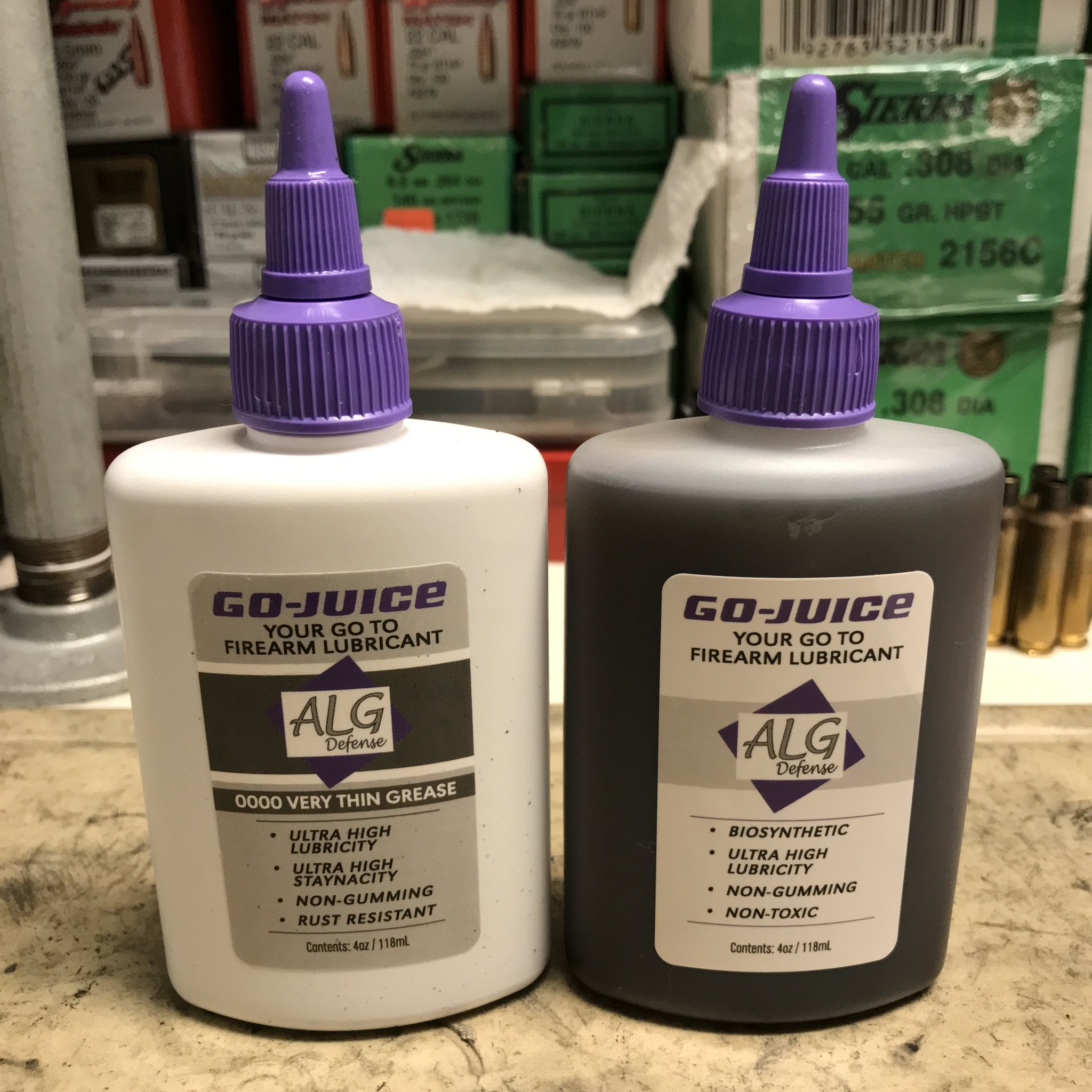

Both of these address most of my requirements, but agree that all surfaces should be square to each other.
