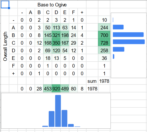

If you sort by OAL and BTO using a SortEez, and plug the numbers into a spreadsheet, you can get a pretty good idea of the overall distribution of the bullets. This was for a particular batch of Berger 200.20X .30 cal bullets (lot #D24). Bins were (IIRC) 0.003" for OAL, and 0.001" for BTO.

Yes, I've done it for a while now.
It really only makes sense if you can get a nice big lot of bullets, several thousand at a time. I'll length sort them into usually 5 piles, the middle piles will be the largest and the shortest and longest bullet piles will be relatively small. Sorting goes fairly quick, maybe 45 minutes per 1k? Something to do in the evening in front of the TV.
I'll then point the bullets starting with the longest and work my way toward the shortest, adjusting the die as I move through each pile. You definitely notice a difference in pointing effort between the long and short bullets if you don't change the die settings, short bullets will be just barely kissed by the die where the long bullet has some resistance. Sorting helps even this out.
If I do a nice big pile like 3-4k I can just leave them in gallon ziploc bags and shoot them separate... work my way through "Longest" pile then shoot the "Middle-long" then the "Middle"... etc etc. Takes a day or two to sort but then I can shoot them over the course of a season.
