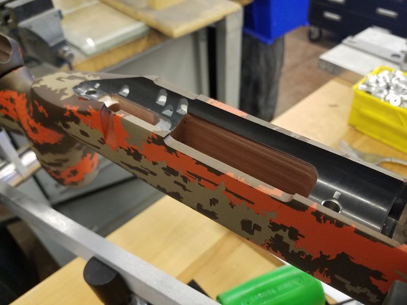

    With a careful prep work, this can be achieved at home:
    18056348_1329622973799124_7192998469971389076_o.jpg?oh=ea2038f902457936e56cb0082ea1270b&oe=599...jpg
    Good luck on your project.
    C.

    Beautiful bedding job !!
