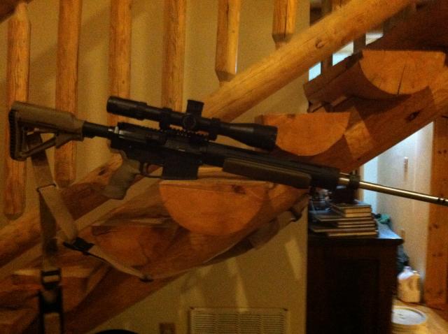

Not a GAP 10 but for aesthetics here is what a PMII looks like size wise on a .308 AR10
Such a shame such fine equipment is subject to my meager skills. My round count is low (5-600) but so far no scope issues due to recoil and I dont expect any.

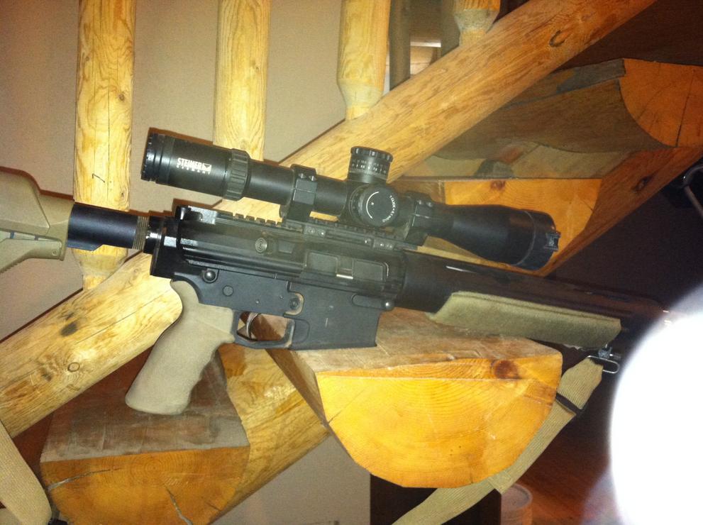

Nice gun and scope. What mount is that?
And will a one piece mount be required for the GAP or can I use conventional rings? I'm getting ready to order the scope and mounts soon, so want to be sure i get the correct setup.
Thanks all for the replies......
It's a Spuhr mount. You won't need to go one piece on your rifle. With the mono rail on the LMT I wasn't concerned about bridging from the upper to the handguard. Think about whether or not you will need a cantilever to obtain eye relief.
The mount is a Spuhr.

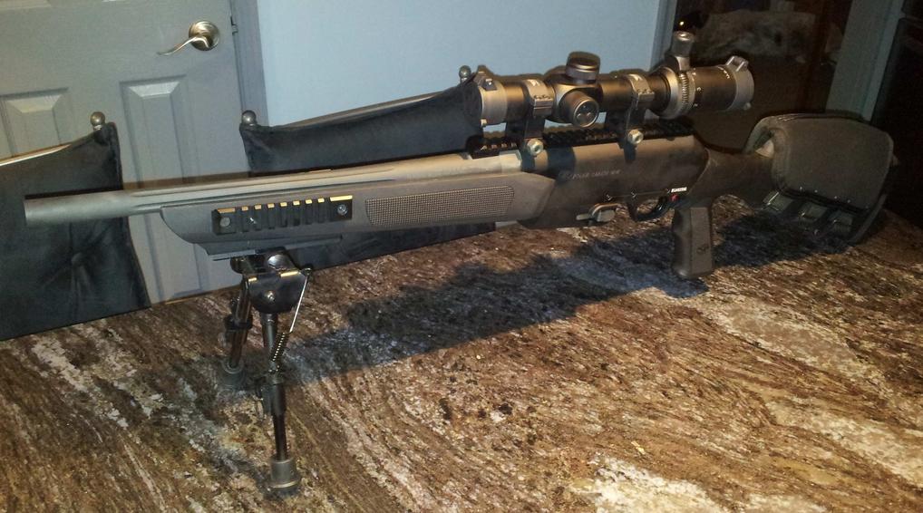

I have a 16" FNAR, FNH's .308/7.62x51 autoloader, which I think is pretty close in function and size to an AR-10 variant.
I went the other way and mounted up a USO SR-8s.
Without the bipod, the rifle weighs 12 lbs. with 20 rounds of ammo on board and handles great from the shoulder.
At some point I'll look for some medium rings so I can ditch the stock pack without losing my cheek weld.
Joe
Nice rig. But its not an AR10.
