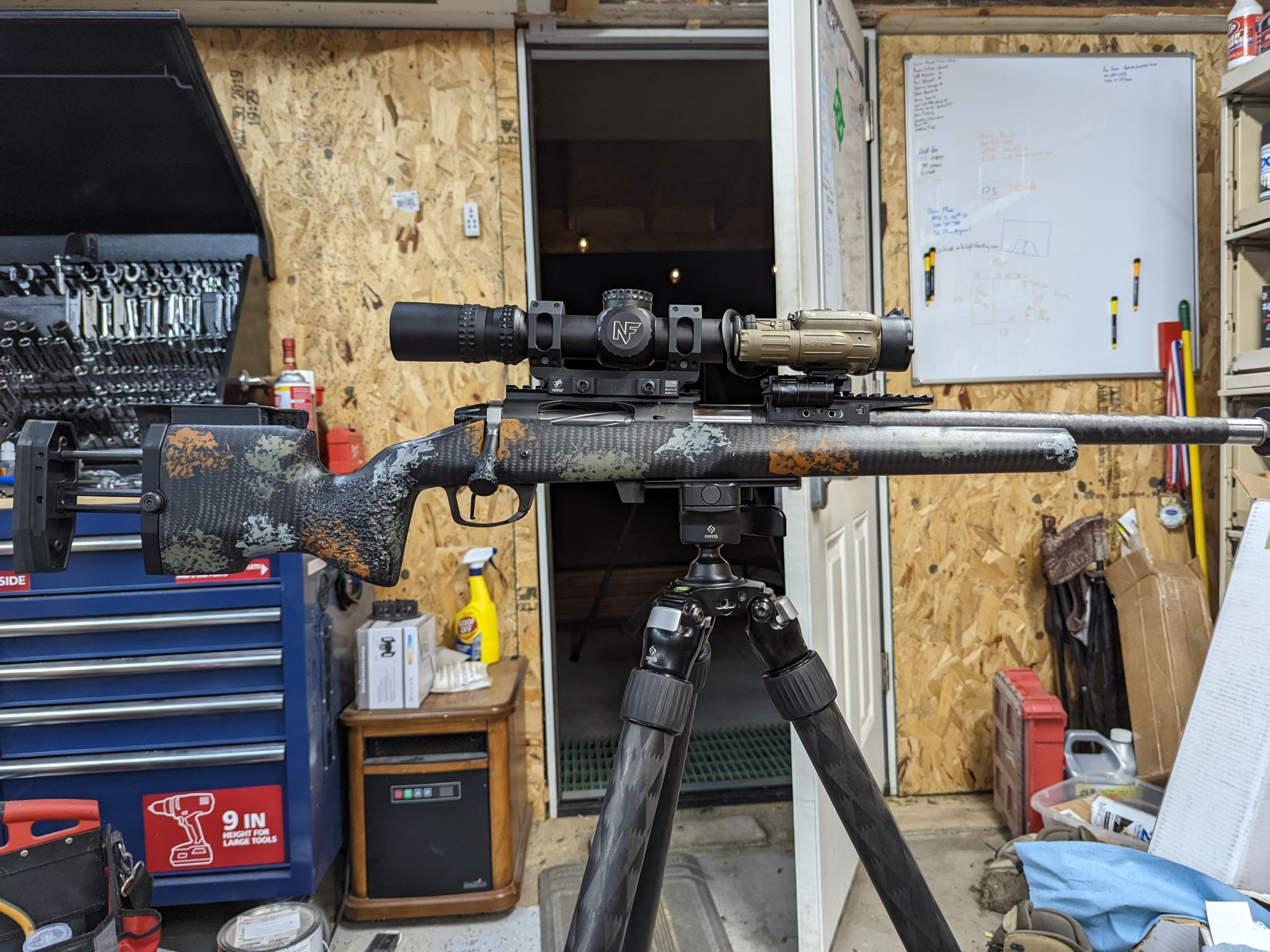

    Badger is one option. The other is to commission a machinist to build you a long one-piece scope rail and use that. The last option is the Spuhr NV mount.
    So far, I'm happiest with this

    A quick update to the thread:
    Mounting a clip-on thermal in front of a day optic on a conventionally stocked rifle is a huge pain in the ass. Getting the height right is not an easy prospect, and significant deviations from centerline alignment cause image shifts that will require tracking 2 very dissimilar zeros.
    On an AR, easy; on something without a full rail, making minor adjustments in height of day scope or thermal is not at all easy.
    All that said, the advantages of the clip-on are still awesome compared to double-rifling all my efforts.
    Once the hunting season is behind me, my HTG will be going somewhere for a Badger rail up front, if I can find the parts and someone I trust to do the work...
