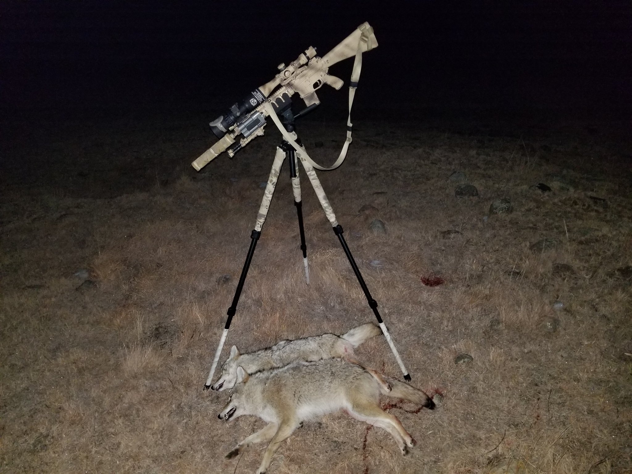

Interesting ... as for that sort of use case ... I wouldn't consider anything BUT a clipon. If I am going long, I want to use my day reticles!
6.5G(18) with L&S Mk6 3-18x Tremor-3 UTC-x ... off a tripod. After 700yds I'd rather be sitting with the tripod than standing ... and 123 ELD goes transonic at 740yds ... and subsonic at 980yds ... but with more gun ...
like .300WM(24) can stretch further ... though yotes are often not standing still, so yote shots beyond 500yds will be a challenge.
But yeah, for me, the only use case for thermal clipons is long distance ... for under 350yds I prefer dedicated scopes ... then the critter is the reticle and don't need the day scope reticle.

I've been using the refurb PVS-30 and a cheaper handheld thermal (pulsar xq38) for the last winter. First time ever night hunting and I think the setup worked well. An illuminator helped alot on no moon nights plus makes their eyes glow.
I tried using the rifle and pvs30 only but the narrow field of view and the constant need to be on the gun and staring into the light with one eye wasn't ideal. Bought the handheld within a week of trying to just use the clipon. Now I can stand and rotate without moving my feet much and see 360 degrees around me.

So Rinky's setup above is a good example of field use of day scope, clipon, rifle, tripod and range finder mounted on the 9. Here is another example. Pitch Black Precision (KSE and company) ...
SIMRAD on top, RRS tripod and looks to me like a custom shroud on a T-67 illuminator ...
Heavy-ish rifles work in the field off tripods !
