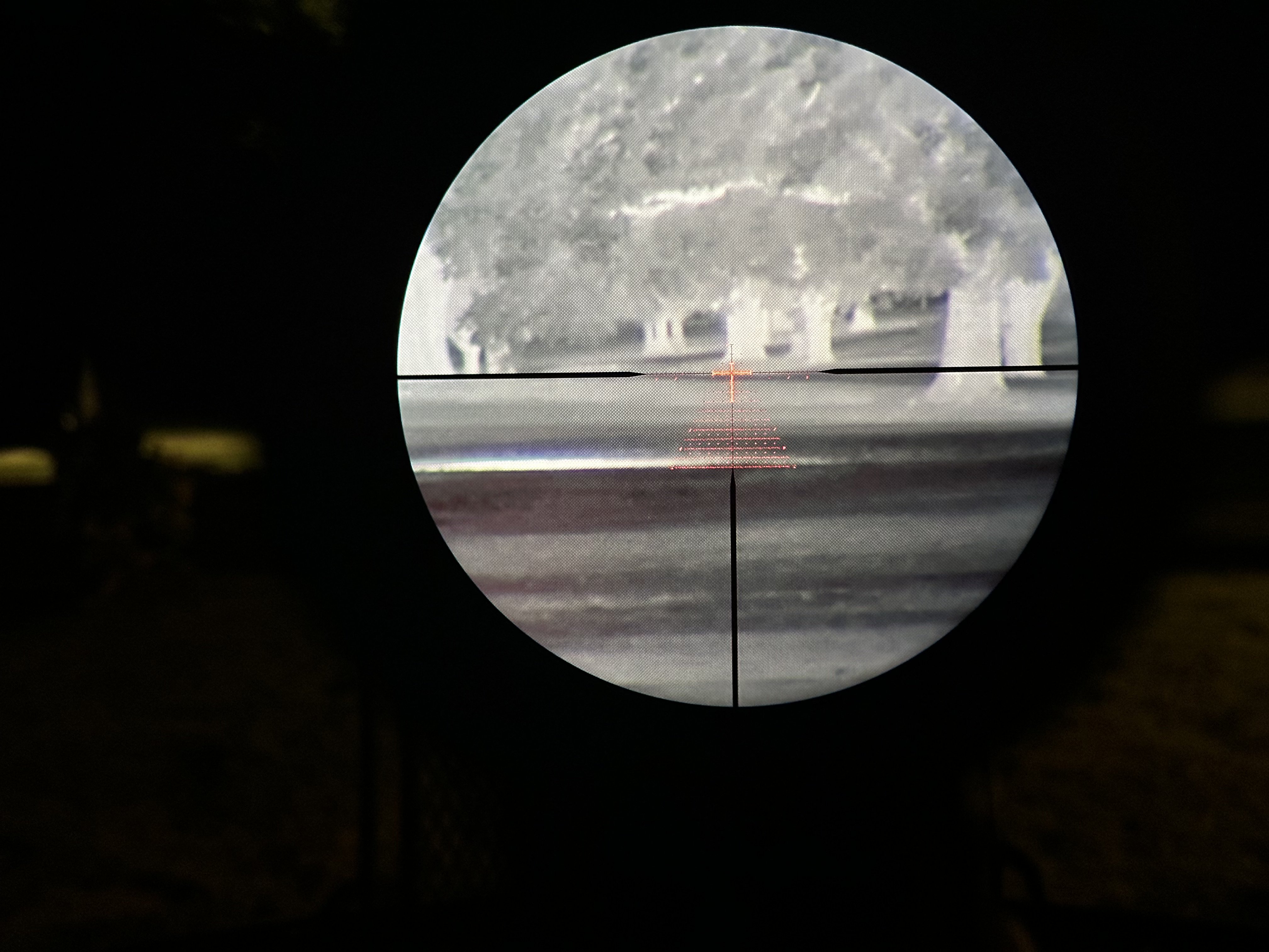

    I took this tonight with my phone 371yds 75% humidity Steiner 2-12 is at 6x. Thus far I’m extremely impressed

    @5RWill this is behind the Guide TB630?
