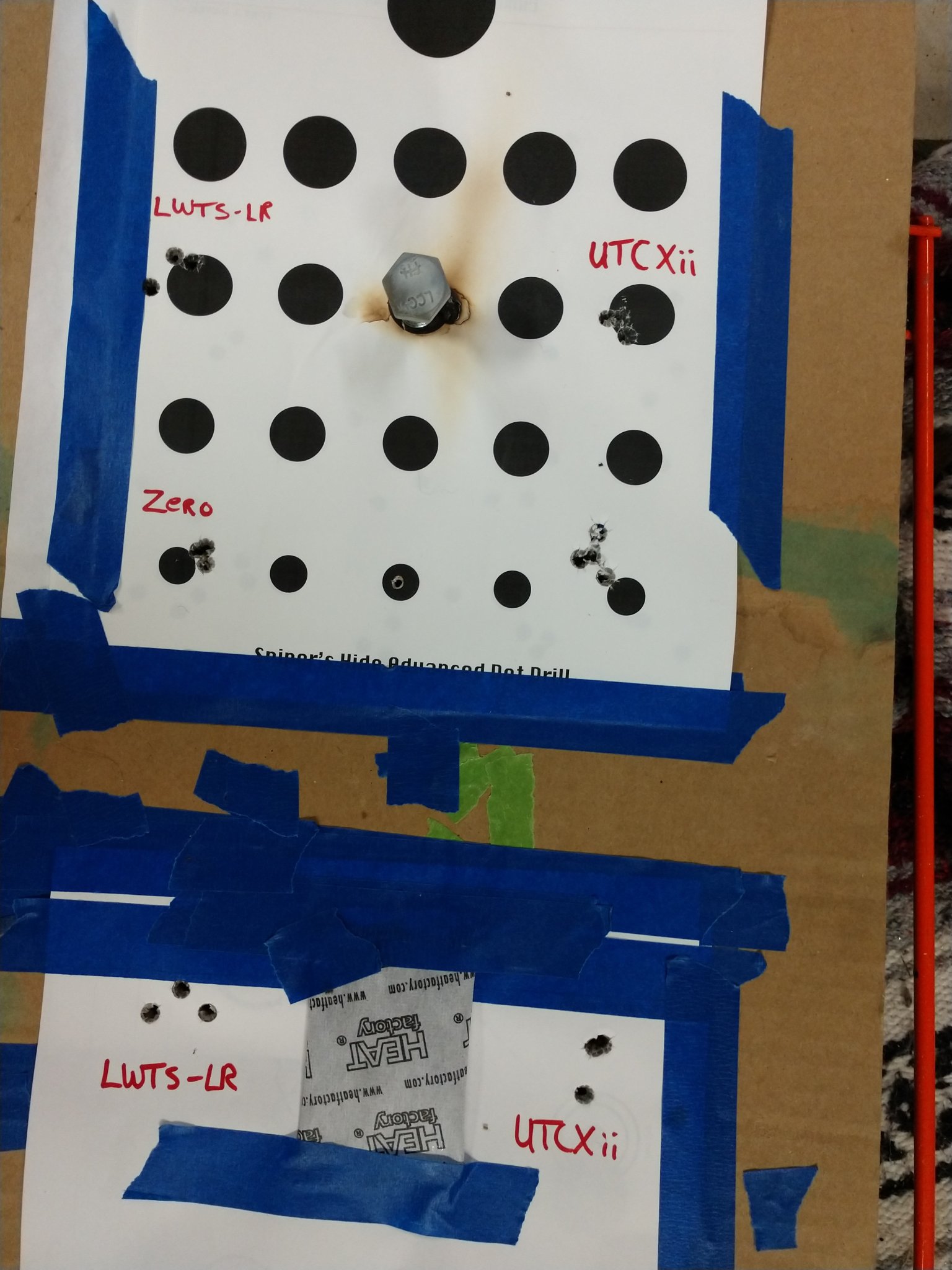

Shit, my UTCxii will shift like crazy with angle and height changes but I've been told by engineers that's a product of the weird eyepiece design more than anything. Which would make sense why my lwts-lr with its large wide eyepiece was always dead nuts even on canted rails and multiple systems.
I can attest to this. I have tested the collimation on these two units. The LWTS-LR consistently gave me zero shift whereas the UTC gave me a .3L shift. I always attributed that shift for the mount height difference, UTC being 1.33" and my scope mount and LWTS-LR being 1.5". Would assume that for the UTC, that sweet spot on top of that convex lens is just physically smaller. I actually recalibrated the collimation on my UTC from the factory settings. The best I could tell each click value is .15mil movement of collimation. With the new collimation settings my UTC has had zero shift for my setups.
100% it is the eyepiece and that's why they leave that ability in there.....of course with "proceed with caution "warnings that you're messing with the factory collimation.
