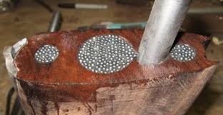

Their is always this method..steel shot.i've seen it done on forends with epoxy mix.
This is what my dad did to the single shot Winchester 370 I had to tote when I was 8. It made it heavier but it sure kept it from knocking me on my ass when I shot it. The loose shot works better for eliminating recoil too.

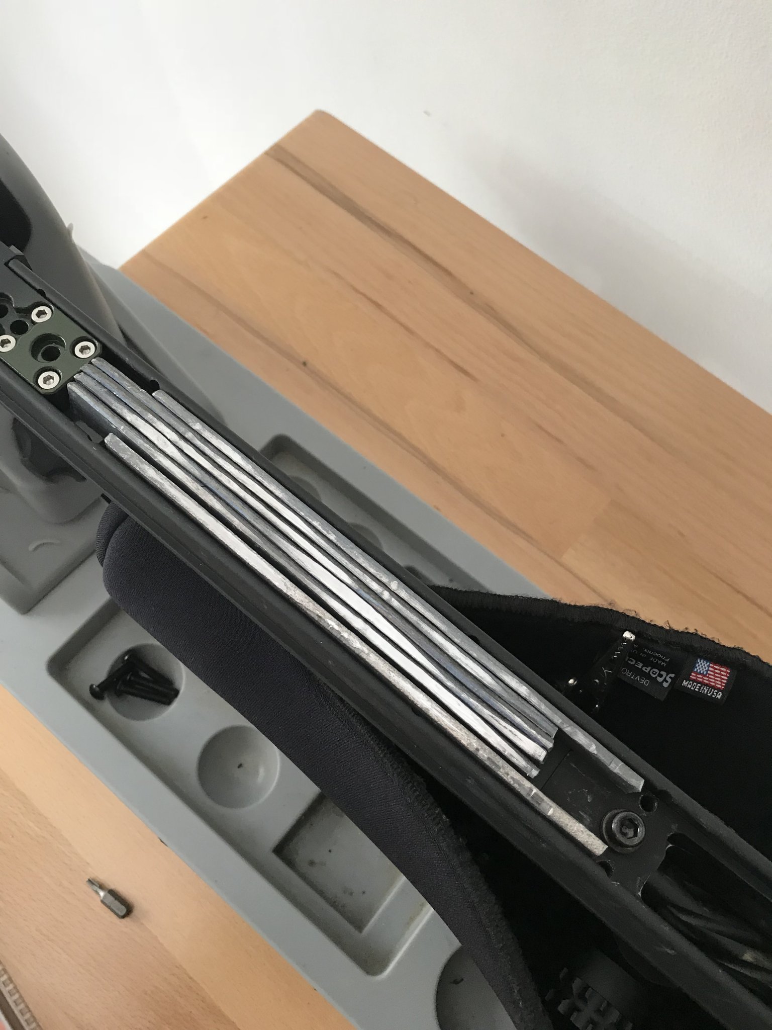

Alright gentleman, this is my final product after messing around with going back and forth for 2 weeks. Adding weight to rear, grip, and butthook, I lined the cavity with Saran Wrap and took #8 shot from shotgun shells, and covered it with excess Saran Wrap. As for the fore end, I went from adhesive wheel weights, to double sided tape and Saran wrapped #8 shot, to now and ending with lead decoy weights from academy. 3.5 oz each strip and had to trim to fit accordingly. Double sided tape to channel. Good thing with this lead, it’s soft enough to cut.

Alright gentleman, this is my final product after messing around with going back and forth for 2 weeks. Adding weight to rear, grip, and butthook, I lined the cavity with Saran Wrap and took #8 shot from shotgun shells, and covered it with excess Saran Wrap. As for the fore end, I went from adhesive wheel weights, to double sided tape and Saran wrapped #8 shot, to now and ending with lead decoy weights from academy. 3.5 oz each strip and had to trim to fit accordingly. Good thing with this lead, it’s soft enough to cut.
Sounds like it should work well. Let us know how it goes!
how much did you have to cut off? and how did you cut it?
I only needed to cut the 4 middle strips off about 1/2" just because I couldn't get the plastic hand guard on. it's really soft, I was able to use some old pruning shears, but I'm thinking any sort of decent wire cutters would work fine. you will be surprised how soft this lead is bc when we use it for hunting, we are able to wrap the strips around our decoys keel or heads
dude!! Those are perfect in a KRG backbone (both under the plastic and the other side...). I picked up a set from academy, and everything fits in perfectly. I just fit placed everything, but once I have everything lined up, I was going to just JB weld them all together, but its a perfect solution for cheap. Thanks for the recommendation.
Reactions: southerngolfer
No problem man! Like i said, I worked on this for 2 weeks and I wish I would of thought of this first. Glad u liked it. Good luck. Send me a pic of your bravo later when u get a chance.
