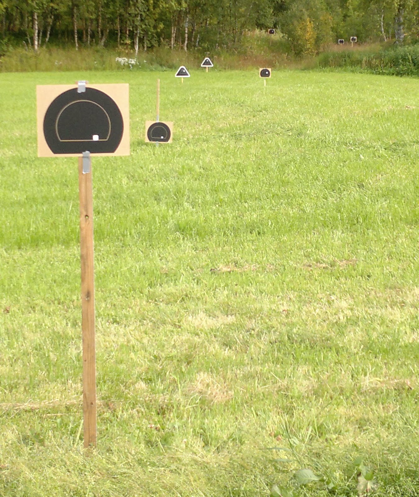

The test will be conducted with the following information.
Weapons: BRNO CZ 455 Varmint kal.22 LR.
Race Length: 525 mm
Scopes: Hawke Sport HD 3-9 * 50 AO Mil Dot.
Magnification ratio of binoculars: 9
Chronograph type: Crony M1.
Distance from the race to the chronograph: 140-150 cm
Distance from the race for indicators: 50 meters.
Temperature: 15-20 degrees.
Humidity: variable.
Wind Dir: Variable.
Wind mpp: Between 0 and 3 MPS.
Altitude: 184 masl
Shooter: Stig "Powder" Berntsen.
Secretary: ditto.
Photographer: ditto.

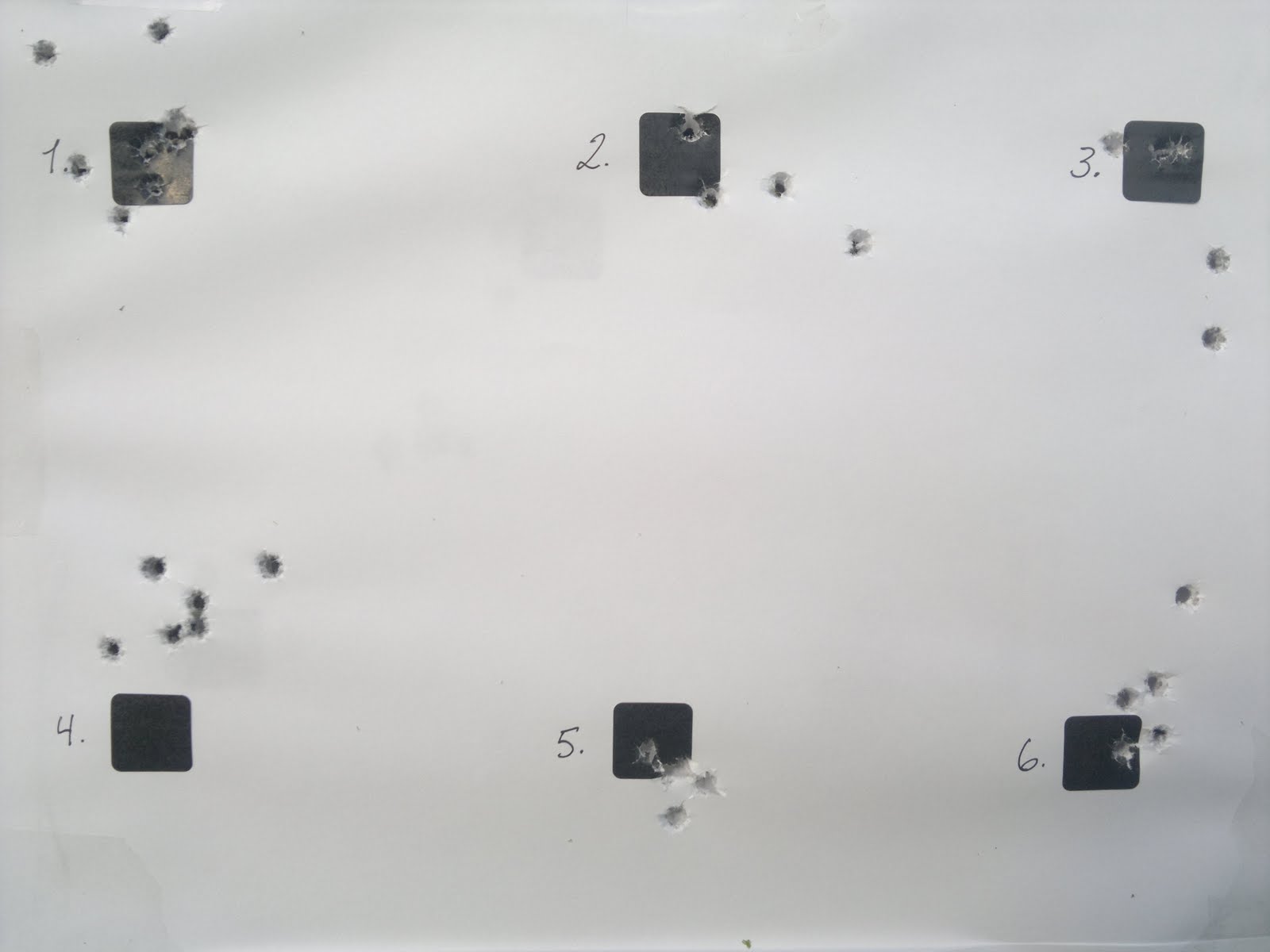

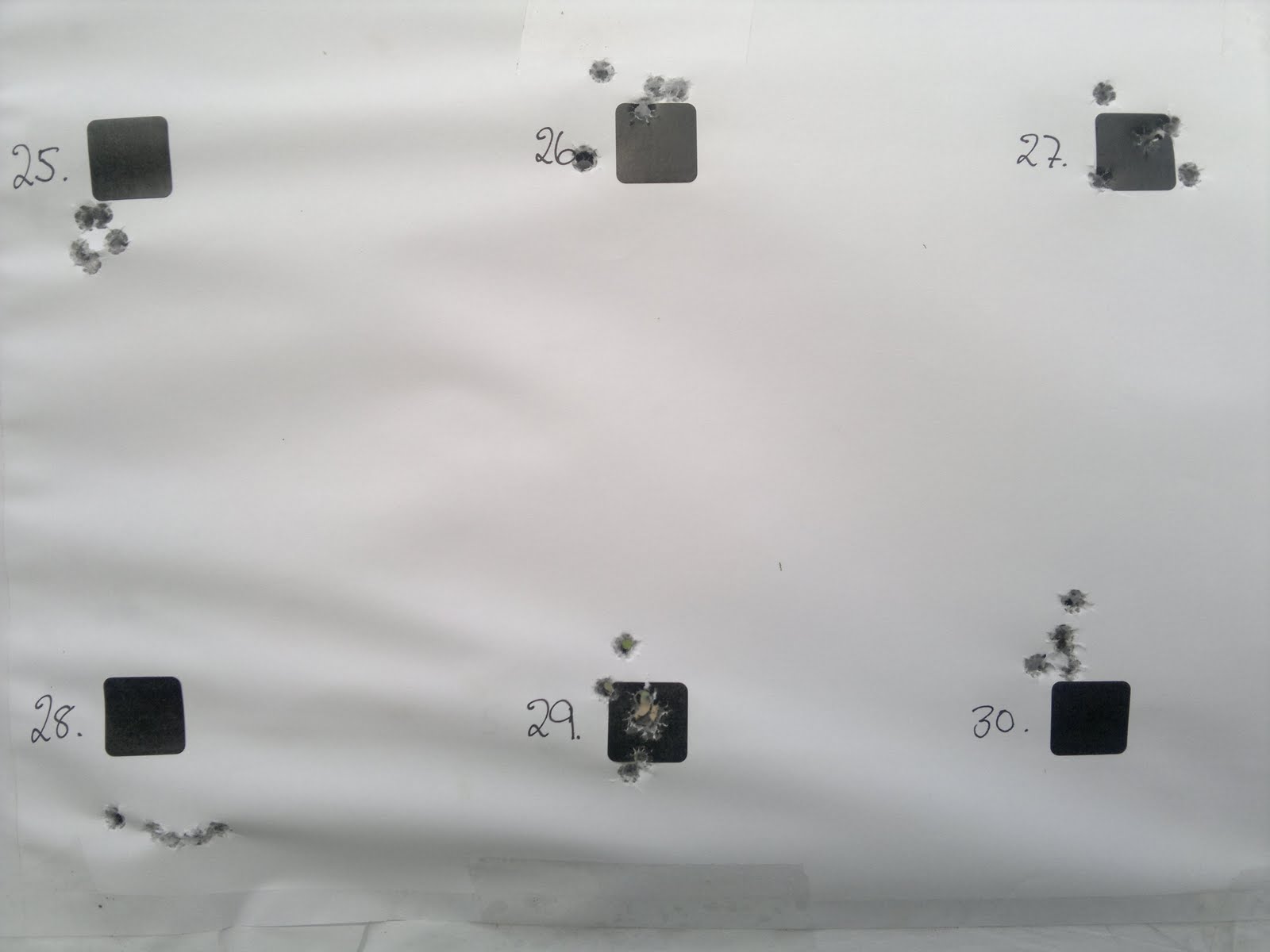

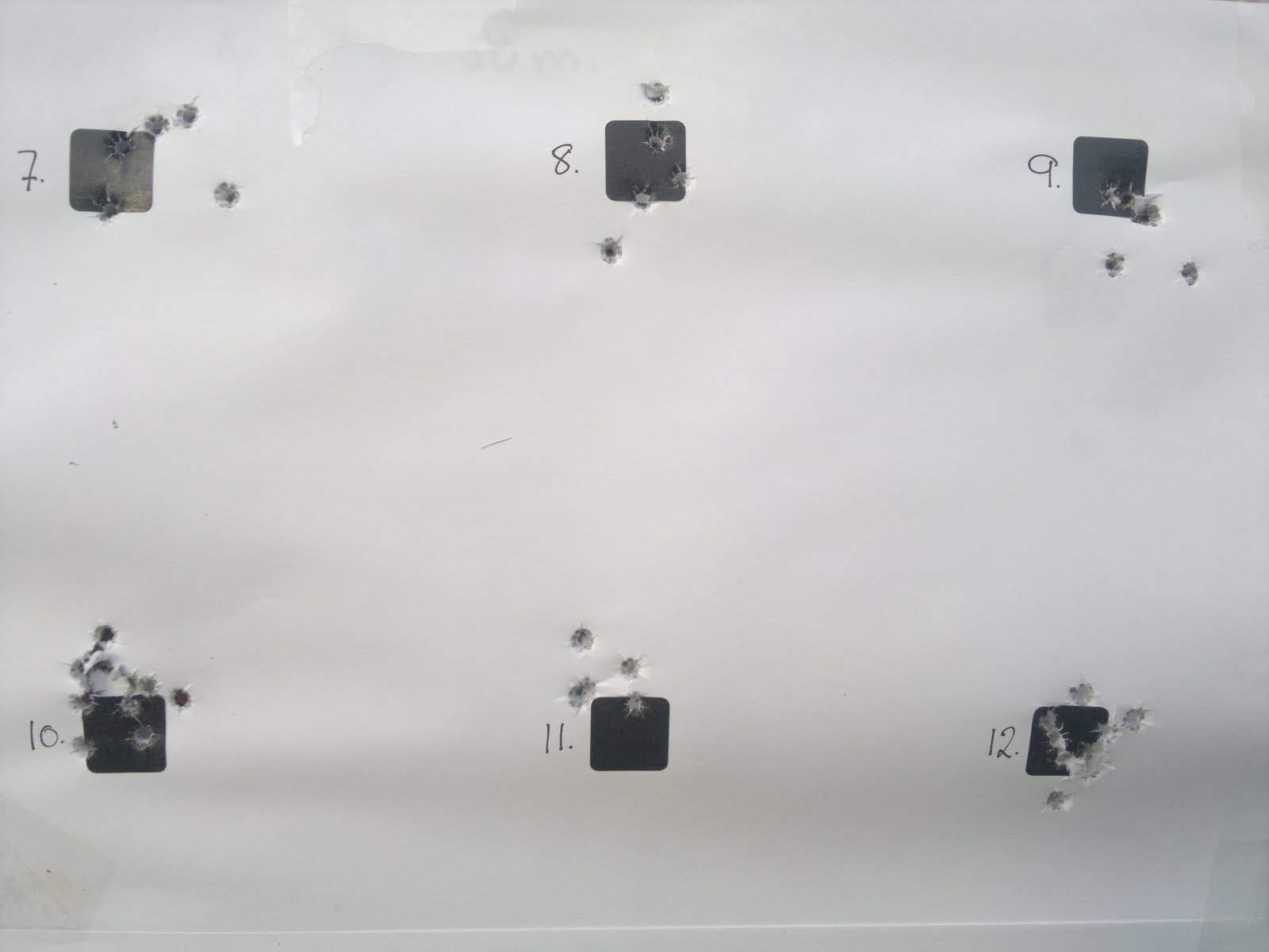

1. Weapons Puss. The rifle is polished so that it is clean, so I go 2 sanding plugs dipped in methylated spirit so that all oil disappear from the race. So I go dry cleaning stopper through the race to make sure that it is oil-free / dry.
2. Shoot as 5 shots with Lapua Standard Plus. The amo is pretty much wax on so that the butter over. Reason why I use this type of amo is that I have quite a few shots of it to hope this will give them different amotyper similar conditions to achieve in my arms.
3. So kronograferes 5 shots with the Symmetry to be tested with a shot on target. The results are listed down. These 10 shots, I hope is enough that the race is smeared across his lengde.slik that precision in the next step is representative of the current amo.
4. So you have to take a small break of 2-3 minutes so that any hot time in the given time to cool down.
5. Then 5 rounds of the respective amo pressisjonstestes on target with a distance of 50 meters.
6. During the test, so I took a few times a decision to shoot all 10 shots on target. this was a choice I made based on how I felt Symmetry performed during the first 5 shots them.
7. Repetition of step 1
This was what was planned, but I chose to shoot your first 5 shots on target. To perform them well, was your next 5 to shot on target. Blinken is in general a skivelappe of 18 mm * 18 mm.

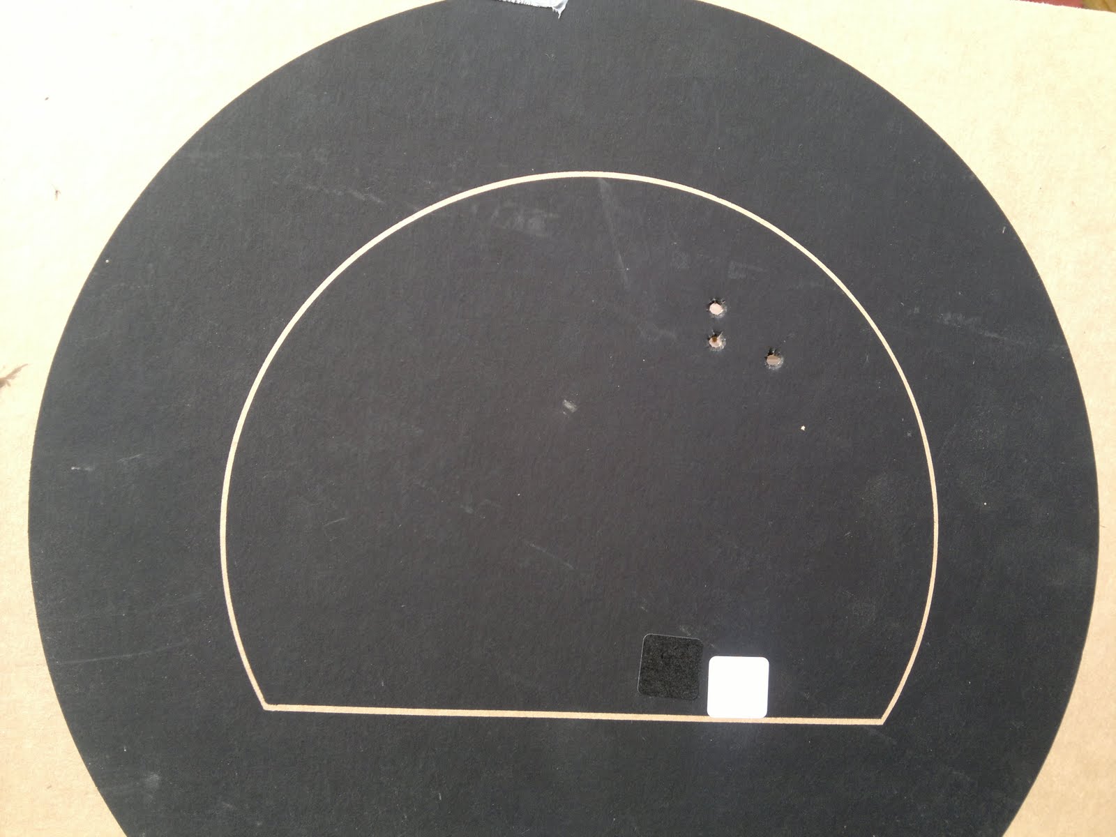

Here is my piercing with Lauper Standard Plus I godkjennte. This is not all the world's best amo, but ok for plinking, etc.
Not the best piercing, but Symmetry is not super.

Phu ... it was all the numbers from the test of the CZ 455
I post photos from all the targets I shot at.
I had a plan to add them chronologically out of every 6 amo-type, so that it could be a little easier to compare the results with pictures, but it was a mess when some of the pictures came up 2-3 lines high in the statistics from the test unfortunately. Sorry this.
Amo No.1-6. Was wealth only Fiocchi Maxac, No. 5, who had fine precision.
Amo No.7-12. Lapua Standard, No. 10 and Nr.12, Lapua Speed had 10 shots on target, with ok results.

Amo nr.25-30. Lapua Hollow Point, No. 29 had 10 shots on target. RWS Sub HP, nr.25 was good, but would need adjustment for my weapon. Lapua Midas +, nr.30 was ok.

Approximately 13 mm Collection of 10 shots .. Fiocchi Super Match 22LR Biathlon SM 340
Covered by a disc label.

I picked out a uvikårlig amotype that I had some extra shots with the shot in my rifle at 100 m.
So I set up the flashes of 37 m, 50 m, 77 m, 85 m, 100 m, 110 m, 120 m and 125 m.
Selected indicators on all the slices of white disc labels, to let me down and aimed at all the targets with a center aiming. Allså no over or under the holding of the viewpoint. This is to see if I could make out the ballistic ball path on the coffee rifle. I think I have blidd it, but only on the Symmetry. Symmetry I chose was RWS Dynamit Nobel 22 A amo which had an average of about 350 mpp in my CZ 455 I fired three shots at hvært hold. I must say as long as I do "work" behind my butt so all together this amo surprisingly good .. out of 125 m. However, how it falls.
"See Today-track" mi .. 8 range from 37 m to 125 m. Nice to live in a rural setting :)
37 m-50 m-77 m.85 m-100 m-110 m-120 m-125 m.
Re: Big 22LR amo-test done in Norway.
50 sts. About 10 cm above with a spread of about 20 mm above the sight ..
100 m. No infant is about 30 mm.
120 m. The point is about 12.5 cm below the target throughout. The spread is about 15 mm. The small white patch is only a marker for me so I can teach myself using my Mil Dot Reticle of binoculars.
125 m. This is the point about 17 cm below the viewpoint and the spread of amo about 20 mm. As the above picture is the smaller white patch using a marker for me. RWS 22 is one that surprised me amo mt of precision. I'll shoot a See Today conference Sept. 4 with my 22 and this amo.
