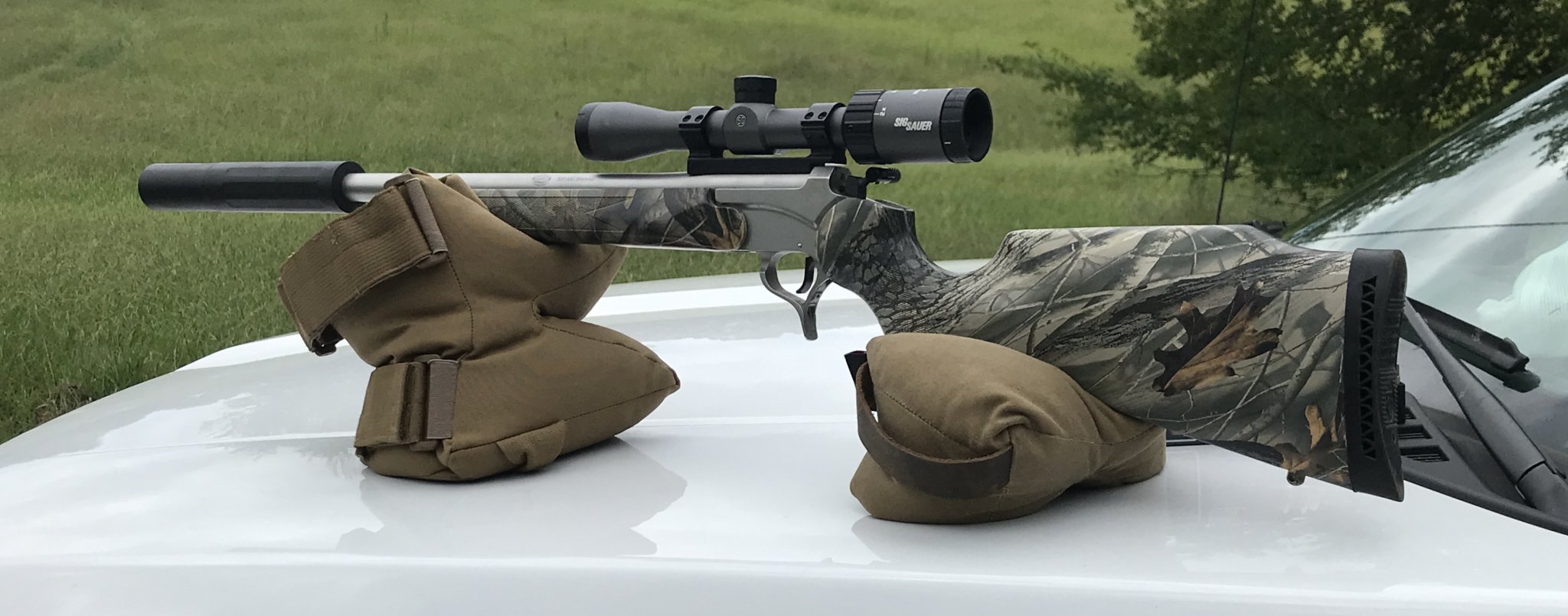

I bought a MGM 16" 300 blackout barrel for my encore and love shooting it. It's very compact, even with the suppressor, and very quiet as well. I'm sure they would make you a barrel in most any caliber you wanted.
7117552
Reactions: gnochi
