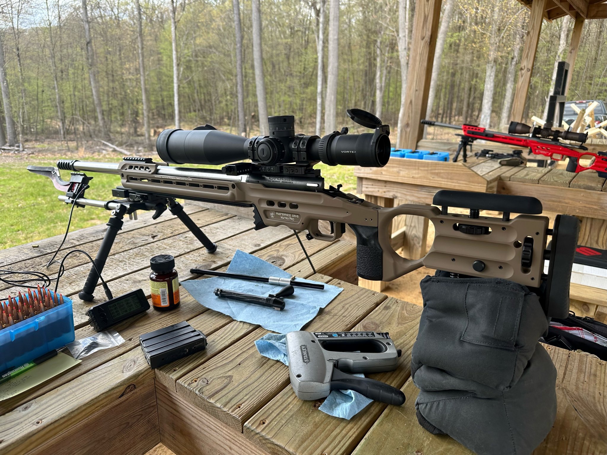

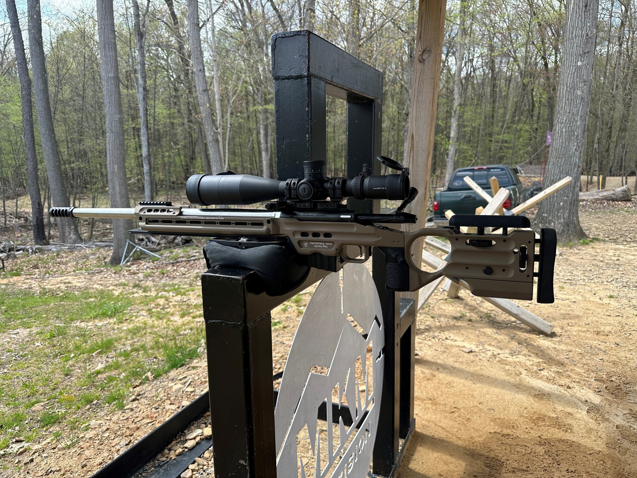

Latest Origin build. This will serve as a backup PRS rifle in 6.5 creedmoor. The barrel is a Bartlein blank 5R Heavy Varmint 1:8 twist chambered by KI Precision. So far I'm super happy with a random load I picked to get some rounds down the barrel before load development starts.

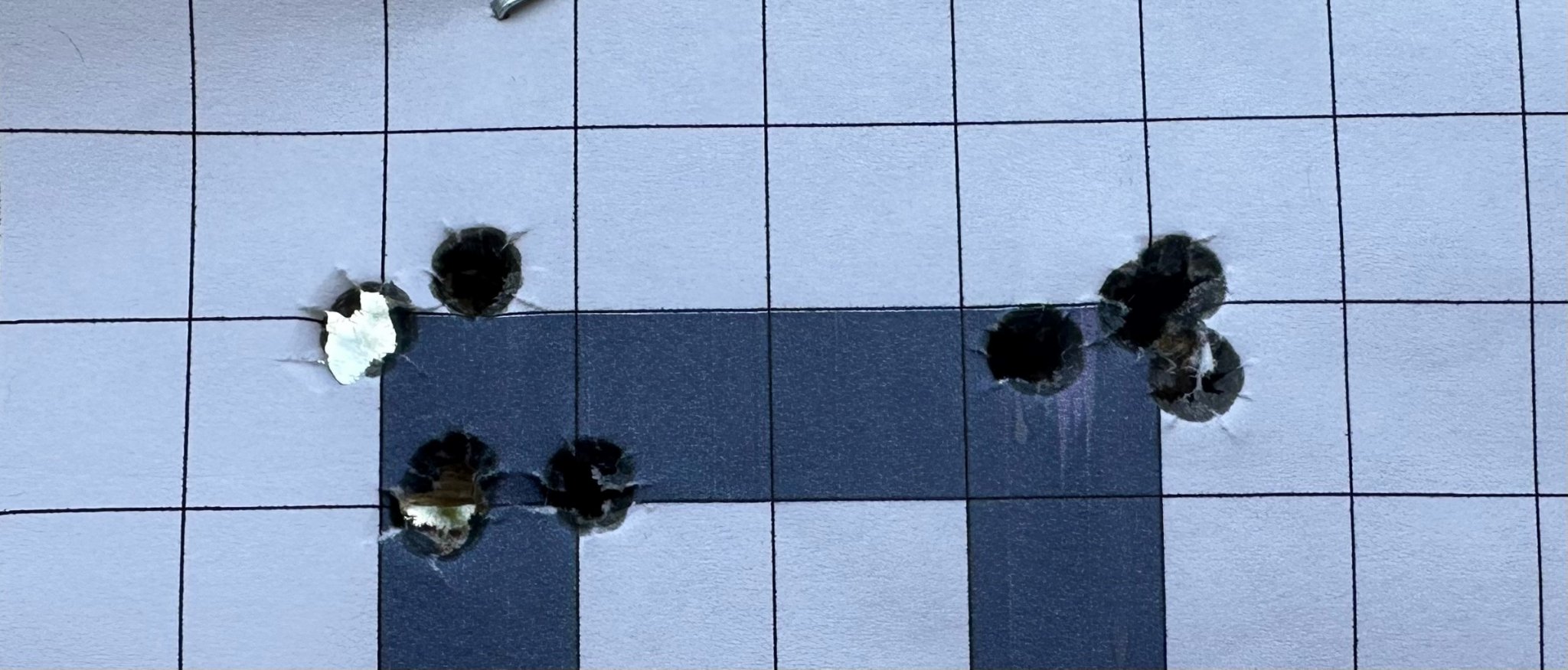

I did a quick barrel break in with 5 rounds to get the scope dialed in and then shot two 5-shot groups. The left one was the first and the right one was the first. This was a random load with an old box of Hornady 140 AMAX bullets I had laying around. It's looking pretty good so far. Shout out to Kurt Ives at KI Precision!

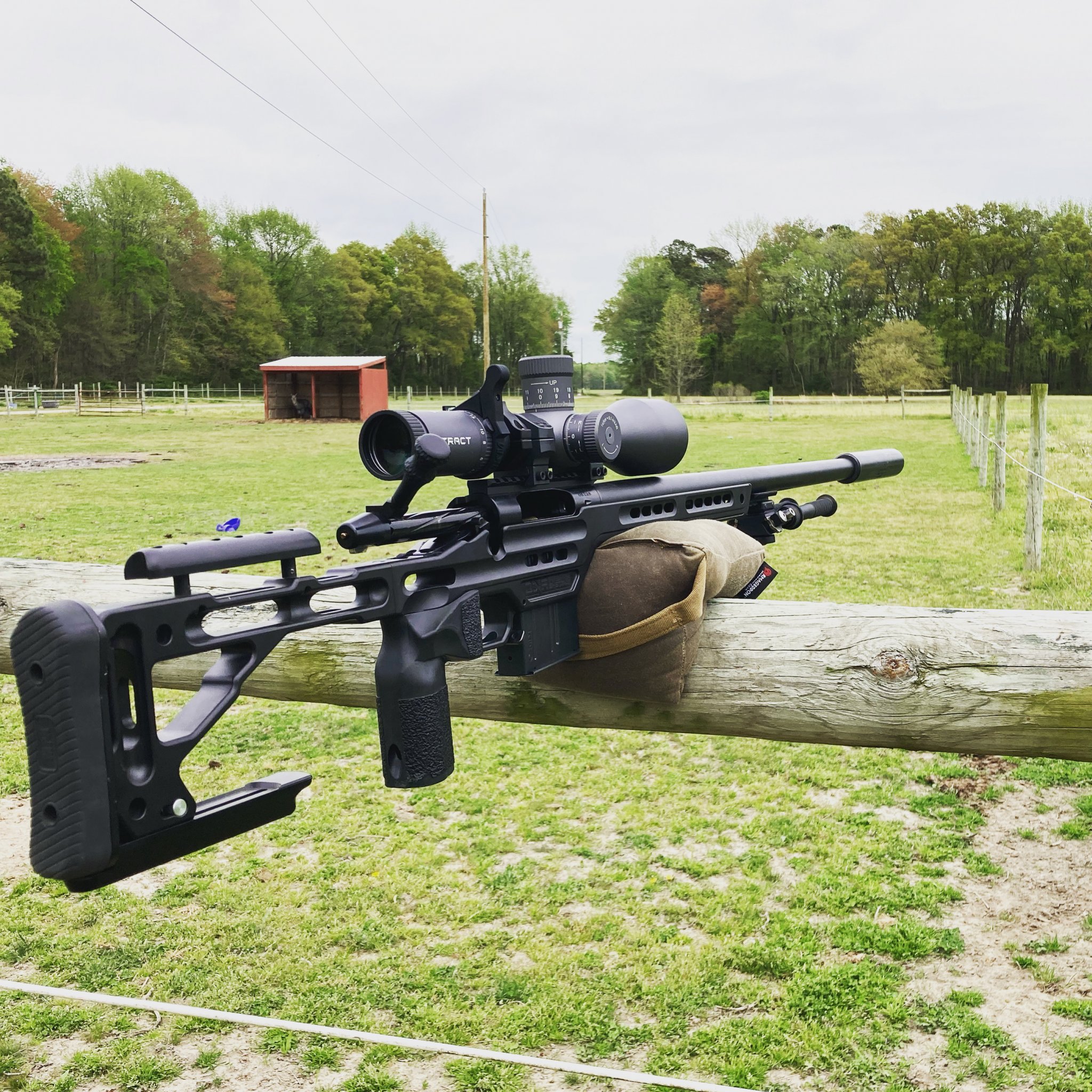

Here's my "budget" 6.5prc.
Budget in the sense that everything was bought on sale.
BHO short
Pva nut bbl. 26in, M24 contour
KRG Whiskey
MPA 34mm 1pc mount
Athlon Cronus btr 4.5-29x56
Timney single stage.
