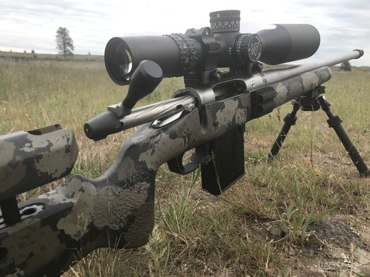

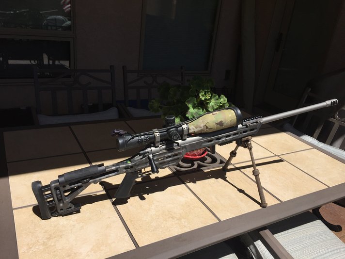

My TL-3 build is finally finished. Planning to head to the range over the weekend.
6.5x47L built by PVA
Bighorn TL-3 SA
Surgeon DBM
Hawk Hill Marksmen Barrel
Manners T4-A Carbon Elite Stock (M/C by CGC)
Timney CE
SB PMII 5-25x56
Spuhr Mount
AW Mags
Barreled action coated FDE Cerakote

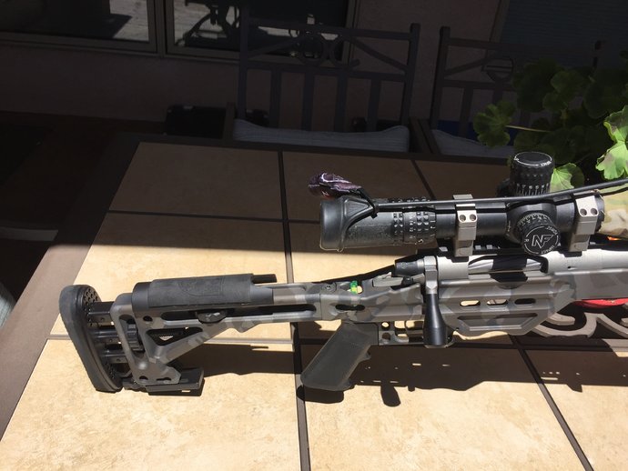

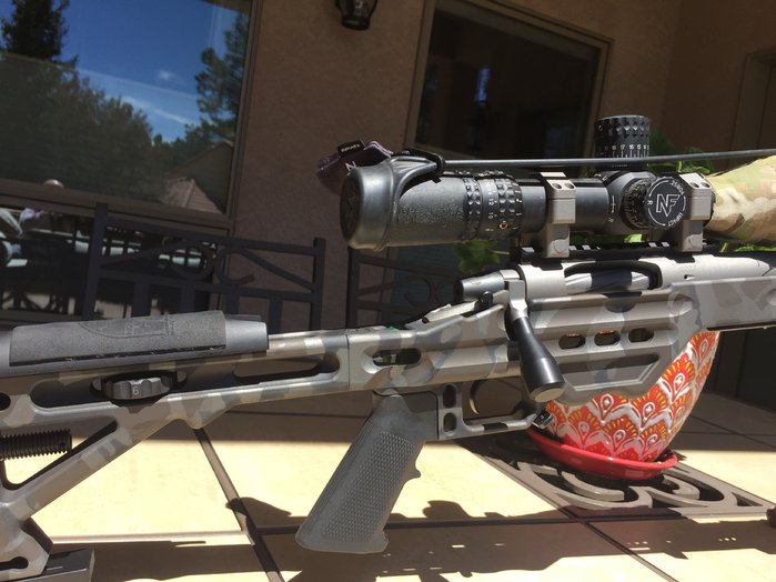

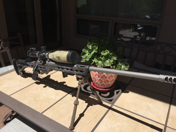

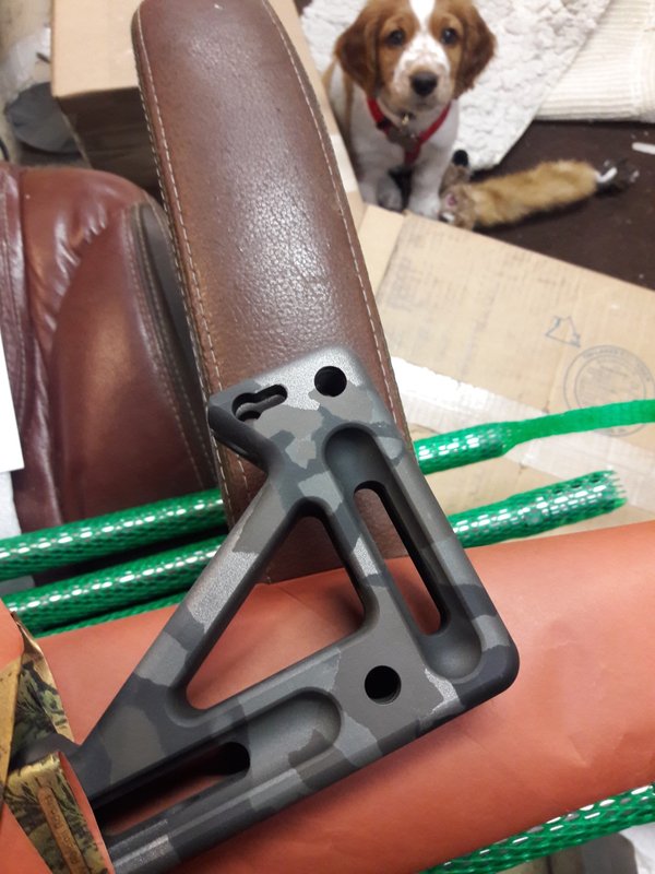

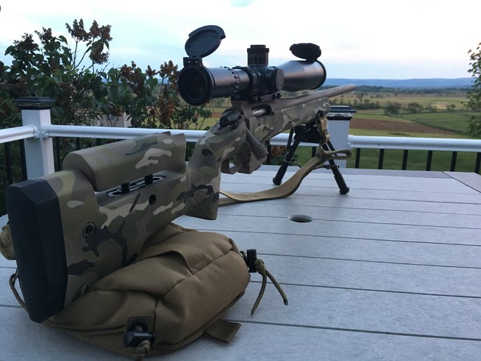

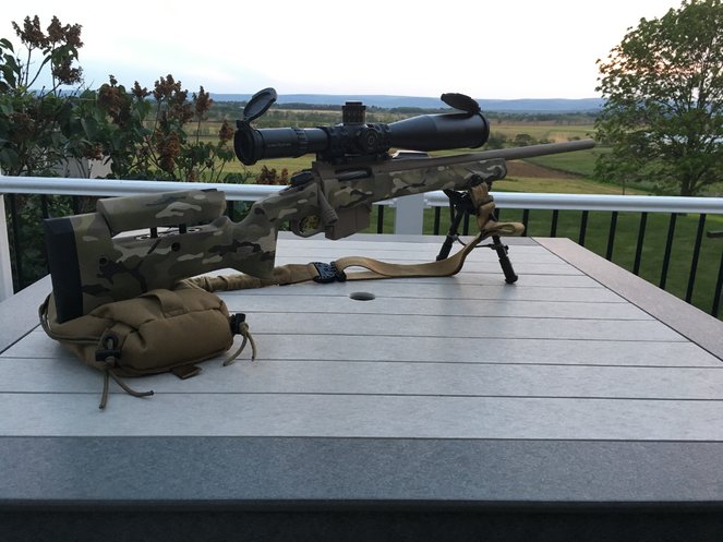

PVA Minuteman build from Josh. His painter, Zach, did a great job on the chassis. He calls it "Ghost" camouflage. 6.5 Creed, with 26" bbl and Mad Scientist brake. Placeholder optic until the new glass arrives.
Photos taken on a crappy iPhone by my dad, as I'm overseas. Once I'm back, and the new glass is on the rifle, I will shoot some better images.
