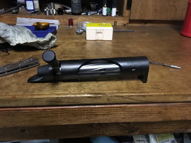

This was posted in another thread, but I don't wanna hijack it further. Anyone else notice the NP3 or whatever, flaking from off their bolt heads? I have 631 rounds on mine, with probably 3x that in dry-fire cycles.
This photo was taken after maybe 200 rounds, so it's gotten a lot worse. Purely cosmetic and not to worry, or should I figure out why?
I am talking to a local GS about Nitride, but he is uncertain about Bighorn bolt heads due to the low mass and heat involved. Would welcome feedback from others who've experienced either, thanks!

There were a bunch of bolt heads that had the NP3 flake off, Bighorn is replacing them all. My rifle build got delayed a bit because my gunsmith preemptively fixed the issue with Bighorn before my gun shipped out. My understanding is that the NP3 coating is there for reduced friction and better/faster bolt cycling. I do know that my DLC action with NP3 bolt is slicker than snot.
As I posted in the other thread Bighorn had an issue with an NP3 applicator and has since switched applicators. Improper prep work caused the NP3 to flake off on the original bolt heads. They posted an entire thread about it and have been swapping out bolts for many months now. It halted the TL3 shipping till they replaced all the bad bolts and got new stock for all the actions sitting to be shipped. I talked to Aaron directly and it has zero impact on function. Just call or email them and they will get you squared away.

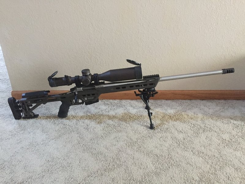

Here's my TL3 in a MPA chassis. Love the rifle, but I'm having issues running AW mags. Really kicked my butt at my first match I shot this past week. I can suck pretty good all on my own without the added help. Does anyone else have issues with the AW mags? Is there a fix or should I look at standard AICS mags? Intrigued by the new ARC mags coming out also.

I was experiencing very rough feeding where I almost had to pound the bolt to get the first couple of cartridges chambered. On other occasions once the cartridge was stripped from the mag, it seemed to slip under the bolt. The bolt then jams into the case pinning it against the feed ramp. This was after a fellow competitor adjusted the feed lips and spring tension. Do I need to continue to tweak these to find the sweet spot or just move on to one of the other magazines?
I've only bench tested mine with an AW mag before it had a barrel(it does have the AW cut) and it worked well. Speaking of that, yours does have the AW cutout right? I put a small bolt head on mine and chanbered it in a .223 based cartridge so i wont be using Aw mags for now. Have you been able to try other AW mags, or any other mags for that matter?
Yes, I have the AW cut. I didn't get a chance to try any other AW mags, but it does it with both of the AW's I have. I ended up borrowing an AICS mag from another shooter and the gun ran great after that. One of the shooters in my squad is a gunsmith and I asked him if there was a fix for the problems I was having and he said yes, use AICS mags. I think I'm going to try the new mags from ARC first.

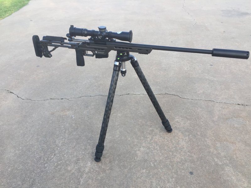

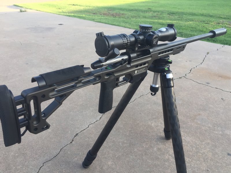

Put this together recently. I bought the bighorn with no actual need, just wanted to tinker and compare it with the tempest. The .20 cal krieger i'd been waiting for showed up, so with a prairie dog trip around the corner, I chambered it in .20 practical and put a MBM brake on it. I was prepared to hack the brake off if it wasn't worthwhile. Shot it both ways and the brake worked awesome, so I left it. The ATACR f1 isn't a varmint scope, but works great and wasn't being used.
Short TL3, AW mag cut (AICS polymer .223 mags for this application)
Krieger #5, 19" 10- twist barrel
Muzzle Brakes and More brake
Jewell trigger
MPA BA lite chassis
Nightforce 4-16 F1
These are some of the test loads. Three shot groups.
I had single pointed the crown initially, but my sub-caliber piloted center drill showed up a week or so later so I put the barrel back in the lathe and re-cut the crown. I did a full cleaning on the bore and reinstalled it on the action. I dont have the proper driver to torque the action screws, and the stock isn't bedded, so i just tightened them by feel like I had the first time. I wasn't expecting much of a zero change, but It went exactly back to zero and shot small from the clean bore, then tightened some more. These are the targets below. Identical loads with two different jumps. .010 off had previously showed smallest velocity spreads, and .040 best accuracy. Based on the below test, doesn't appear to care one way or the other. Total laser beam. Very happy with the package. Loving the TL3!

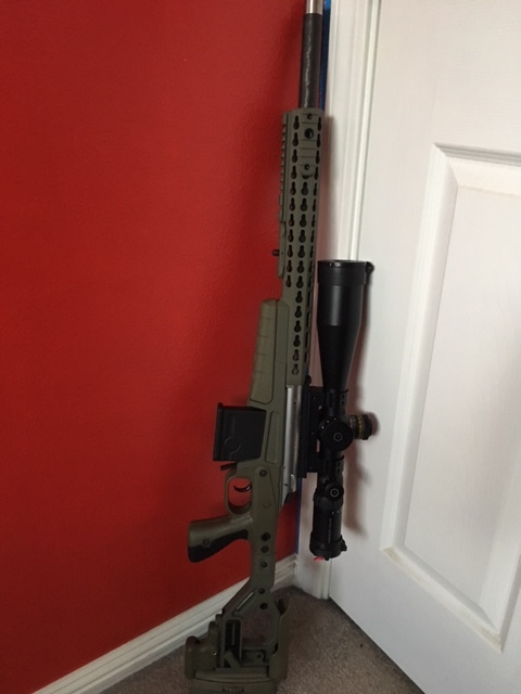

I wanted to build it for coyotes and small game hunting yet no recoil makes it perfect for my son to learn on with the tripod. Pic of groups below show fireform on left 7 shots. Then (2) 3 shot groups on right. Top one by the gunsmith jon beanland and bottom was by me. Crosswind from 10-15mph poor conditions for be ch shooting. No load development just 33 gr varget and 80.5 fullbore 20 thousand off the lands. Very happy with performance of the tl3
