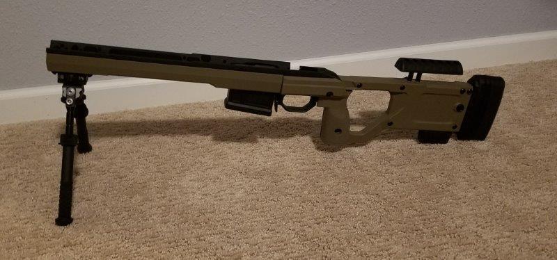

I got a chance to handle KRG recently and really like the vertical grip. For those that have handled both the MPA and the KRG, how does the MPA vertical grip compare? With the KRG I had a real nice placement of the trigger relative to the grip, just fit my hand.
You guys got the new bolts ? - i bought a spare bolt and Bighorn made a change, the male threaded part on the bolt is no longer there and its a female joint, and you buy a new knob with the male set screw - allows them to machine from a smaller dia. block of metal, and if you break it its now replaceable/serviceable (just replace the set screw). But your old knobs arent compatible. Love the new system however.
Ive had both, are you refering to MPAs "Enhanced Vertical Grip"? If so, they feel about the same, but the finger bump thingy on the MPA grip felt odd to me so i replaced it with an Ergo Deluxe. The MPA with Ergo Deluxe is SUPER COMFY to me, especially eith the thumb cutout in the MPA chassis. The KRG is good too, i like the thumb shelf and the finger placement is good but it felt too blocky for my taste
Thanks Sneaky, I've got a Sentinel Stock which I like a lot but still getting used to the grip. Had pretty good results with it today and as I use it more it should become more natural. Haven't owned an MPA or KRG but plan to, just a question of funding:)

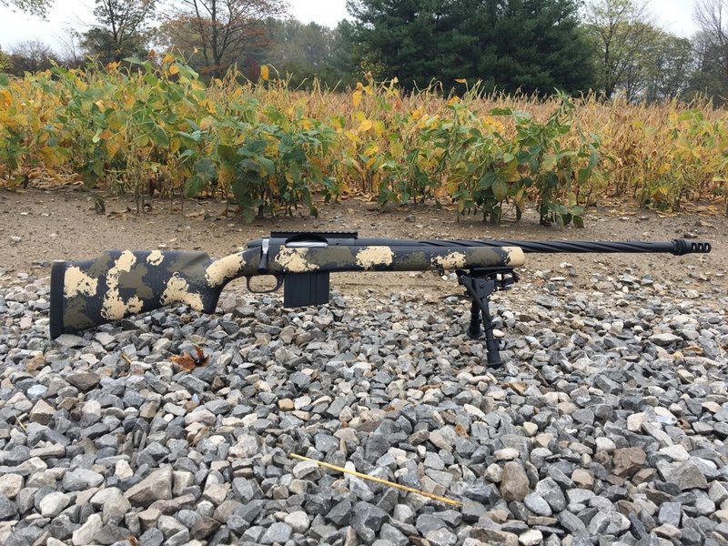

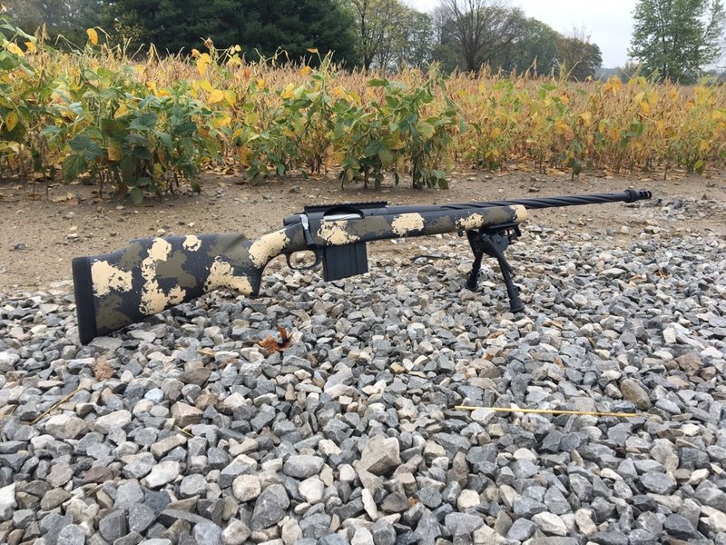

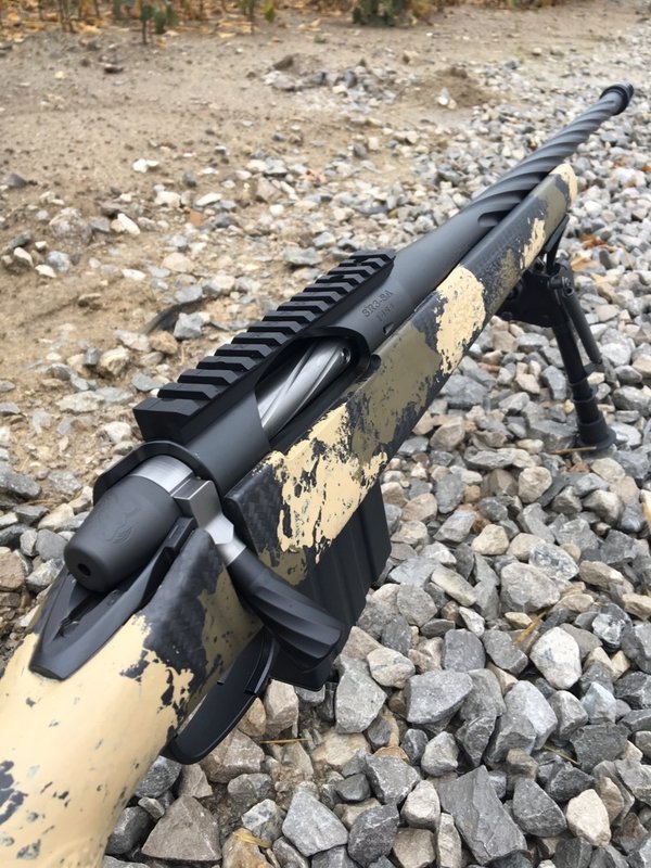

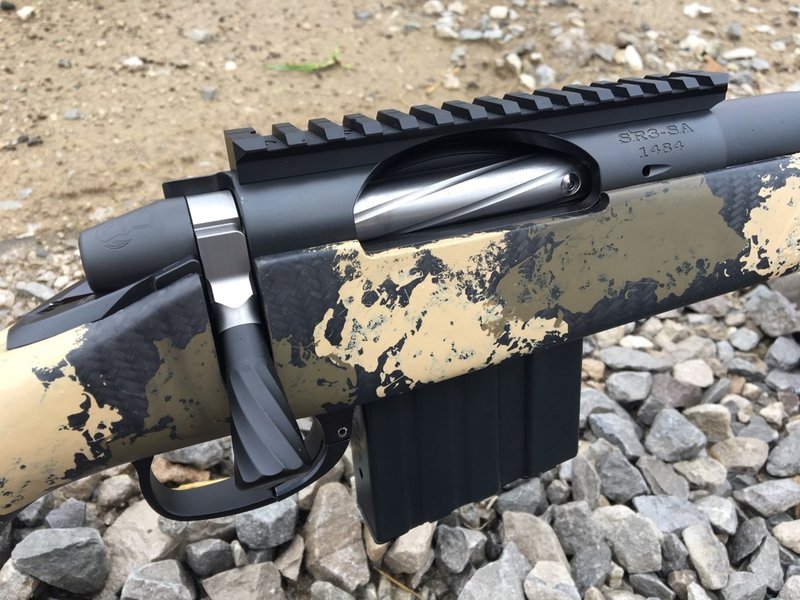

Got the email today from SAC Dad's 6.5 SAUM is ready and set to ship today or Monday. Man does it look amazing...:eek: I think this is the first or second SR3 build i've seen.
How is it feeding? You got the rem rails and feeding out a accurate mag? gorgeous man.
No idea, don't have it in hand yet. Those are pics SAC posted and sent me. Probably wont get opened till dad's birthday. Or i'll wrap it and go ahead and give it to him. His birthday is coming up in Nov. I've actually not loaded anything for it, haven't even gotten dies. Buying brass off a friend and need to get dies. I have everything else. I do have to put the Timney in it and put the LRHS on it. I have the modified brass from Copper Creek. I think it should be fine feeding wise here was my specs on his SR3

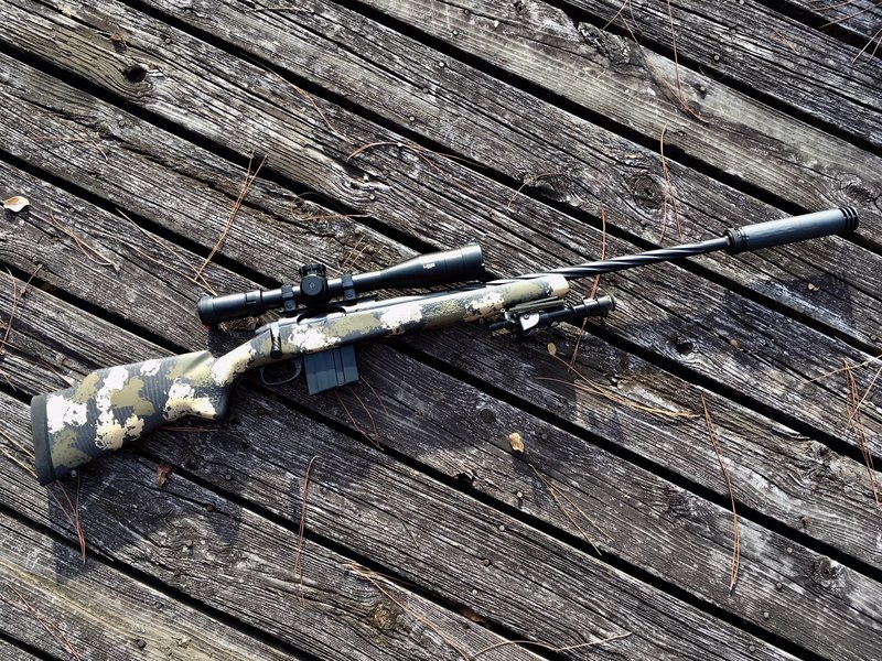

Update

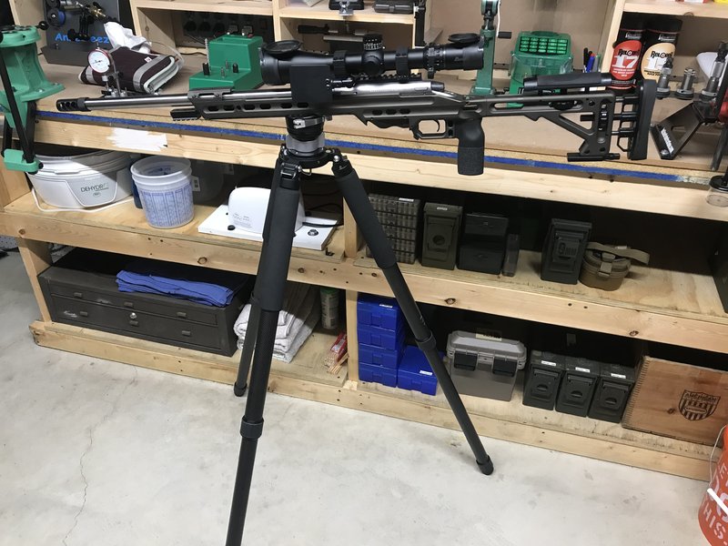

im loving my setup. The throw is even smoother than it was new, after ~400 times dryfiring for practice. Already looking into another caliber to complement the 6.5 creedmoor I currently run.

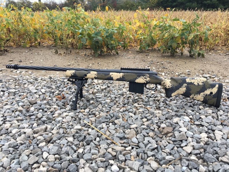

Right at 11lbs as seen. 9 without the bipod and can. I either lost the pins that came with it or SAC forgot to send them back so i've got to get a replacement pair from Bighorn if possible. Other than that i think it turned out wonderful Still wish i could've managed some more premium glass like an ATACR or TT315M. But the LRHS is no slouch for the money.
Real nice hunter
What caliber?
And you are right. A 4~16x42 would set nicely on that rifle.

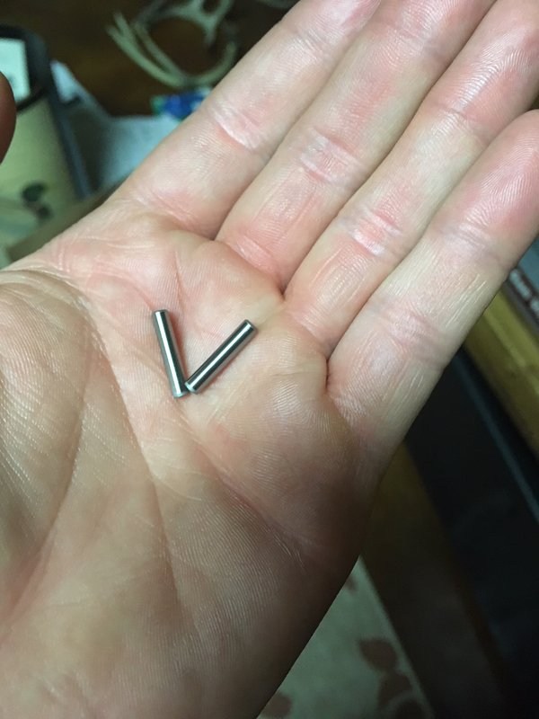

So i think i found the pins to the action. Either way i found some pins that worked. Camming the bolt down is smooth but stiffer than i'm used to on any action. Not that i have to overly force it, it's smooth just has some stiffness to it. So i figure the sear engagement on the Calvin Elite just needs adjusting. Figure i'd do what i did with my BnA which was backing the sear out until it wouldn't hold the firing pin and progressively re-adjusting it until it did so. Sear backed all the way out, like the screw is out of the trigger and no change in feeling.
Is this normal for bighorns? The pins i used where these, i don't honestly know that they are the ones that came with it but i assume they are, i can't remember where they came from.
Those look like the same trigger pins as mine. Closing the bolt has a smooth camming feel like you describe. I didn't mess with the Timney CE sear, just dialed the weight to where I wanted it and called it good. Break is nice and crisp.
I don't think messing with the sear is going to do what you want, that just determines how clean/mushy the trigger break is inside the trigger. I think what you're trying to get at is trigger timing which relates to the position of the trigger fore/aft compared to the bolt cocking ramp and closing cams, etc. The only way to affect that is moving the trigger forward or backward or to start grinding on stuff on the bolt. You'll also hear this topic referenced to as "cock on close".
If you want to know how much cock on close your bolt has, just measure the firing pin protrusion out the back of the shroud and compare the amount of protrusion from the bolt handle up position to the bolt handle down position. Use the tail end of a set of calipers.
My TL-3 and Timney CE has about 0.014" of cock on close on the firing pin. The pin protrudes about 0.034" when bolt handle is up and when I close the bolt it measures about 0.048" protrusion. So the closing cams on the bolt are pulling the bolt forward against the trigger sear, compressing the firing pin spring an additional 14 thou when I close the bolt. I've actually never measured it before or thought it to be an issue. Bolt runs good for me.
