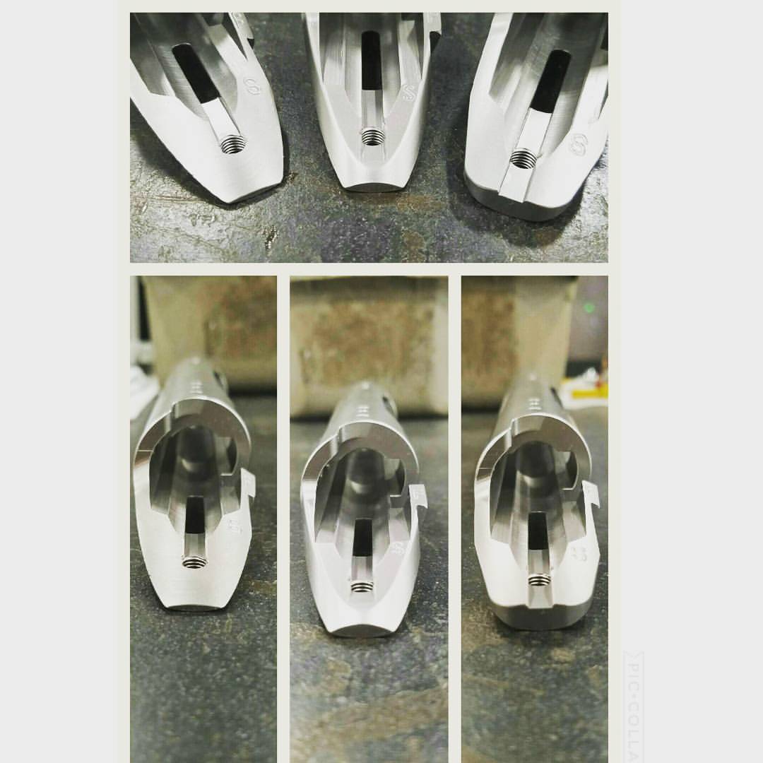

Here's a picture of all of them.

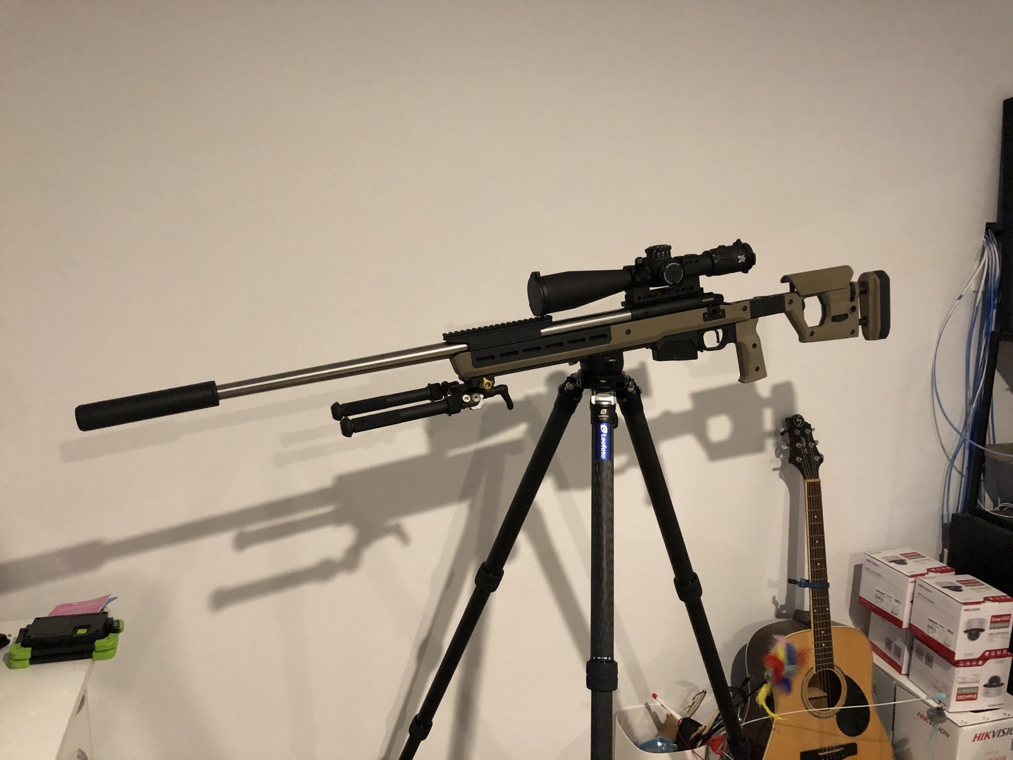

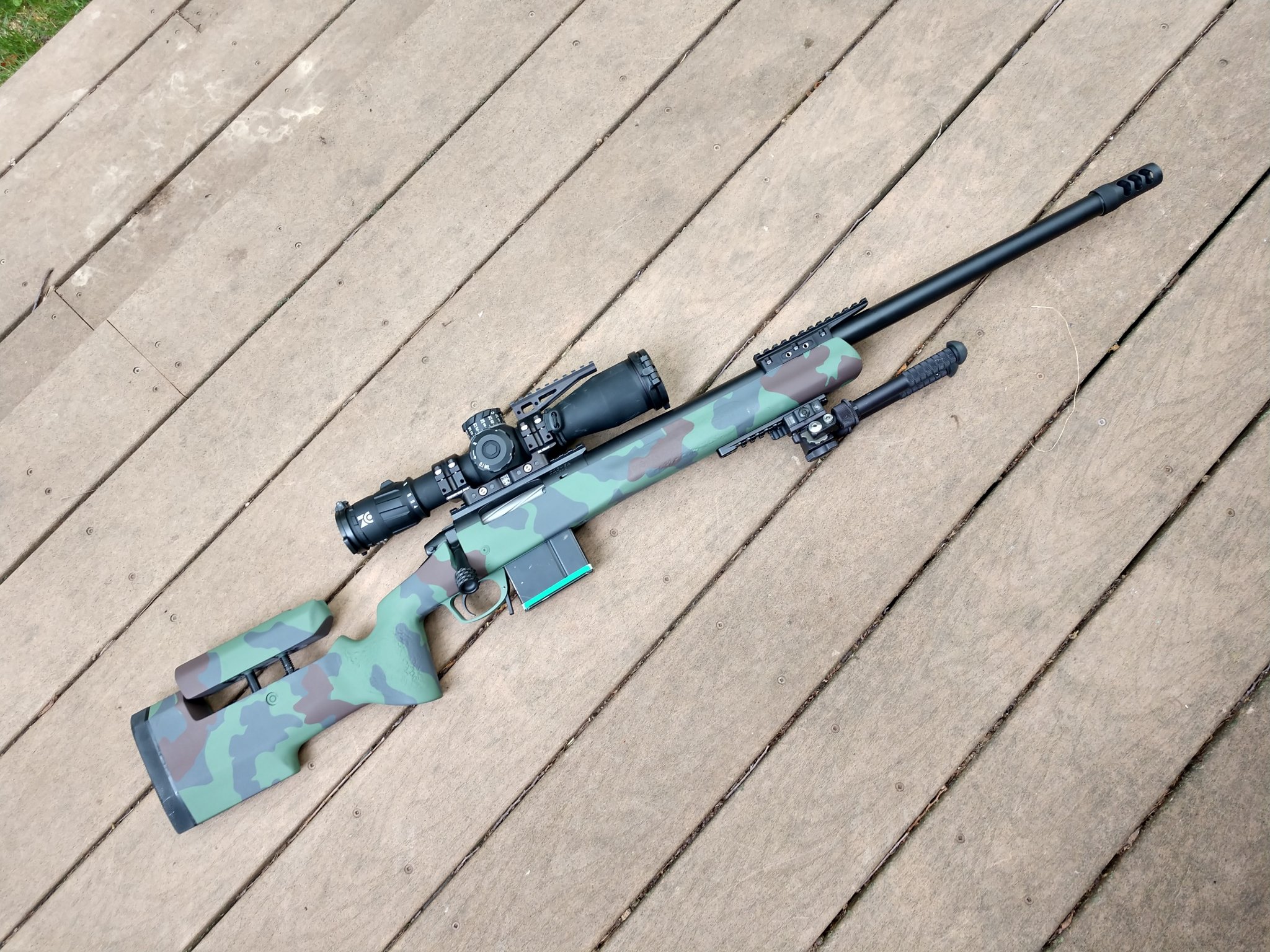

Finally got my TL3 together. Had a Xcaliber Savage 22-250 AI prefit with plenty of life left in it, so I sent it to LRI to cut to 22”, thread, and cerakote.
TL3 Short action
XCaliber 22” 1:8 22-250 AI
Manners PRS2 with mini chassis
Triggertech special flat blade
Turned out great!
Now I just need to find a time to hit the range!

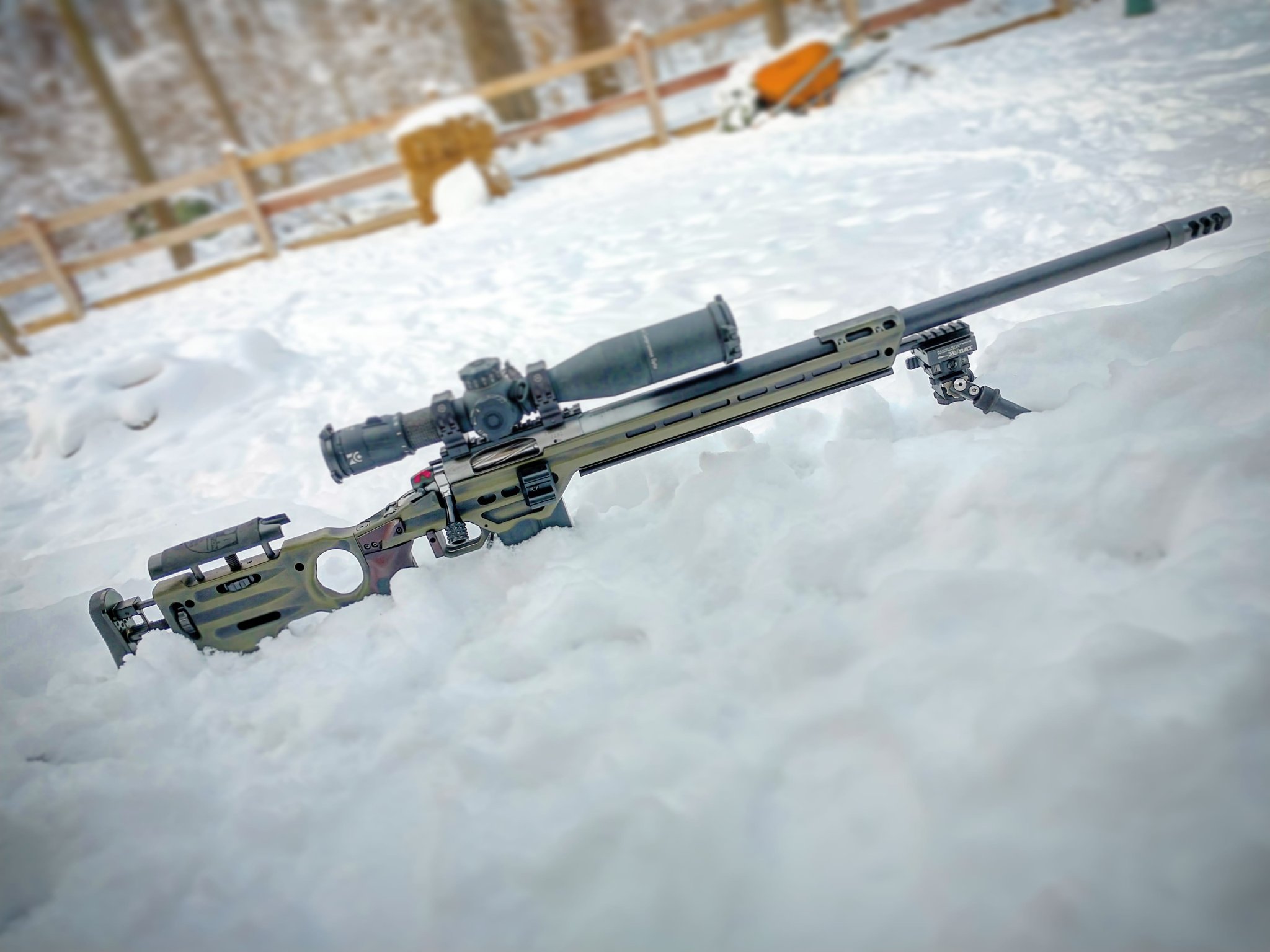

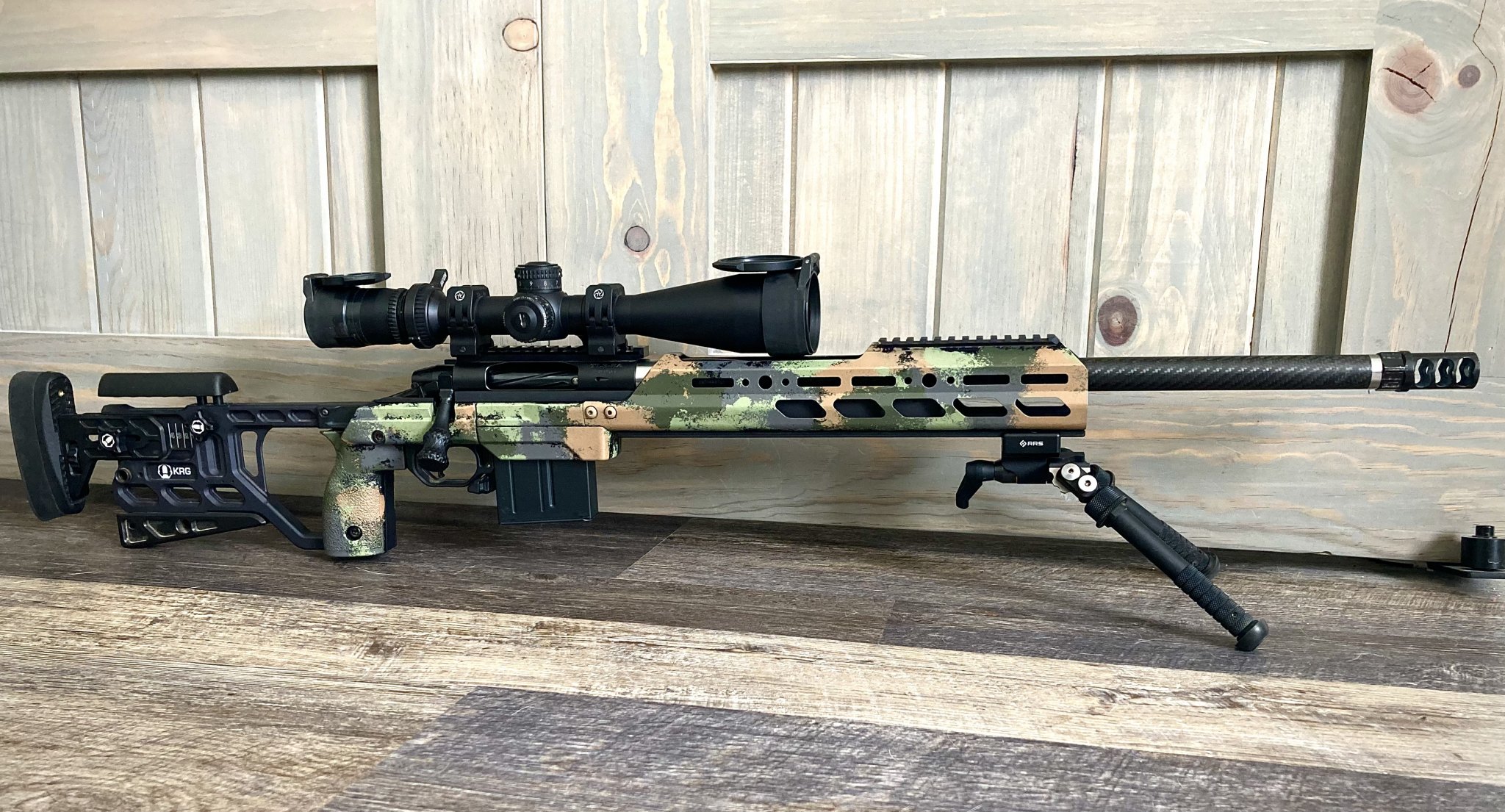

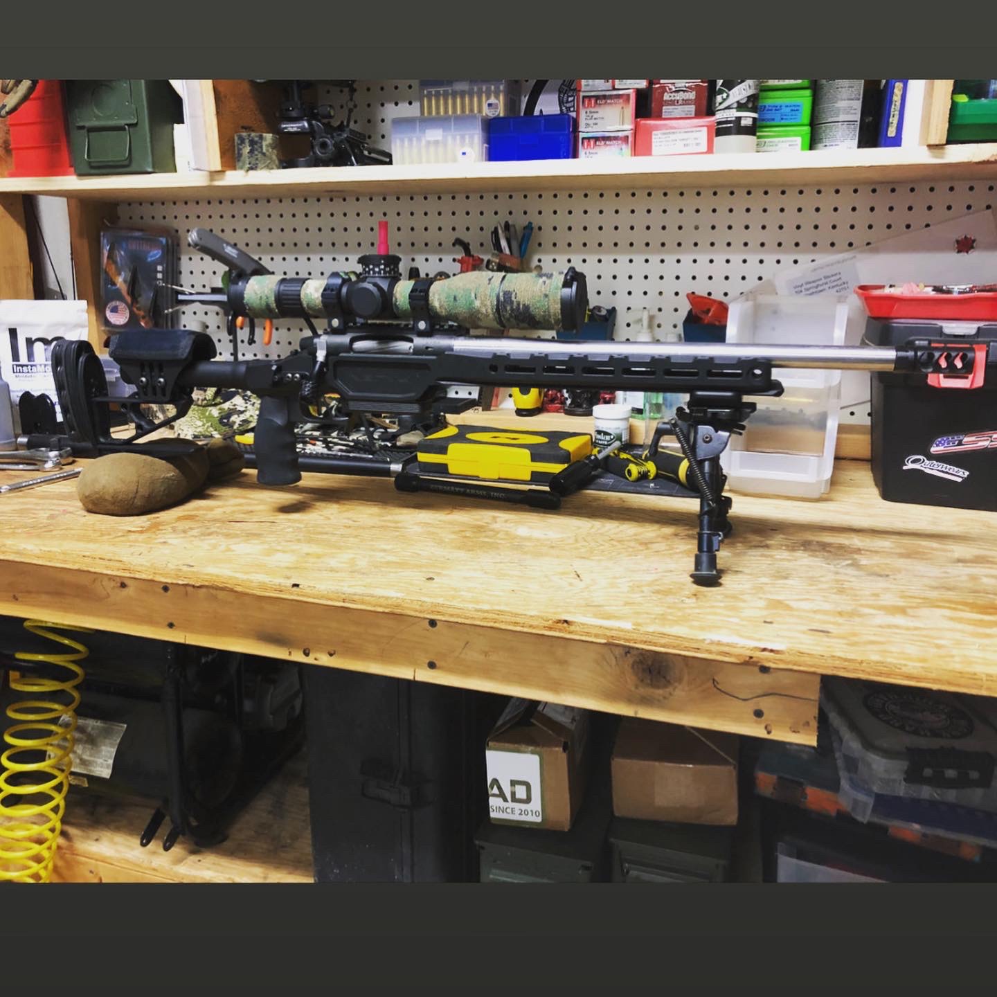

Ready for 2021. TL3, Proof 6-Dasher, ZCO 420x, MPA Matrix.
This is the same action I have in the very first post (#1) of this thread. It's undergone some changes in the last 4 years!
That looks awesome. Love the look of the two tone transition and the matrix chassis. Been debating on grabbing one. Have the whiskey 3, and the mpa comp and the matrix just draws me in

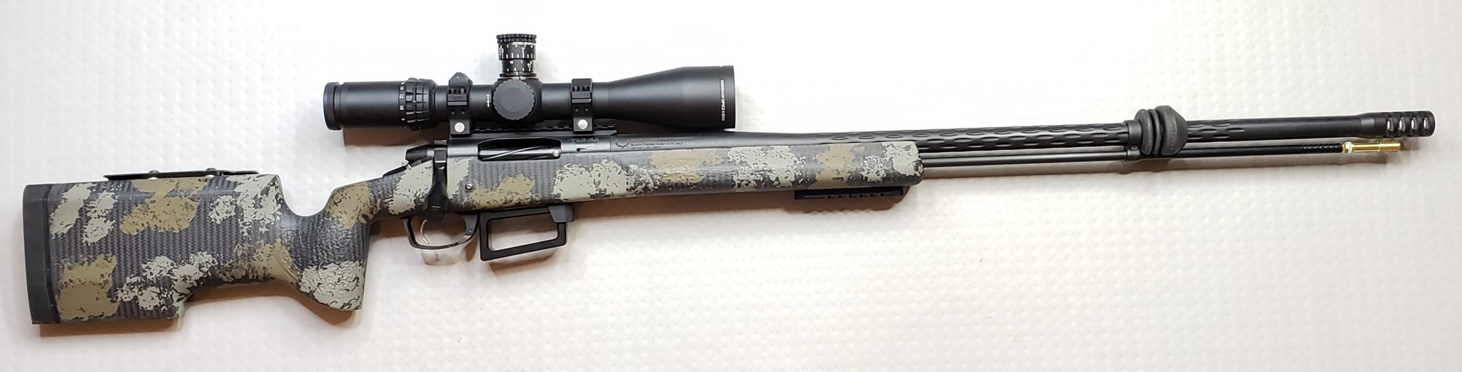

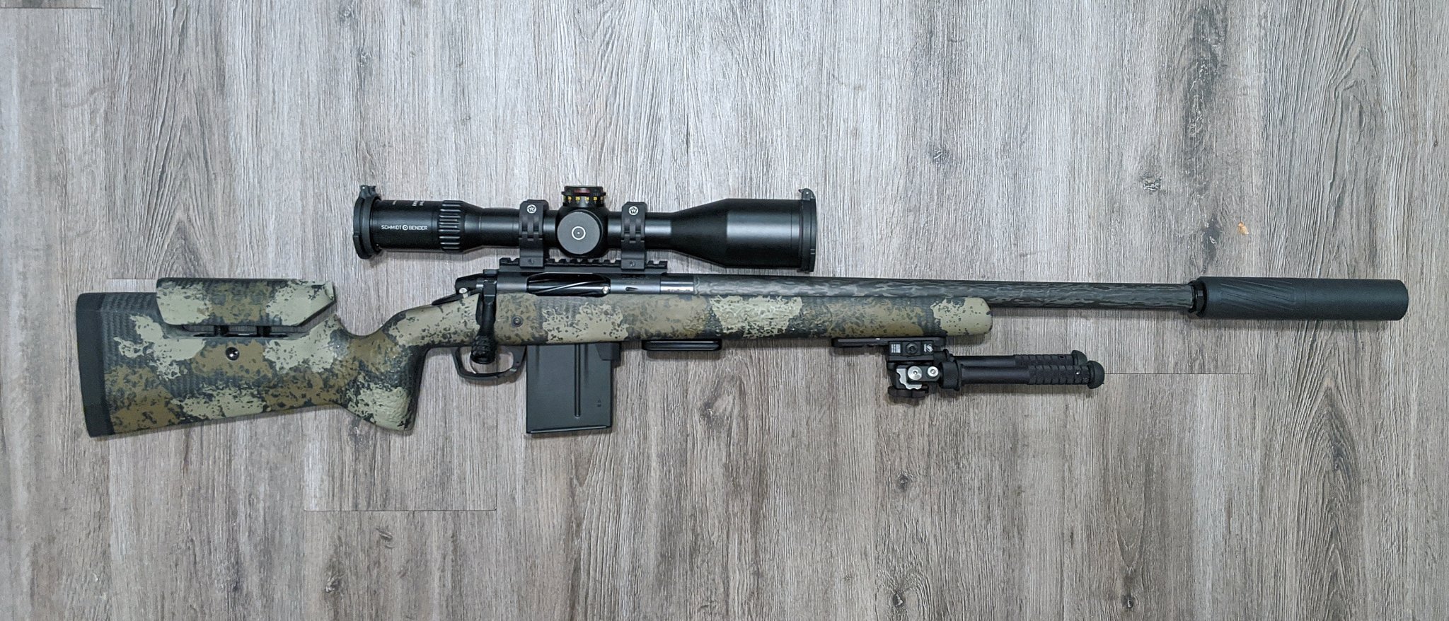

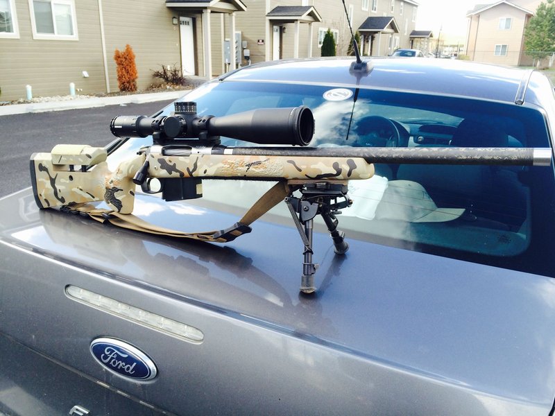

Finally got it all put together, just waiting on dies from Rich and ready to shoot! Built it as kind of a "Do All" hunting gun, short enough to easily maneuver in and out of blinds and vehicles with the can. I haven't weighed it yet, but probably in the 11lb range as it sits.
TL3
Manners EH1A
20" Paradigm Carbon 7ss
TT Special
Schmidt PM2 Ultra Bright 4-16x56 in ARC rings
TBAC Ultra 7
How do you like that suppressor?

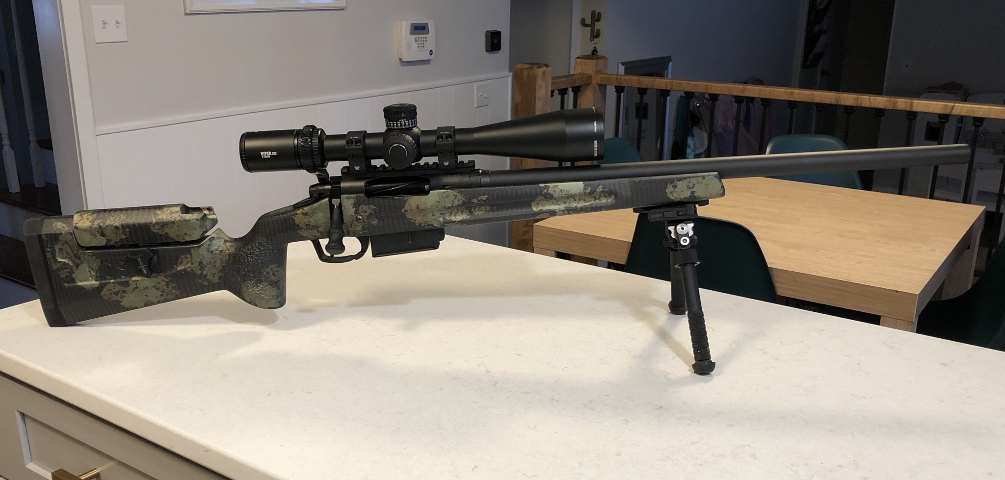

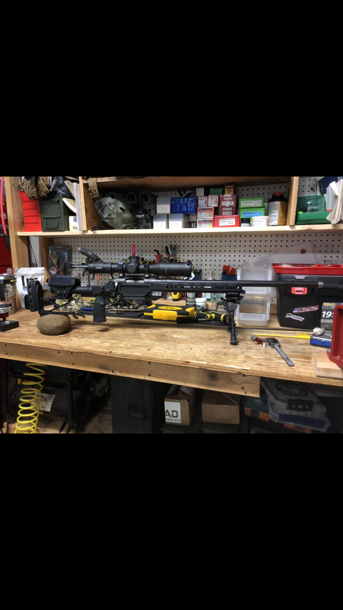

This is the evolution of my TL3. Here it sits with a 22” Hardy carbon barrel chambered in 7saum. The action is finally doing double duty with different calibers and swapping bolt heads as I originally intended. And that’s quite satisfying.View attachment 7573825
That looks great!! Do you have to remove the enclosed forend when you swap barrels and calibers?
It’d be even faster w/out the arca rail, but since you already have to completely tear everything down, remount everything, then re-zero, it’s really not a big deal in the grand scheme of things.
Yeah very true. I can swap between my two barrels in about a minute maybe I think right now. Just unscrew one and screw on the other. I know the barrel shank won’t fit under the NV bridge but there’s also not much clearance under the enclosed forend to be able to range swap barrels either. That’s why I was checking with your setup.
Reactions: reubenski
Do you do range swaps with a TL3?
Interesting, how much torque do you set them to/are able to get without a vise and action wrench?
Roughly 30-35 lbs of torque. Been shooting couple barrels with only this much torque since I got my TL3. Even when using barrel vise and action wrench. Followed suit and copied up what @reubenski has done / is doing with his TL3 and running it like a switch barrel rifle with shouldered prefits.
Well, that might be worth try instead of my typical 80 lbs

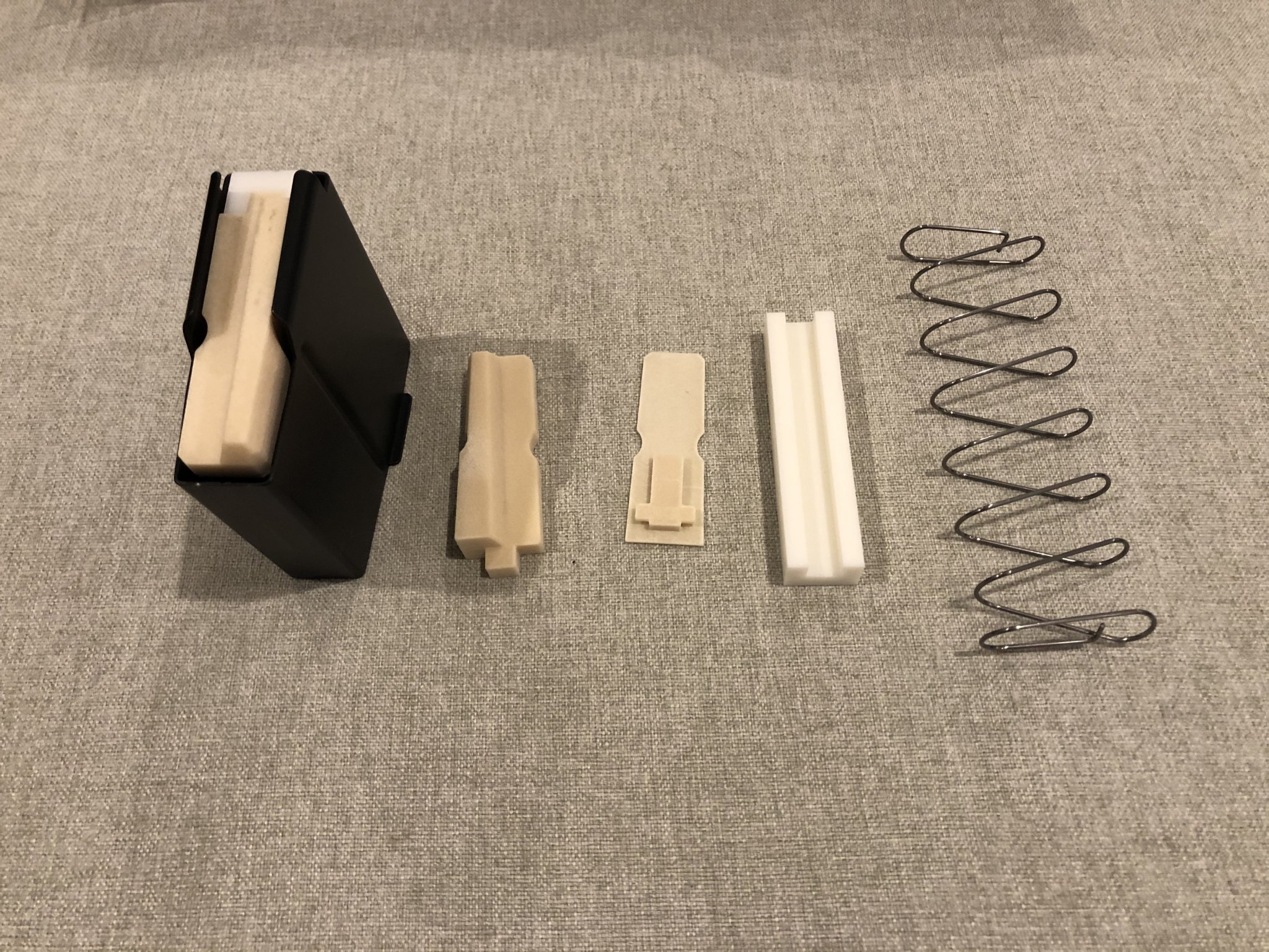

How do TL3 do running aw mags?
AW mags are all I've ever used, but I've never had a fail to feed. However, my rifle doesn't function 100% as a control round feed, and I suspect it has to do with the magazines. The bolt doesn't grab control of the round until the cartridge is about 50% in the chamber. There is a period of time when the round has left the magazine, but hasn't been grabbed by the bolt.
Not sure if it's mag related because I've never tried to use anything else.
